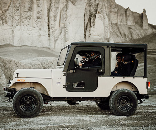

On second thought I would probably leave all intact for the summer and just roll up the sides and rear and just swap out the doors. Does this make sense?
Mpm
Aug 22, 2020
26
Camas, WA, USA
Yes, makes complete sense. The full top is great in the summer. The sides don’t roll up, they are removed. The back panel either rolls up or is removed. Removal preferred. Doors remove easily as well. I don’t have a photo of mine this way but here’s one that shows it with the doors still on. It’s much better with the doors off.

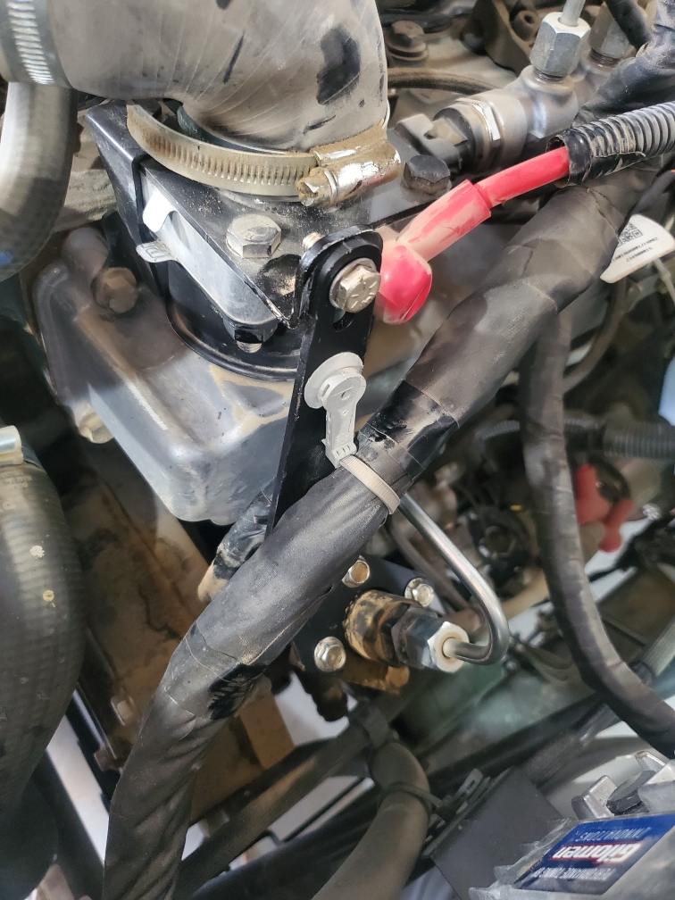

I went with Gilomen stage 2. Only 300 for same upgrade. Couldn't see spending 600 for what I can get for cheaper
CJ2Rox, did you upgrade the intake with the Gilomen or left it stock. That is a big difference in price between Gilomen and diesel freak.
822
I just bought the hold down bracket. Gillomen just offers the computer upgrade

I didn't realize there was an upgraded hold down bracket. Thought it was factory. I will look into that. Thanks!
822
Very affordable option
