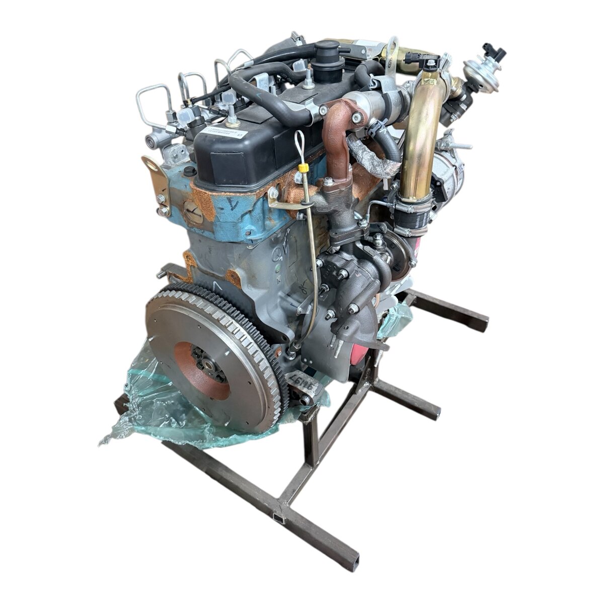

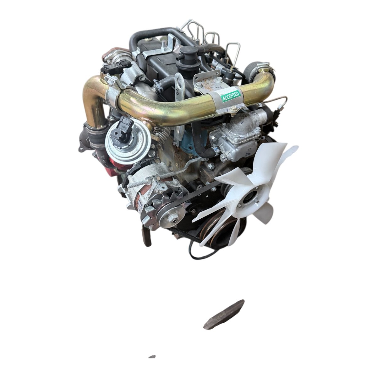

In case you need to go the full route, Mahindra has the engine assembly Part # 0301BAB02590N for $11,447.50.

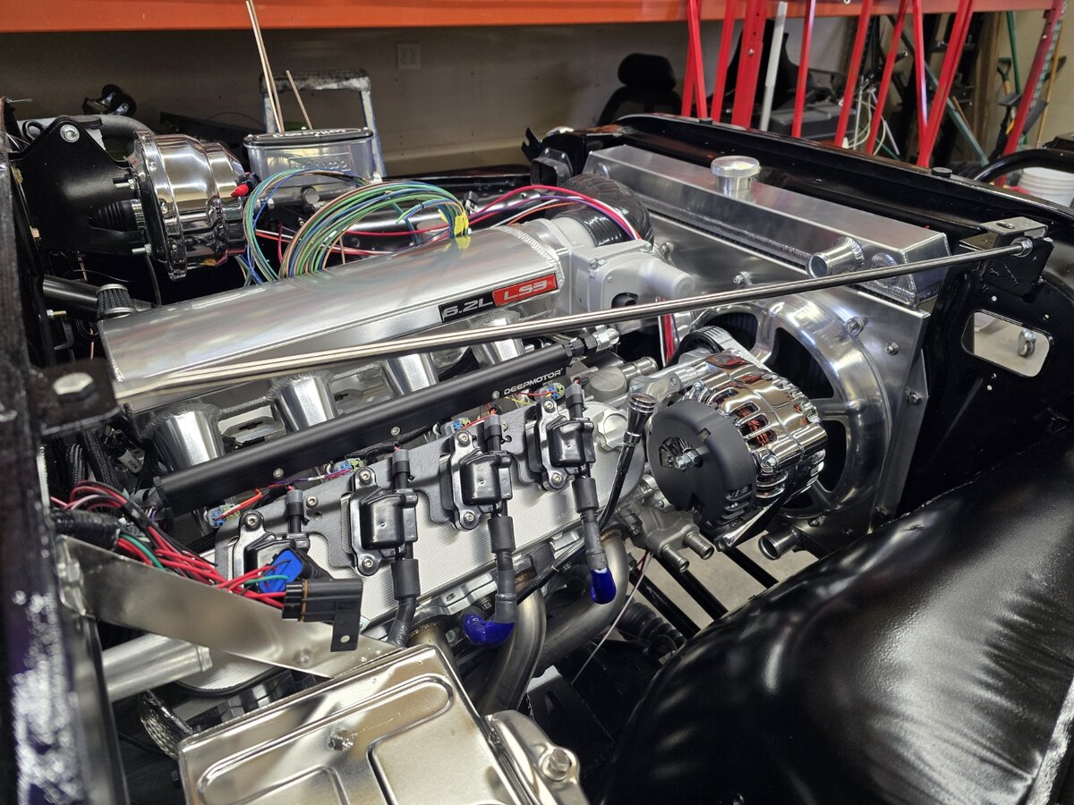

If anybody wants to swap their motor out for an LS, I'll give em the LS for it lol. I definitely want one of these on the stand to play with VE swapping.

LOL! I know it's a tough swap, but I wanted to do this so bad on my roxor when I had it..... This is actually a CJ-7 I'm building currently, so this is NOT in a Roxor.

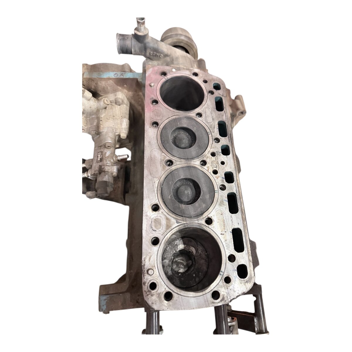

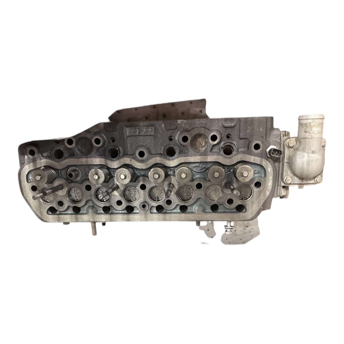

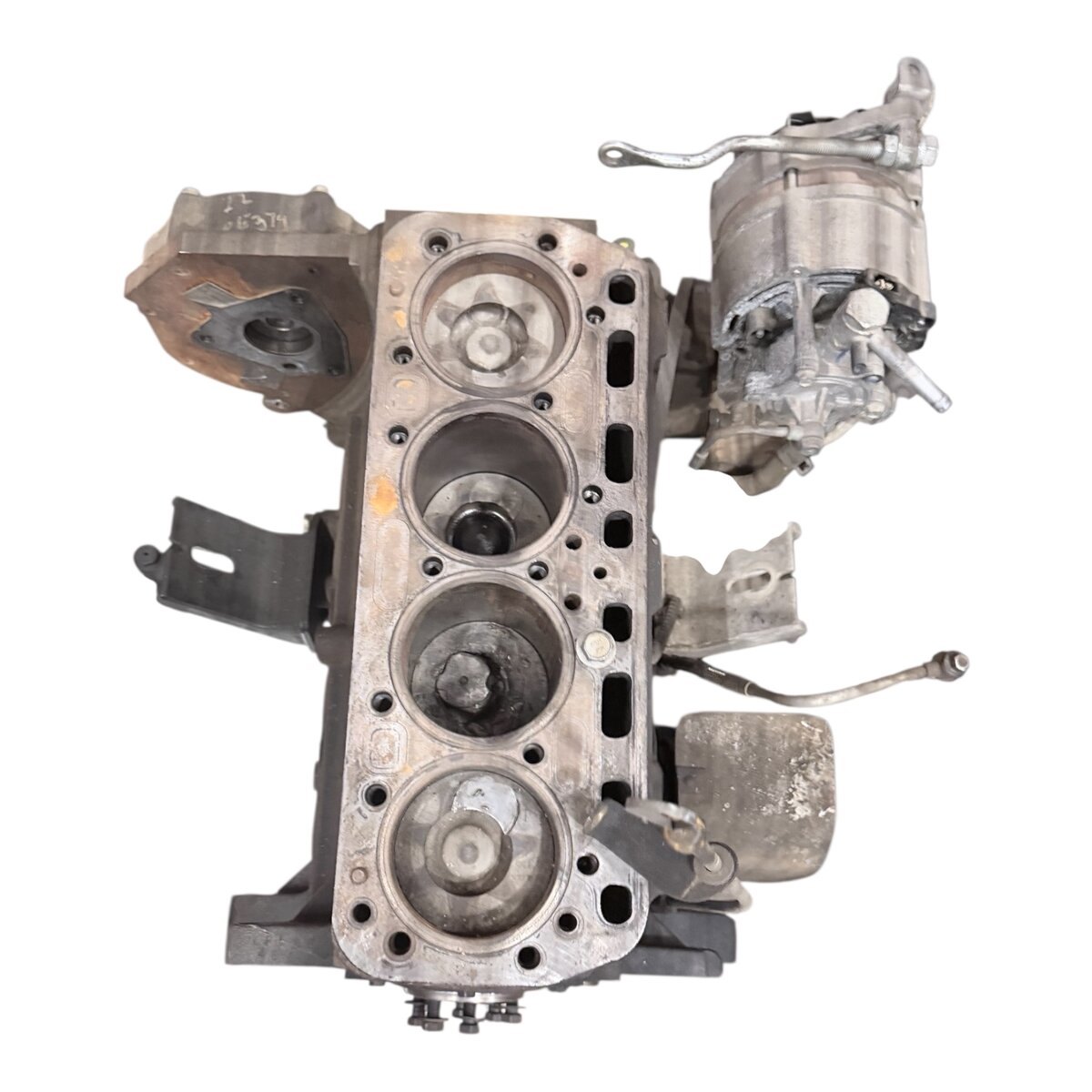

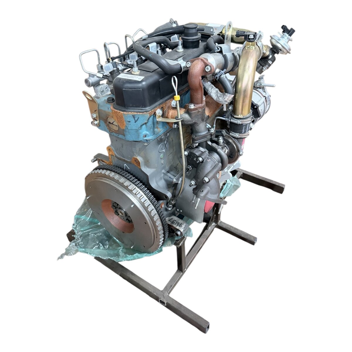

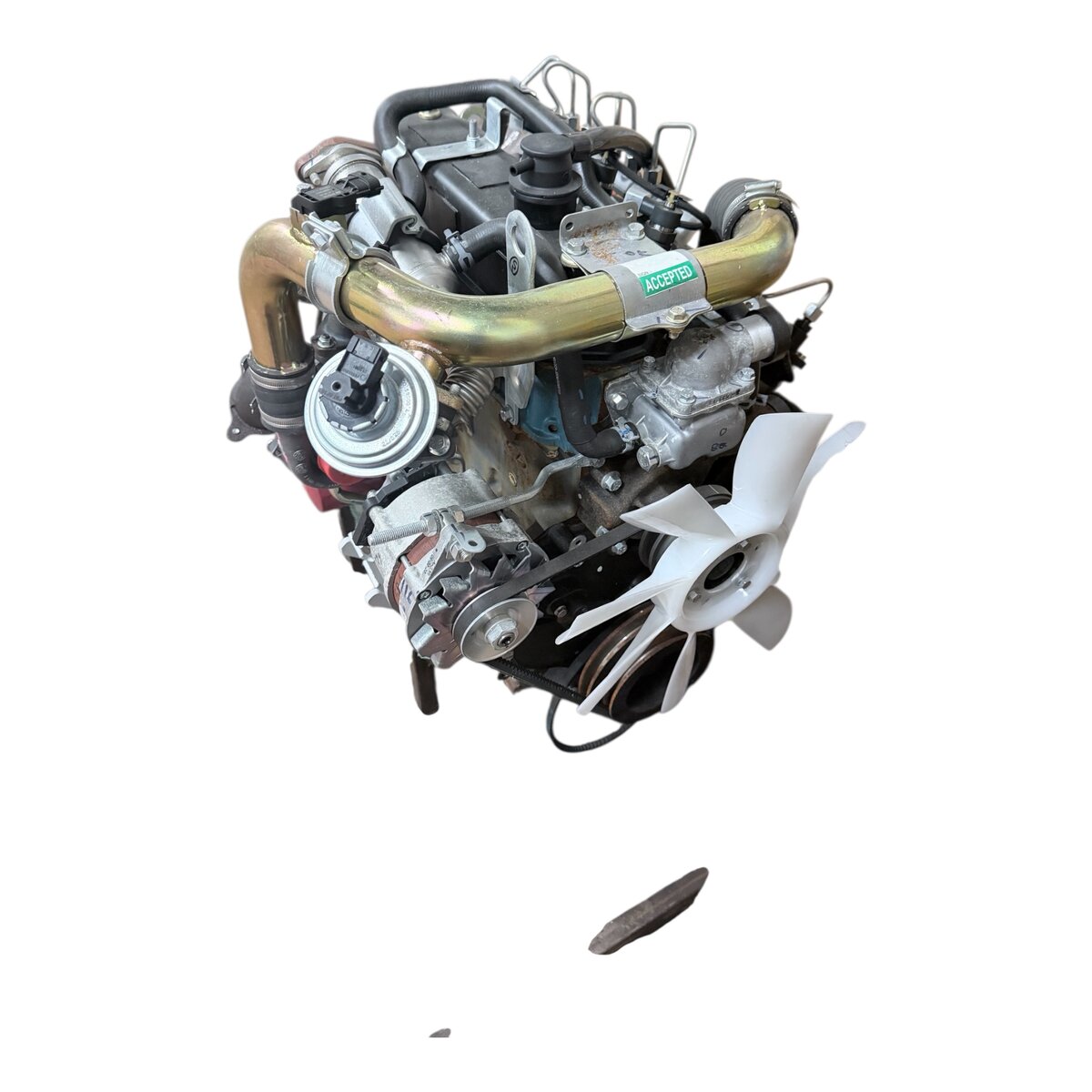

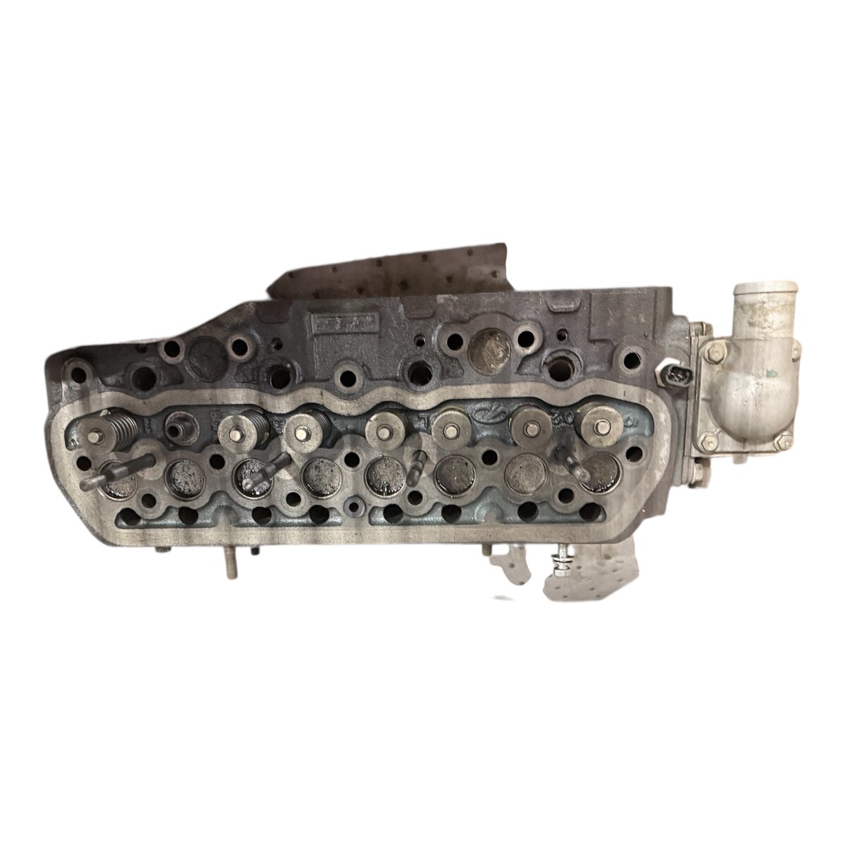

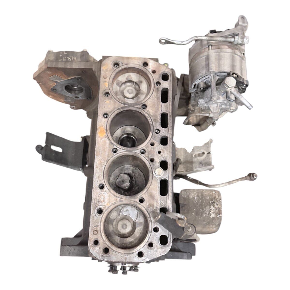

Well we haven't released anything yet but we have torn down 4 engines and are making a few builds. One thing we have had done was balancing the crankshafts, We were surprised how far out of balance they were. We are currently balancing the rods and pistons. We have also started on cylinder head work, we have found several area's there that will get some improvements. We will probably have more on these engines by the first part of next year. In the mean time we have 4 brand new 2.5 liter and 1 new 2.7 liter crate engines in stock. We are putting a small core charge on them so we get blown up engines back so we can build some of these performance builds. Hope this information helps.

Would the crankshafts being out of balance cause some weird resonance in the cab at certain RPMS? I've been chasing some odd vibration around like, 1400-1800 roughly since it was new. Checked all the mounts, all seems good.
You talkin Custom exhaust manifold that can actually breathe, with compound turbo's, fire ringed and head studs custom engines?
Lol, You think like we do. We already have the stud kits, We have been looking at manifold and don't really see much restriction there, we are thinking of doing an add a turbo kit just to see what the gains would be.
It definitely could. Vibrations can be hard to track down. We spend hours on the dyno trying to find them, most of the time it ends up being tires or clutch causing them, But it can be a number of things.
