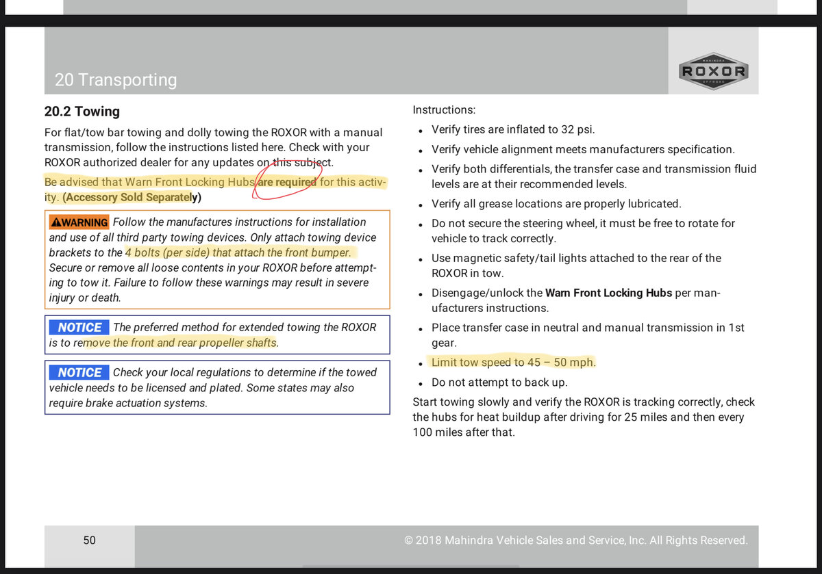

I saw somewhere on here that Mahindra said with warn hubs you can tow 55mph for unlimited distances. Am I correct with this? Has anyone heard any different from Mahindra? It looks like I'm gonna have to flat tow mine everywhere I work if I wanna enjoy the damn thing.

You’ll lose your mind if you try to think about it too much. None of it makes sense mechanically so it’s best just to ignore it. The few of us on here who do flat tow can’t figure it out so we just tow away without thinking about it.
I flat tow a 2014 Honda CRV as well and I can almost swear the Rotor is in gear based on the difference in towing the Honda The Honda pulls so much easier and better and it weights more, if I'm not mistaken. Oh, well, I would love to know the why. Maybe it Mahindra is bugged enough they will relook at this topic.
