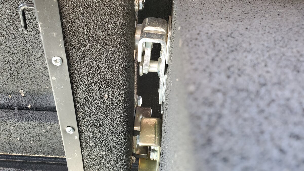

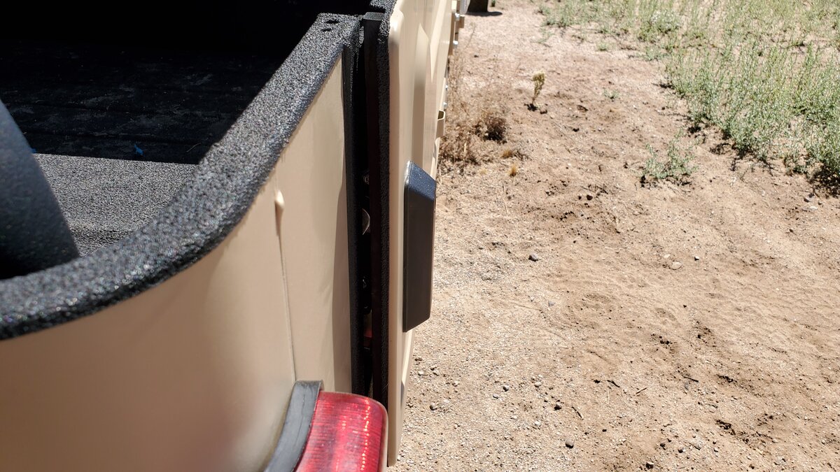

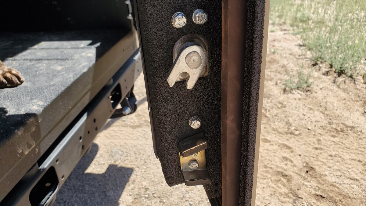

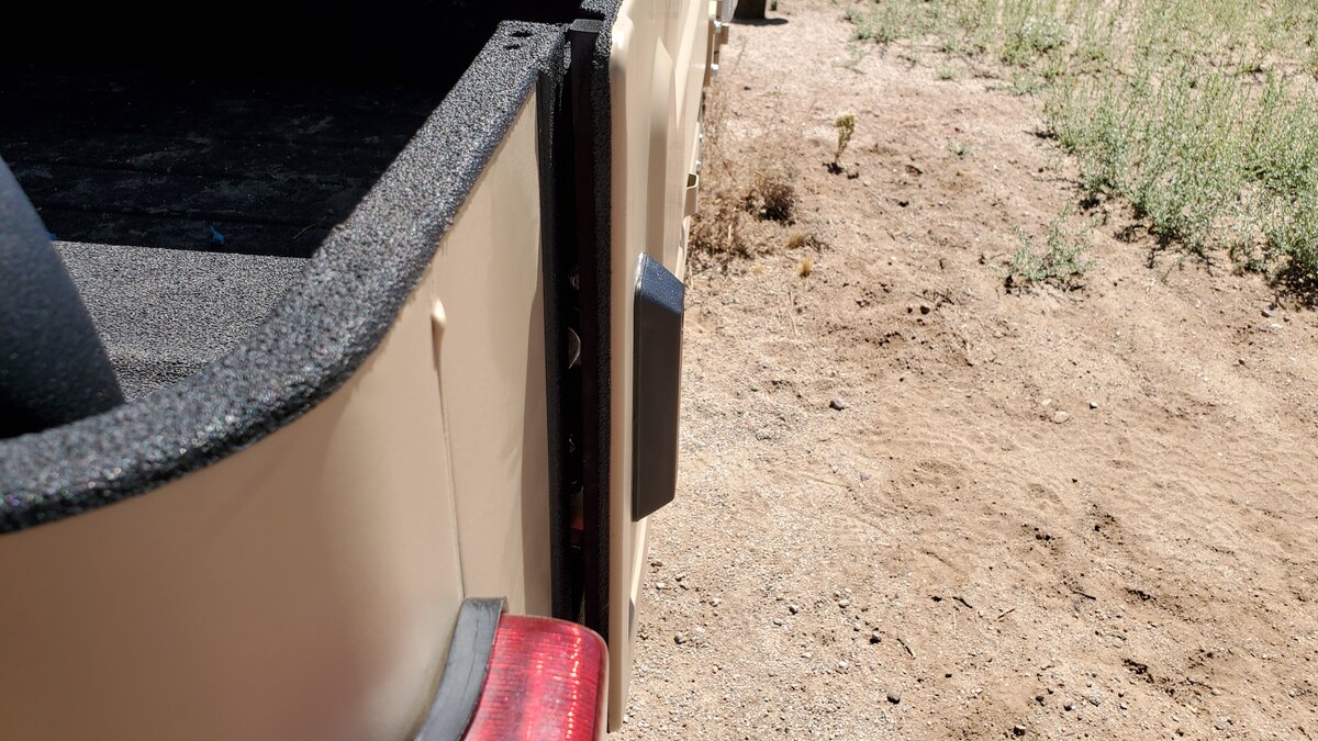

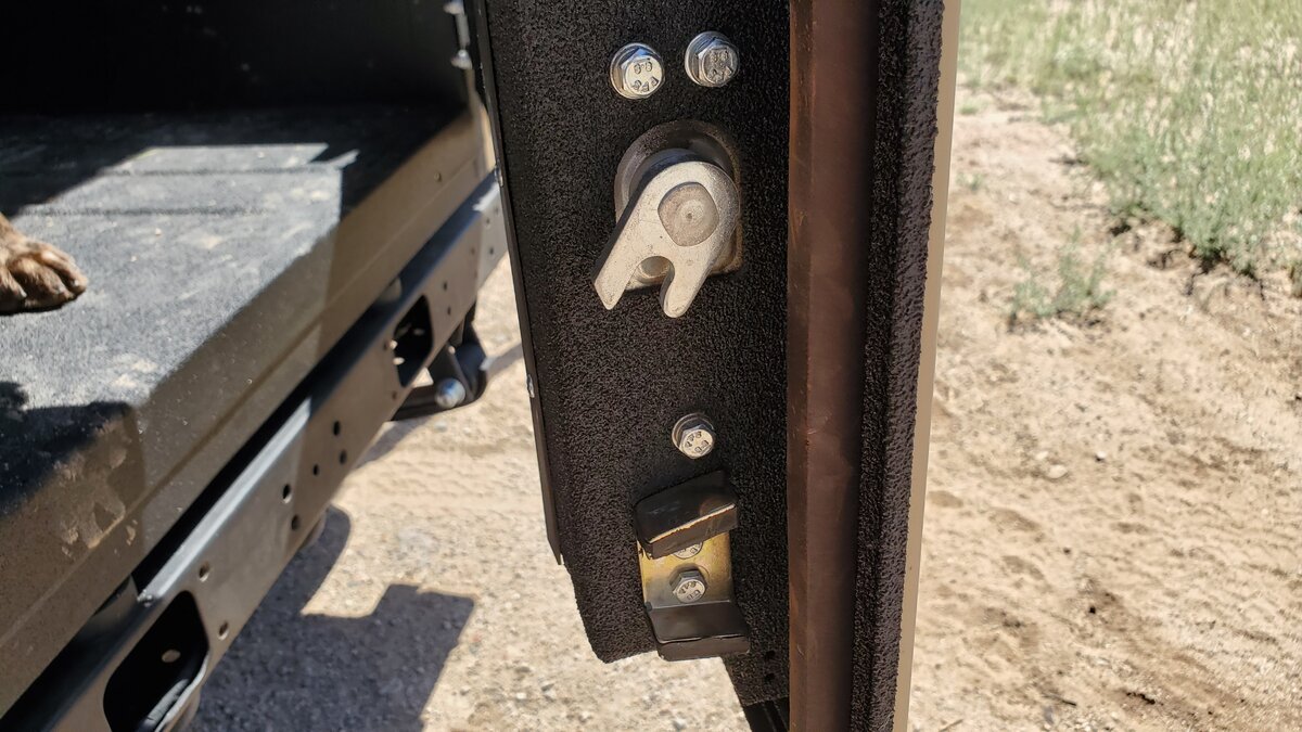

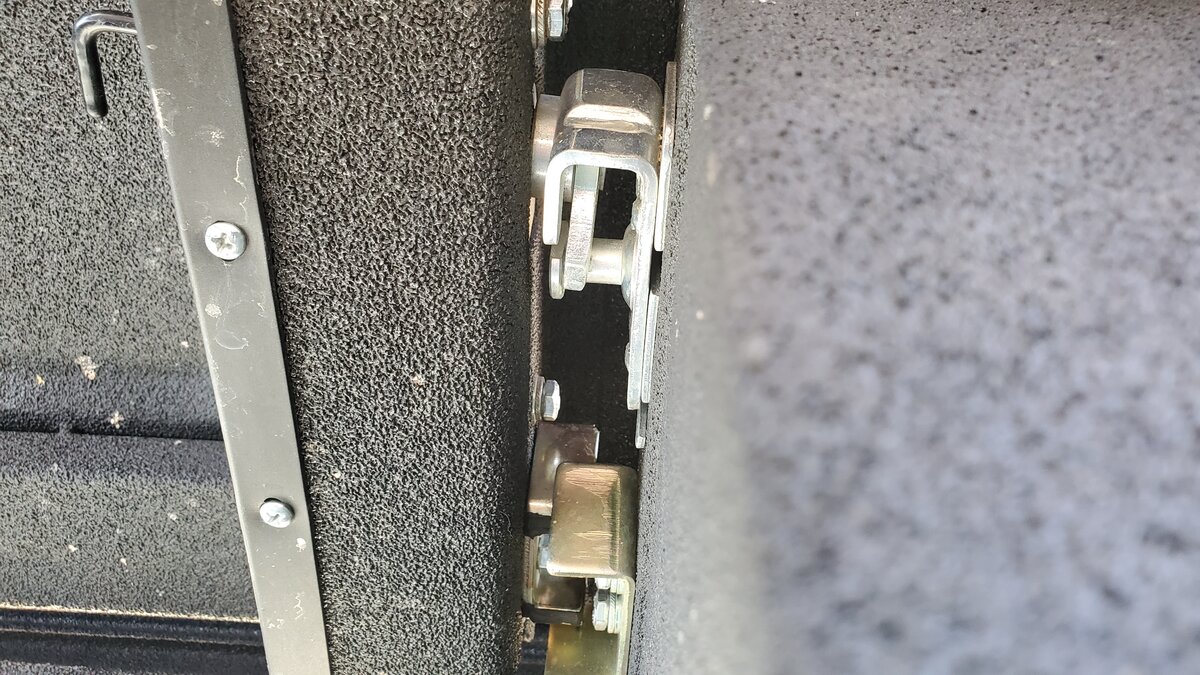

Morning everyone. Just took delivery on a 2019, and these things are pretty rad. I do have an issue that I'm hoping to get some help with.
When I close the tailgate, it only closes to the first click (latch rotates down one position), but even if I apply a large amount of force I cant get it the latch to rotate to the second closed position.
I took the plastic cover off (three screws) to take a look at the mechanism. Im not seeing the ability to adjust anything, and am wondering if there's a trick someone can throw my way. View attachment 6662View attachment 6663View attachment 6664
