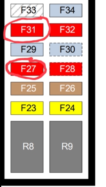

2,290
Has anyone got any positive traction with this issue? I recently replaced my battery to find a speedo cluster not working. LCD is black and needle doesn't move. Any ideas?

2,290
After further looking into this, I noticed fuse # 31 in the panel under the dash on the passenger side is blown. I tried to replace it; however, it keeps blowing the fuse. Anyone else have the same issue? Any idea what would make it blow?
