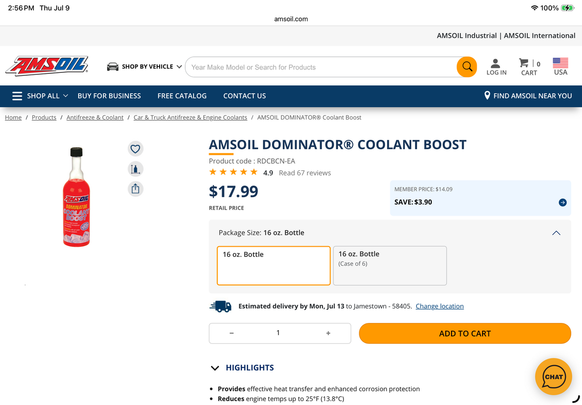

Wades response wasn't very helpful imo. If the tunes gonna cause overheating then they should have notated that in the description for the product.
That being said, I'm down to do 'even more mods to make it dailyable'. Dont think there's much room for a thicker rad. There's only about an inch behind the electric fan before it touches iirc. Any advice would be greatly appreciated, thanks!
