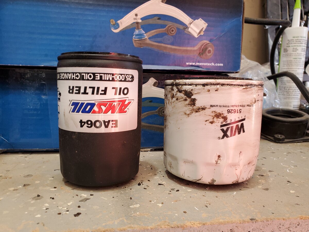

Amsoil 15k32 works as well as Amsoil EAO64
822
One is a 15k filter the other is 25k. The 64 is a tad bigger. All filter 99% and have bypass valves built in. Nanofiber technology. They filter at 20 microns
822
I've been using this Amsoil filter on my chevy for years and it may not be as wide but it is longer. The overall filtration and leading technology is what I aim for. The bypass valve is the 8-11%. Fits perfectly the gasket is in the same exact place as the wix.
