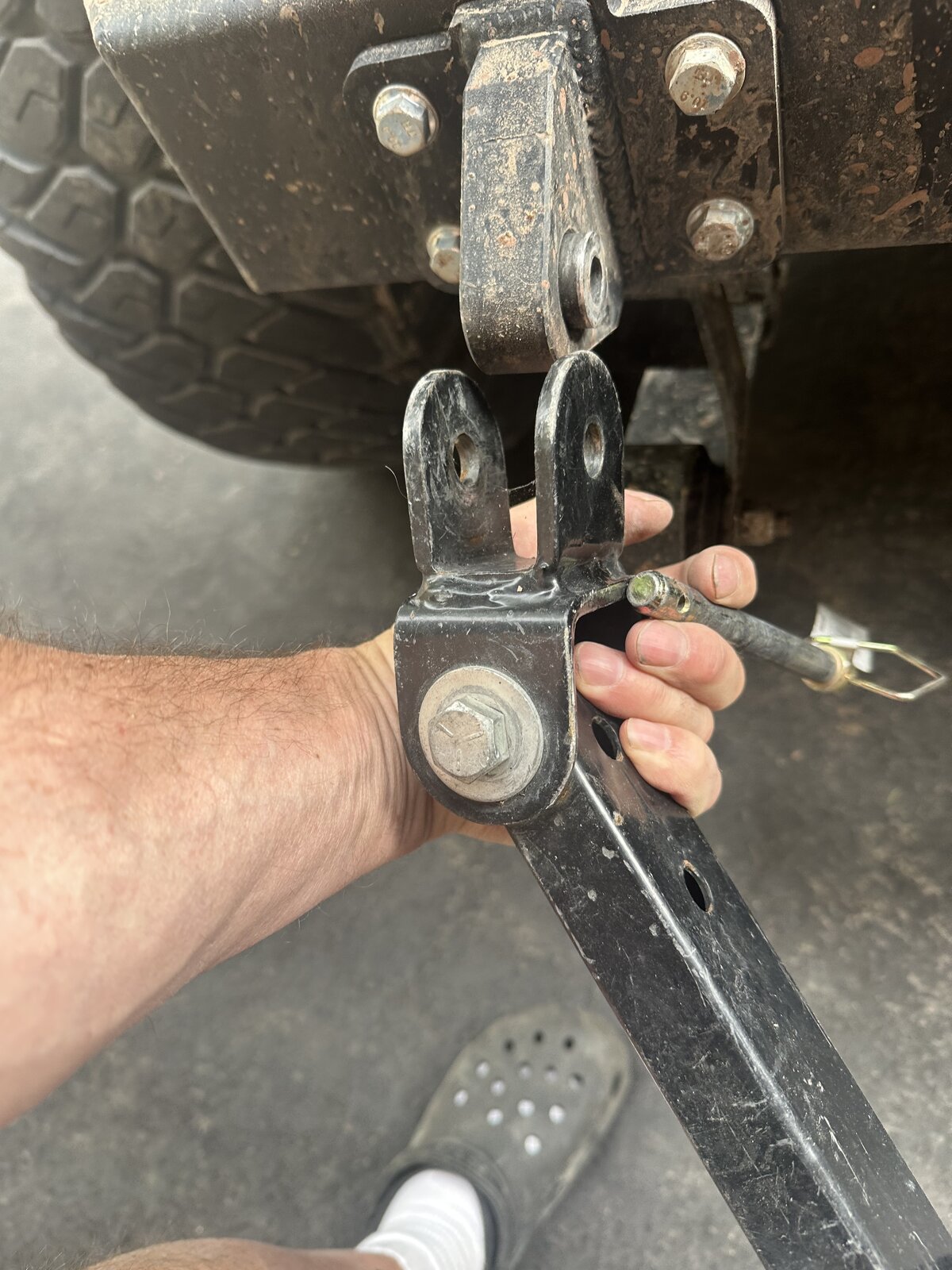

M marschb New member Joined Aug 25, 2026 Messages 8 Points 3 Location Michigan Roxor Ownership Looking to buy Yesterday at 3:51 PM #41 TomRox said: I have the cheapest Harbor Freight style I will try to send pics of how I did it w the Cecco mounts Click to expand... Very much would appreciate.!

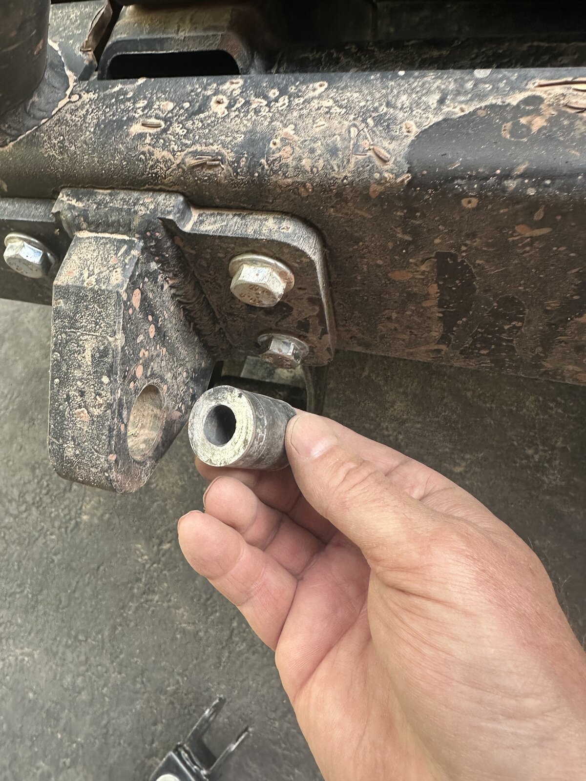

T TomRox Active member Joined Apr 15, 2023 Messages 202 Points 28 Location Colorado Roxor # 8164 Roxor Ownership Roxor Owner Yesterday at 11:08 PM #42 I have a Smittybilt Tow Bar and Cecco D Ring clevis I had to buy 1” x 1/2” round stock and cut 1.5” pieces for a bushing Then 1/2” pins to go thru Have at least 2000miles on this set up I have extra round bar if someone needs it, I had to buy a 2ft stick
