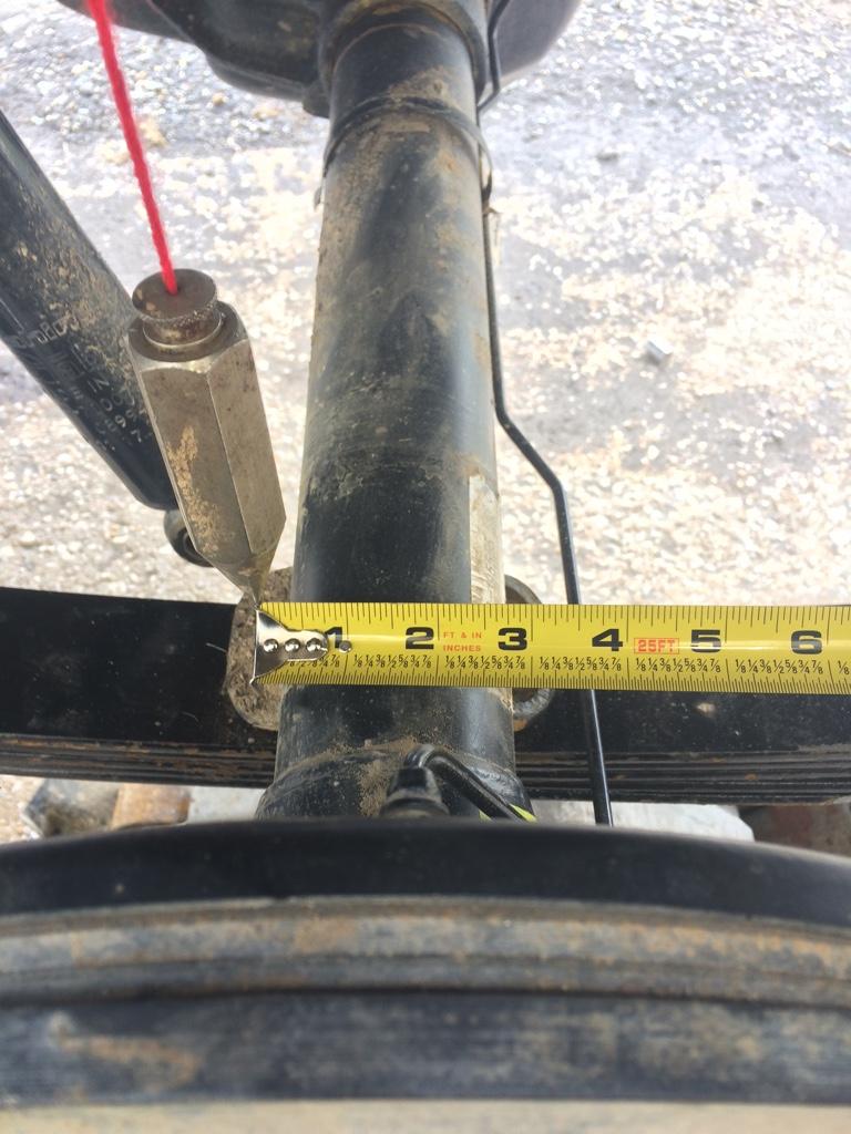

[mention]AZROX [/mention] dug this out of the trash for ya. This is what I used. If I didn’t have to do an emergency fix during a trip I would have just bought the on the rox kit. You don’t save much money doing it this way. I just needed something right away so I didn’t end the trip.
876
I tracked down what I htink is one of those old Willys shackle bolts. If this si what I think it is, it's only ~.675 thou.

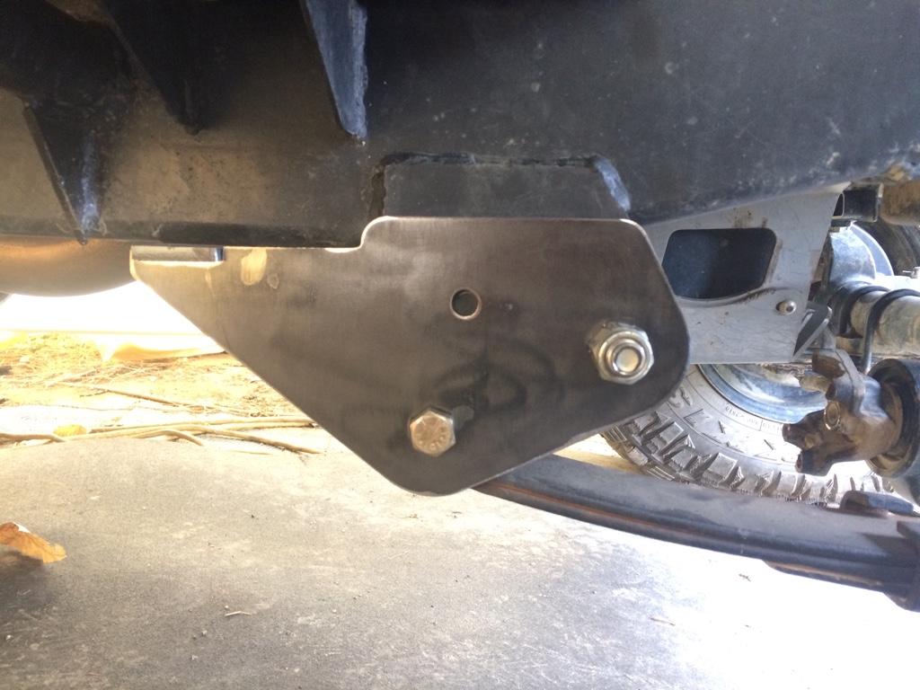

Well guys, just got word that the County offices where I work are closed until further notice because of this virus. That means I’ll have plenty of time at home to get moving on this.
I want to revisit the conversion mount on the fixed side of the front spring. It works great but I think it can be improved. I also am going to go ahead and cut off the rear spring hangers and print out a new set that will accept the modern style leaf springs with poly bushings.
******edit******
I did not have to cut the hangers off. I figured out a way to use a similar method as I did on the front. I did move the shackle side forward a few inches. As seen in post 83

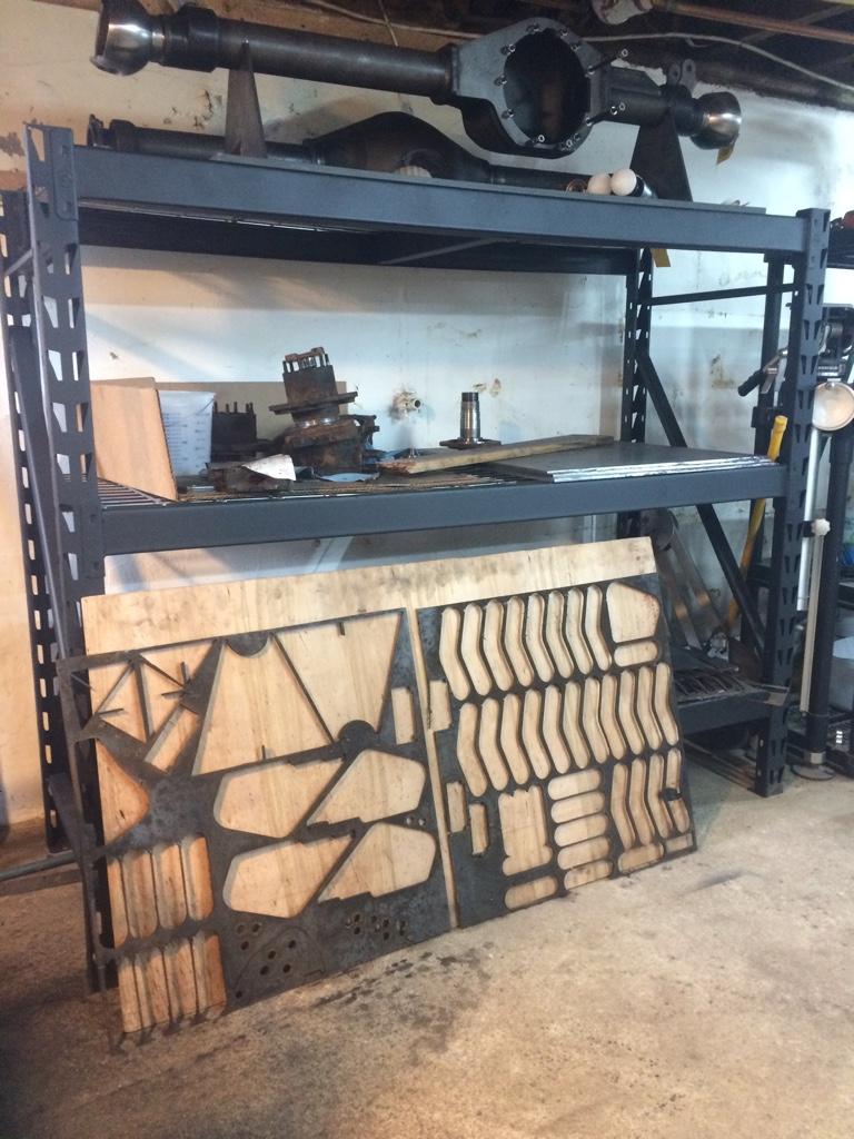

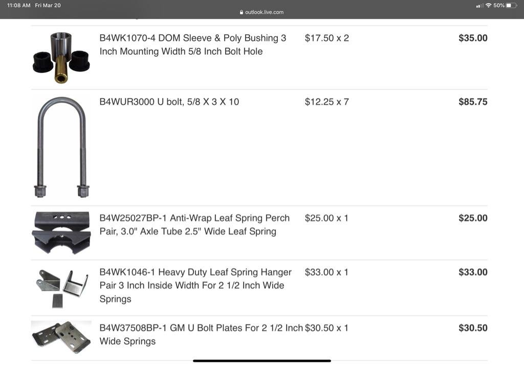

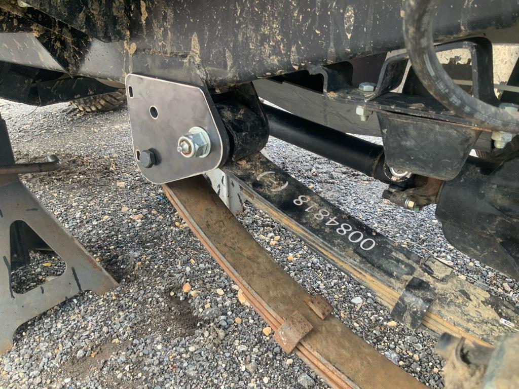

Placed an order at Barnes 4wd for some parts to finish the rear.
I’m going to cut out the rear shackle bushing tube and replace it with a shoulder style bushing and sleeve. I could have cut some of the other parts I ordered out on the plasma table, but for the money, I might as well save myself a few hours of cad work.
And yes only 7 u bolts! You’ll see why later.

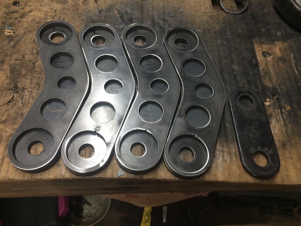

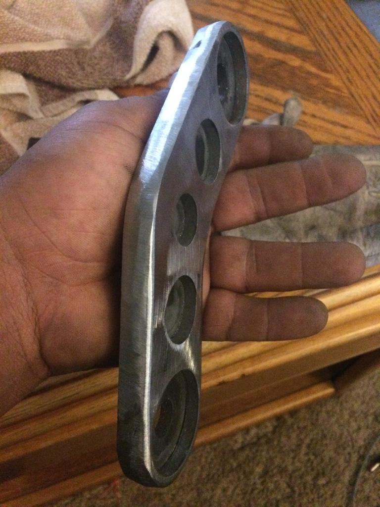

Staying busy in the basement cranking out parts and filling orders.

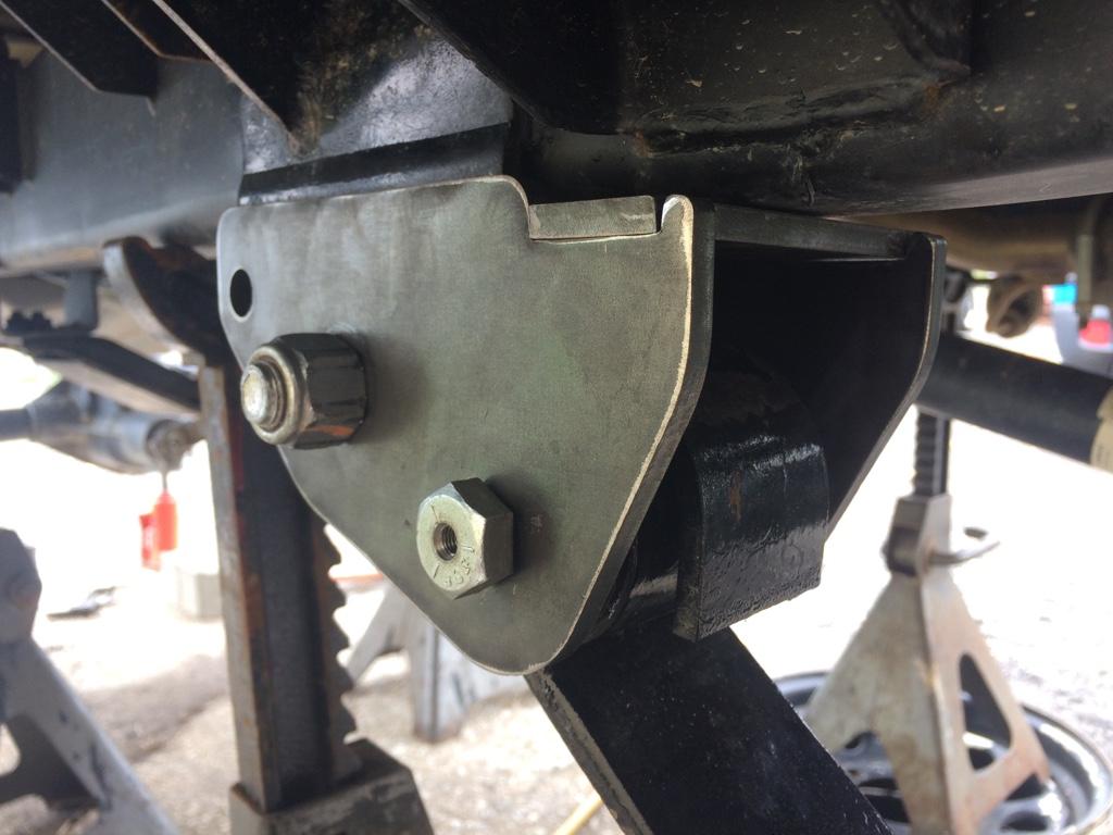

The front spring conversion adapters have evolved. Much more beefy. So much so that they support the weight of the vehicle before adding any additional hardware. I’m feel very confident in this design. The previous was good but this is bomb proof.
Old
New

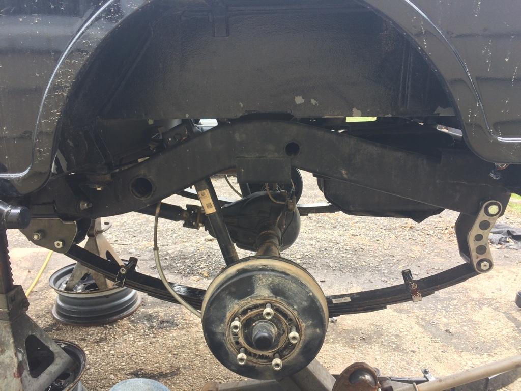

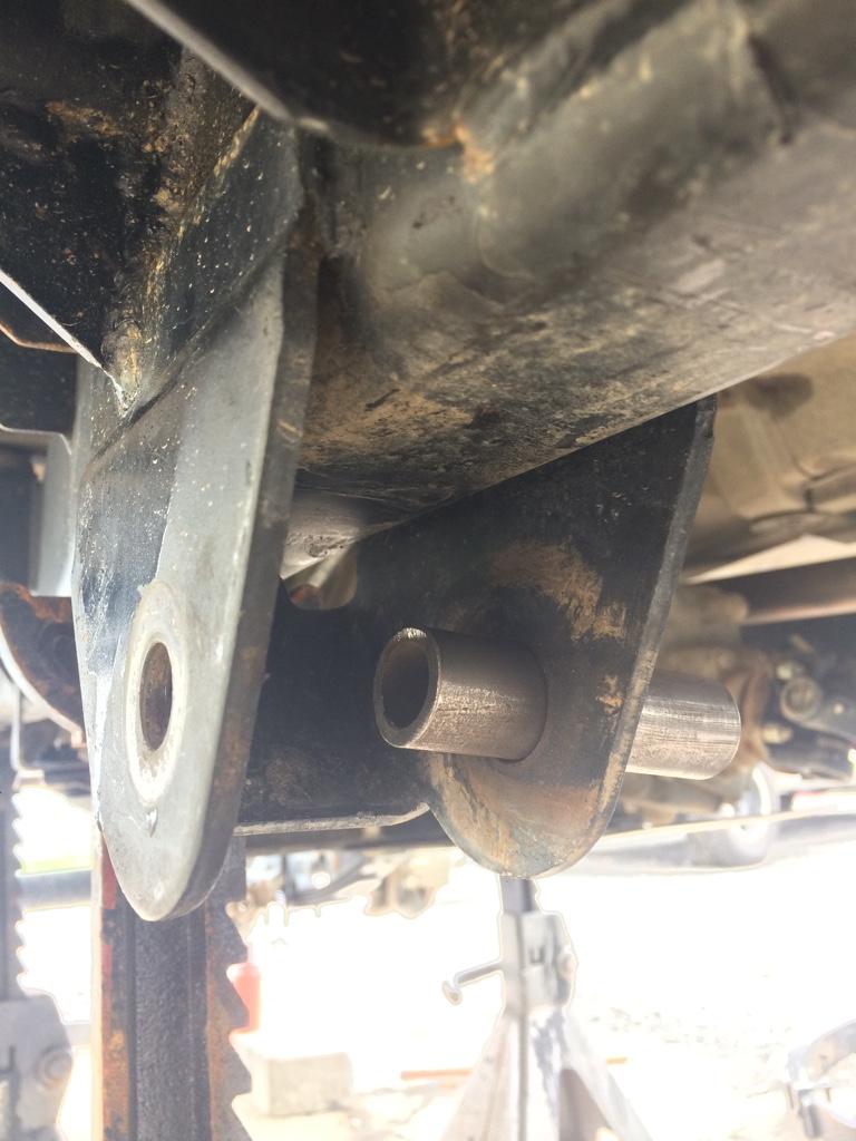

I also started working on the rear. With all of this extra time on my hands I was able to come up with a way to adapt the rear WITHOUT cutting the spring hangers off the frame. I used a very similar method as I did on the front. I’ll get pictures of that later this week.
Next I came up with a shackle that has 5/8 hole on one side and the 9/16 bolt size on the other for the yj springs. The busing tube will be frenched in towards the top of the frame rails and a 6 inch long boomerang shackle is required to allow proper travel with a spring as arched as the 4 inch YJ springs are.
There is no room for a cross brace so they have to be strong! 1/2 an inch thick strong!
Hoping to have more parts delivered by the end of the week so I can really get moving on this. I’m starting to run out of things to do. It would be great to have it sitting on all 4s next week.

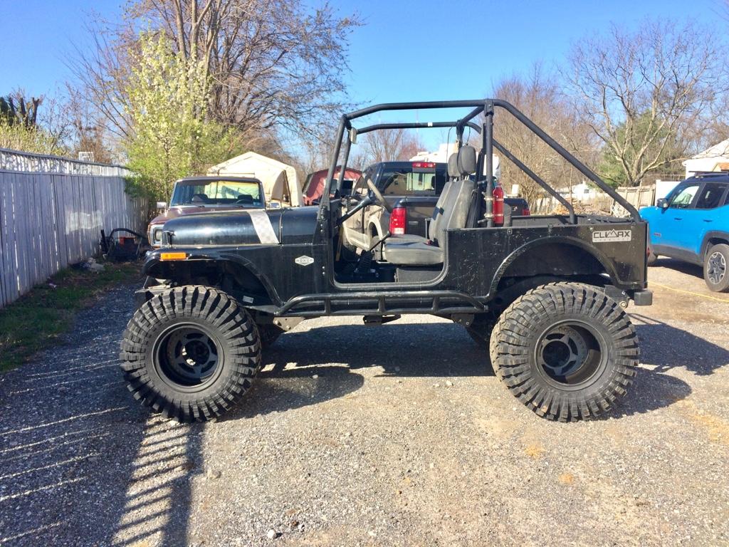

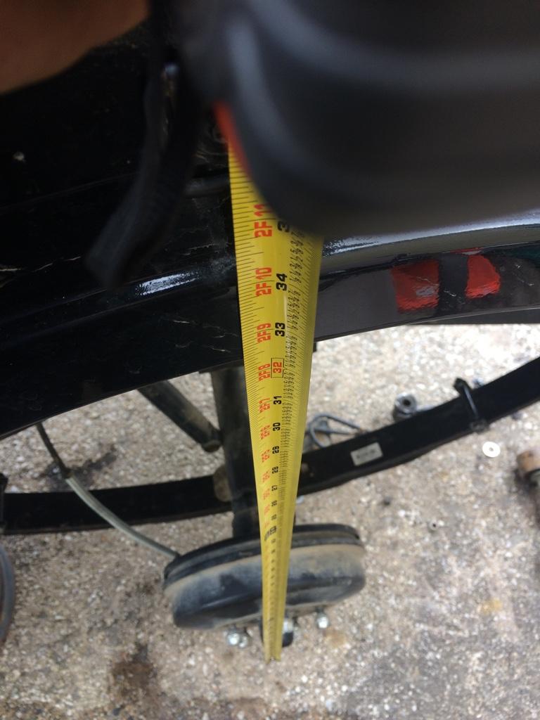

Some pics from today.
Looks like my Barnes order will be in tomorrow so I can fix the rear shackle geometry. It should sit about 2 inches lower in the rear once that’s done. May be able to get the new rear axle mocked up as well.
King Shocks is completely shut down for now. The build time was about 5 weeks for the shocks but who knows now.
Raceline also is a little behind drilling out my wheels. Fingers crossed I’ll have them next week so I can get the 35s on.
