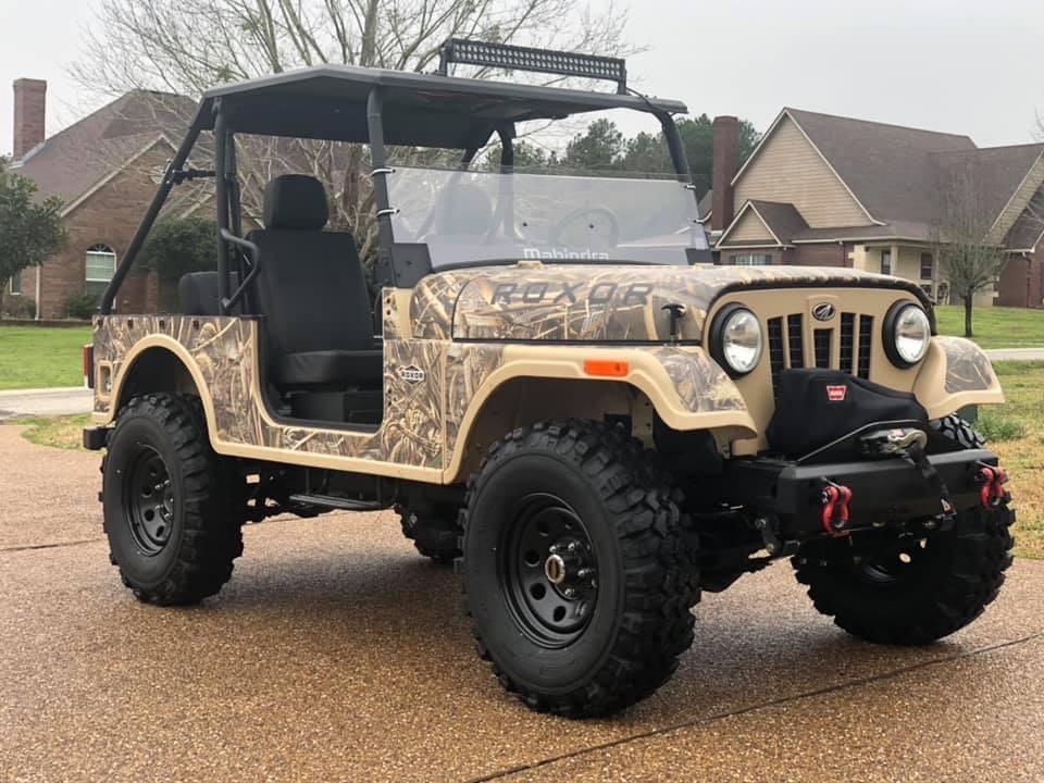

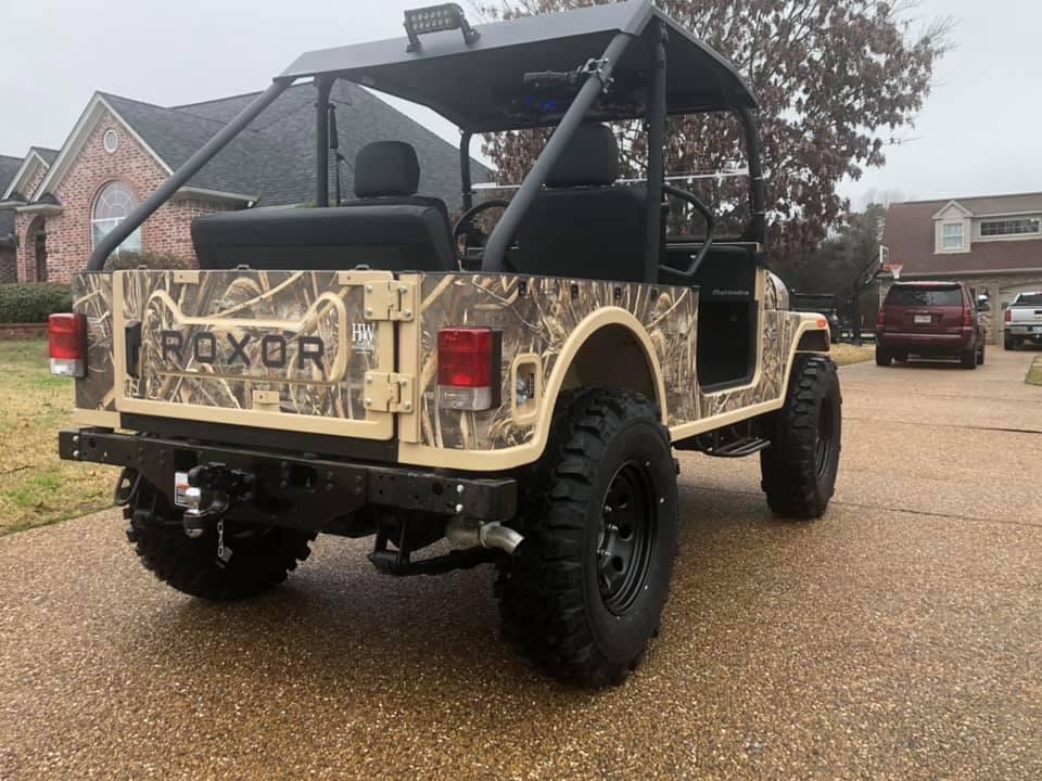

I had a lot of people ask about adding a little to the rear after doing a leveling kit. Mostly with the OTR shackle reversal. Roxors will sit pretty much level with any of the kits, but as soon as you put any load on it it will squat in the rear. That is the reason trucks or any other utility use vehicle come higher in the rear. When loaded it sits level as designed.
With a leveling kit you sit level unloaded and then you squat with any weight added. The one inch rear shackle is just enough to bump the rear up and negate the squatty overloaded look.
This is a roxor with a OTR 2.5 leveling kit with my one inch lift shackle in the rear. I think it sits perfect with no load and level loaded.
$45 part. Why not right?
