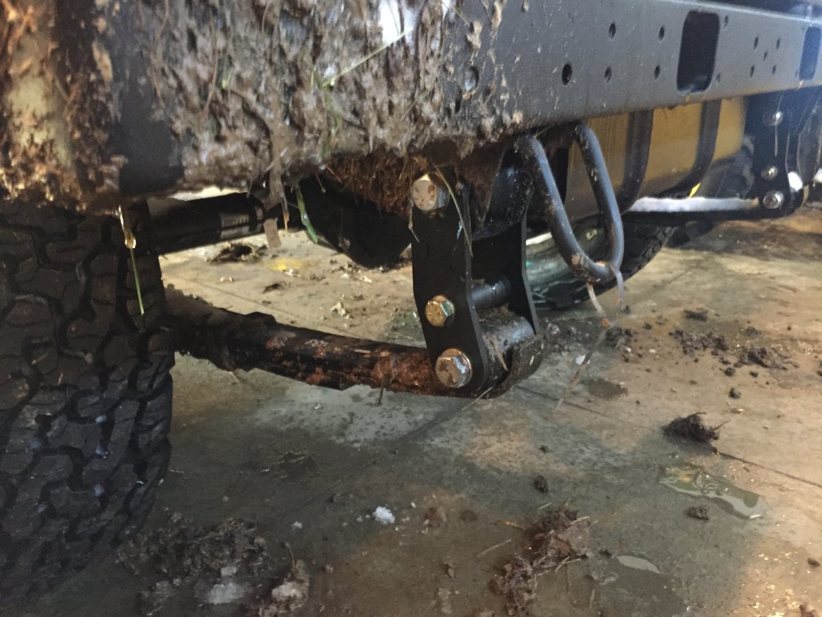

Now i will add this, shackle lifts have two negatives:
A) your approach angle and descend angle will decrease. Taller tires will help this.
B) you will through your pinion angles and caster angle way off. This problem can be fixed with some measuring then installing the correct degree shims to your leaf springs.

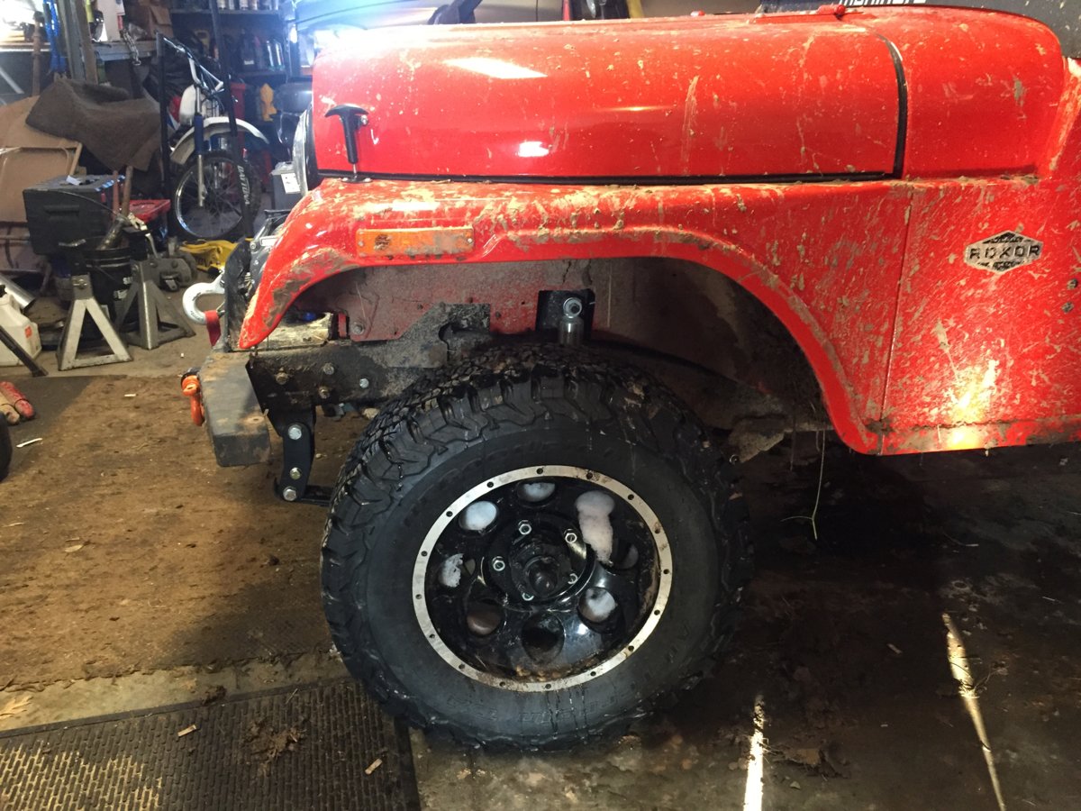

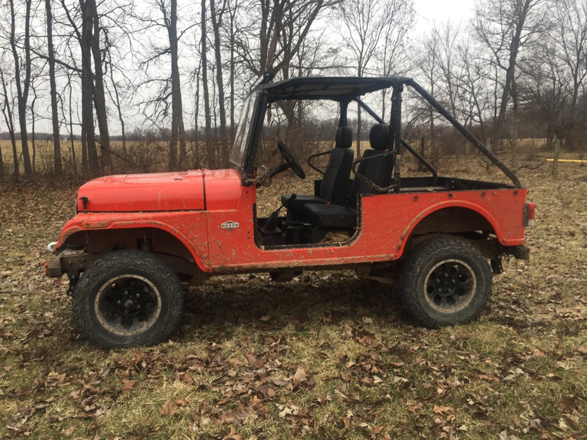

OK, I have lifted my Roxor about 3 1/2 inch front and 1 inch in the rear. Almost all parts used are easily available to all. There is some fabrication to the shackle kit, drill out holes in degree shims, and i made the 1/2" spacer for trans mount. So i started with installing the "add a leaf" this brought the front up about 2 inches. Then i installed the shackle lift, i am not a fan of these because to many people do this but don't address the problem they make with the pinion angles and caster angle. However i have installed the appropriate leaf spring degree shims to correct the angles. Everyone needs to understand that with the type of drive shafts we have the pinions need to be on the same plane. What this means is if the rear out put shaft of the TC (transfer case) is at an -6 degree angle from horizontal the rear pinion should be at a 6 degree angle, that is on the same plane. The rear pinion will need to as close to perfect as it can but if needed you can go up to 1 1/2 degrees lower, never go higher, that would be 4 1/2 in this example. Now in this example the front output shaft will be at 6 degree. So the front pinion would need to be at a -6 degree angle. The problem with the front axle is we also need to look at the caster angle, i have not been able to find the spec. for are ROXORS. But i do know the the Jeep CJ's and YJ's run best around 6 to 9 degrees of caster. For those who don't know more caster gives the steering wheel a "heavier feel" and the tires will center faster, i normally try to keed this angle around 7 or less degrees for leaf spring jeeps. After installing the shackles i was happy with the height, it is about .1 degrees from level. Now i checked the pinion angles, i use a digital lever about 1 foot long. On our roxors it is easy to do these measurements. If you look at the back of the TC you will see the round cover where you can install a PTO or overdrive this surface is machined at 90 degrees from the TC output shafts. So I put level across the cover and yes it is -6 degrees so i zeroed level. Now on the back of the rear diff i set the level against the two cover bolts on right side of cover, +9 degrees. Went to front diff and use the two bolts on left side of cover +4.5 degrees and caster is maybe +.7 degrees. You can measure your caster by placing a socket on top ball joint, big enough to not touch the ball joint stud but sit on the nut. The axle has about a 5.5 degree caster if you set the pinion to perfect level. So to be perfect the rear pinion needs to go down 3 degrees, and the front needs to go down 10.5 degrees. This will not work, degree shims don't go higher than 8 degrees and the caster will be to much. Front pinion and caster angle fight each other, but on the front axle the pinion angle is not as important as the rear and can be fudged
by a few degrees, up only. I normally allow 2 degrees up but you can go higher, the rear always has torque on it but the front does not. So i installed a 4 degree shim in the rear, now the pinion is 1 degree lower than TC shaft, thats great. I installed a 8 degree shim in the front, now the pinion angle is about -3.5 degrees and caster is +9 degrees, more than i want but it does drive well. Because i wanted to get my front pinion angle better i decided to raise the TC by installing a 1/2 inch spacer between the TC and mount, the one on the cross member. When i did this i also made a 1/4 plate for the second mount on right side of the TC, here you could use fender washers. This raised the TC 1 degree, now my rear pinion was dam near perfect and the front is high by 1.5 degrees. This is great and allows me to change the front to a 6 degree shim and get my caster where i want it. One other thing i liked about raising the TC is the shifter now has more clearance to the E-brake lever. My son has a Roxor as well and we will be doing this lift to his next weekend, we are using the 6 degree shim in his so we can compare the two different angles. Ok so now i am happy with the lift height and angles. The sway bar links work very well they allow adjustment of height, sway bar should be level. I also replaced all four shocks, stock ones are cheap. With the added height the front shocks are not long enough, max extended length is 20 1/2 inch, ride height about 19 inch, need new front shock. The shock i choise has a max extended length of 22 1/2 inch and mounts with the main body up, rod and boot down, so there is no clearance issues. The stock rear shocks don't need to be replaced but i did anyway. So if you want to do this lift you do not need the rear shocks, and if you don't do the TC raise i would recommend staying with the 8 degree shin in the front. With the increase length of the front shocks brake lines are now to short and will need to get longer ones. I will be removing mine tomorrow so i can figure out how we can install longer ones with easy to get parts.
