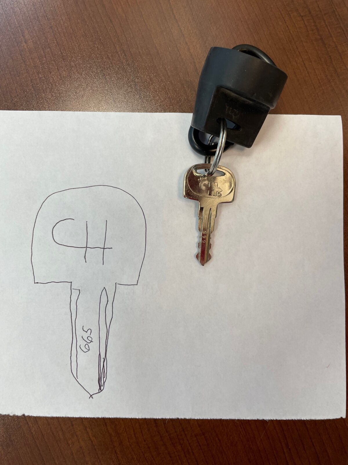

I'm in search of a spare key myself. Bought an '18 used. My key is the same shape as the '640' but has 665 pressed into the side.
I wonder if it is the same blank?

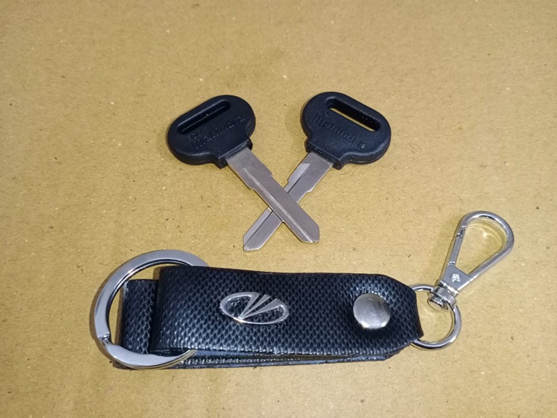

I just purchased 2 Mahindra key blanks from J5 tractor in Normangee, Texas. Try them out.

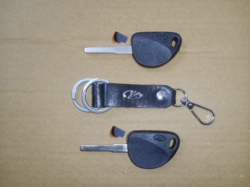

Hi,Can someone share a clear picture of the Keys.I can try & source the correct one from mahindra
GiStore
Jan 16, 2023
147
India
Thar Owner
Pls check these two types are readily available with us

I would just Google J5 tractor and ask for Roxor parts. They will send you to the Normangee store. Ask for Travis, he was very helpful and knowledgeable.
I have a 2018.
I do not see a number stamped on them but they are the standard ignition keys.
They are blanks. I took the original key with the blanks to Lowe’s and they cut them just fine.

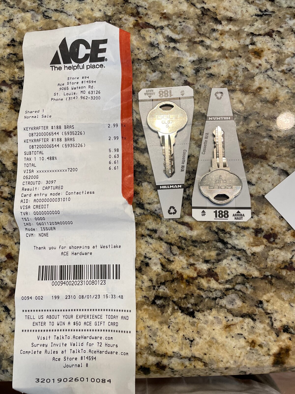

I have found the holy grail .... after 4 locksmiths, visiting a Mahindra tractor dealer and 2 Ace hardware stores!
Much as he tried, the Mahindra parts guy couldn't match it [if he had he said they charge $18/key] but then suggested going to the Ace hardware store down the road and look through ATV and motorcycle keys [they've had some success doing that in the past]. I was skeptical because I had tried an Ace in the middle of my search but gave it a shot.
Sure enough, found a guy who knew what he was doing and he was able to match it to a Hillman 188 [he didn't even bother with atv/motorcycle keys]. Cut me 2 with a complete guarantee if they didn't work but they did. Best part: $3 a key and I like the 'head' of the key better: larger and more heft.
Search no more, a simple solution is readily available.
