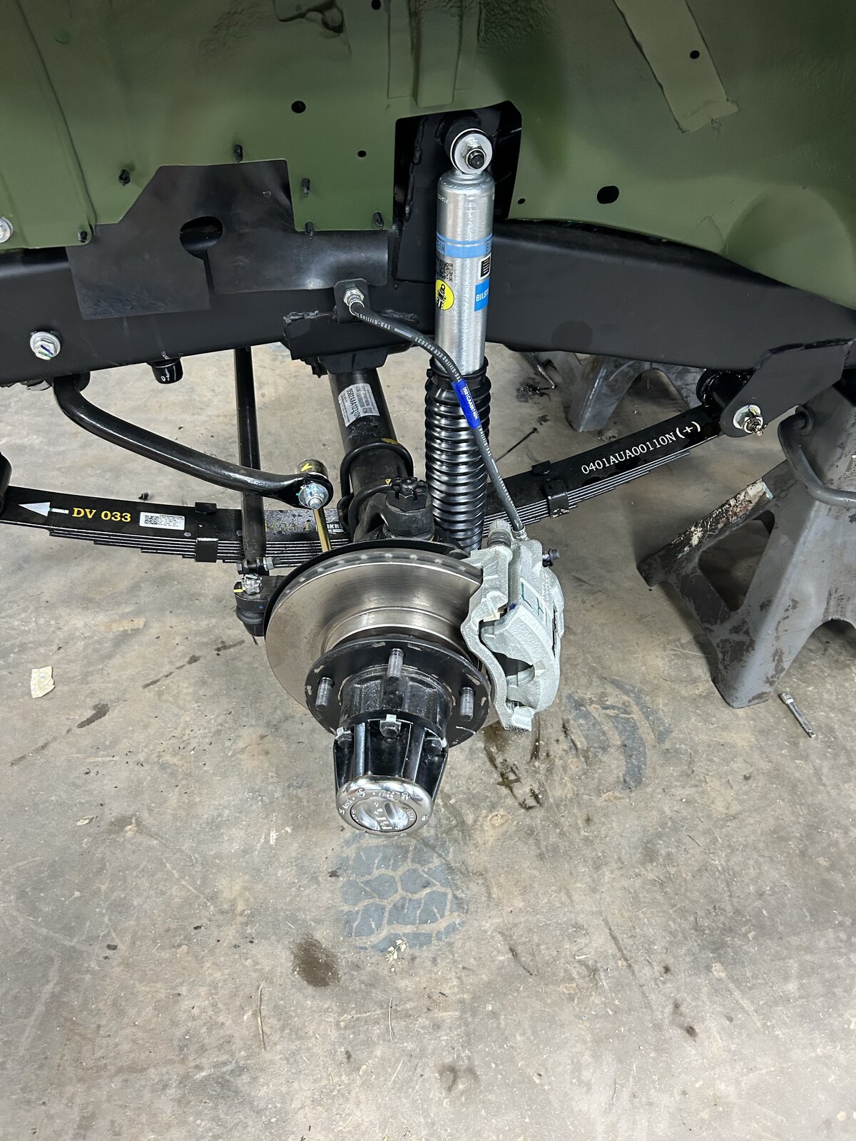

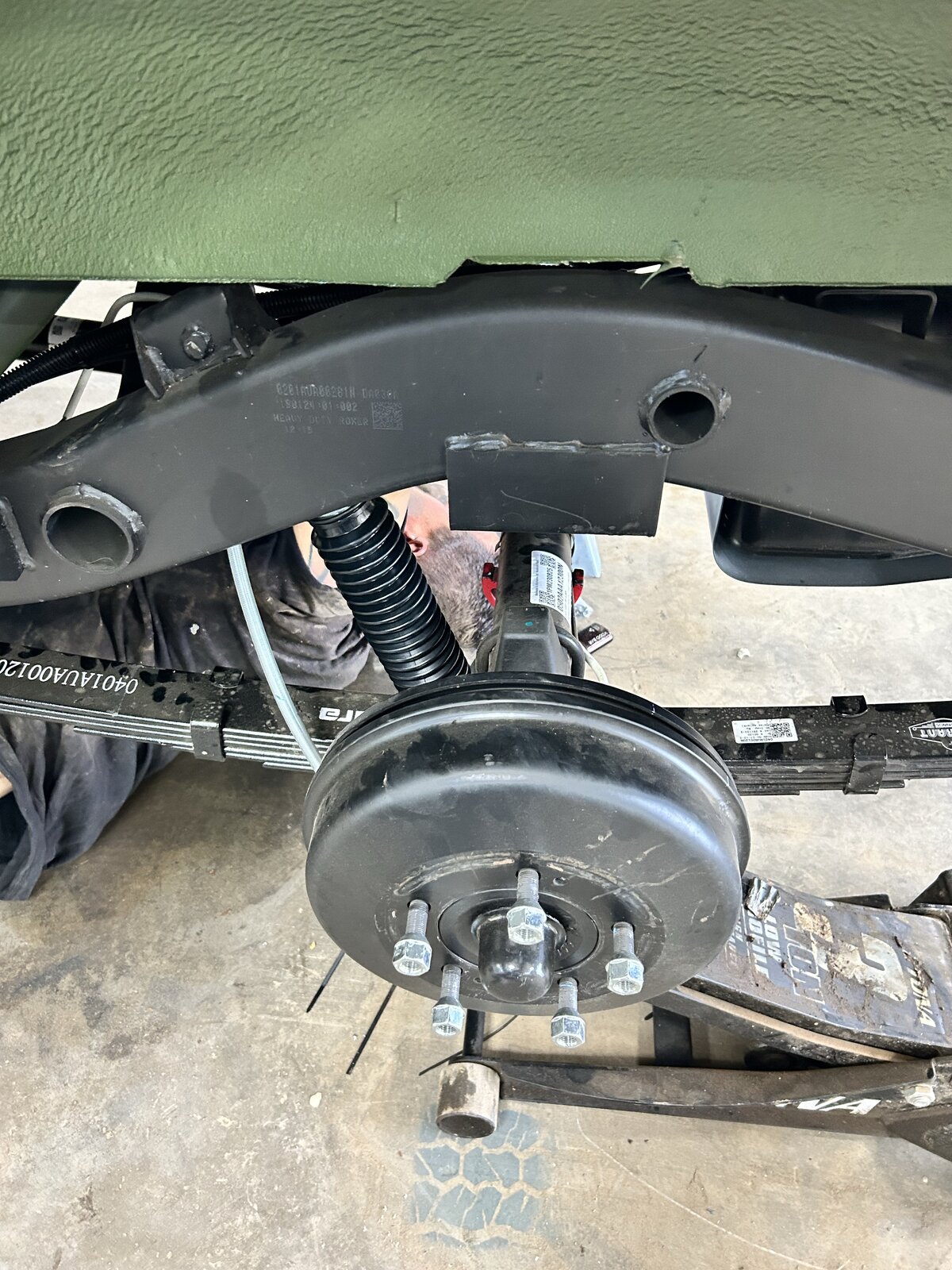

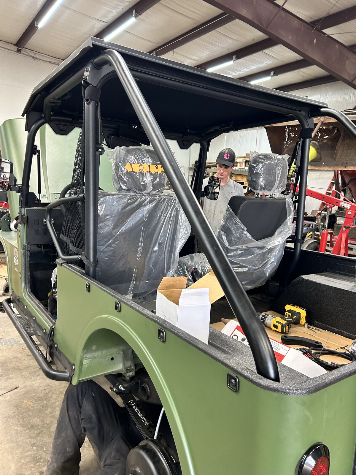

Here are a few updates.

I see the Cooper Tires are installed. Looks like the shocks are installed also.
I see the Roof and Windshield are installed.
I was hoping to get a rear view of the Farm Bumper. My guess would be that it is installed also.
Did you get it home yet?????
How does it Scale on the IMPRESSED O METER??
Looks to me like you have all the important bases covered very well. Nice Build.

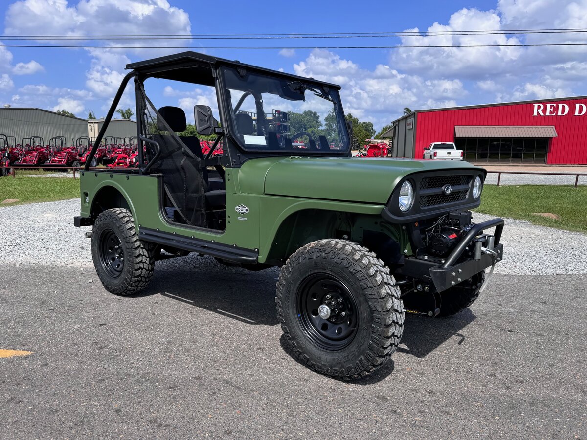

The Green Goat is still at Red Dirt getting the finishing touches this weekend. I have told them its better to get things right than to rush as I am several hours from the shop. It should be done next week and I just need a full day to make the trip to pick up the unit. Many of the items ordered were not specific for the newer HD units and need small modifications to fit I was told. They had the manufacturer involved on the ECU as it did not go 55 mph stock, and I was told they may have replaced that ECU. We shall see how it performers when I get it back.
Gabe
Jun 26, 2024
217
Louisiana

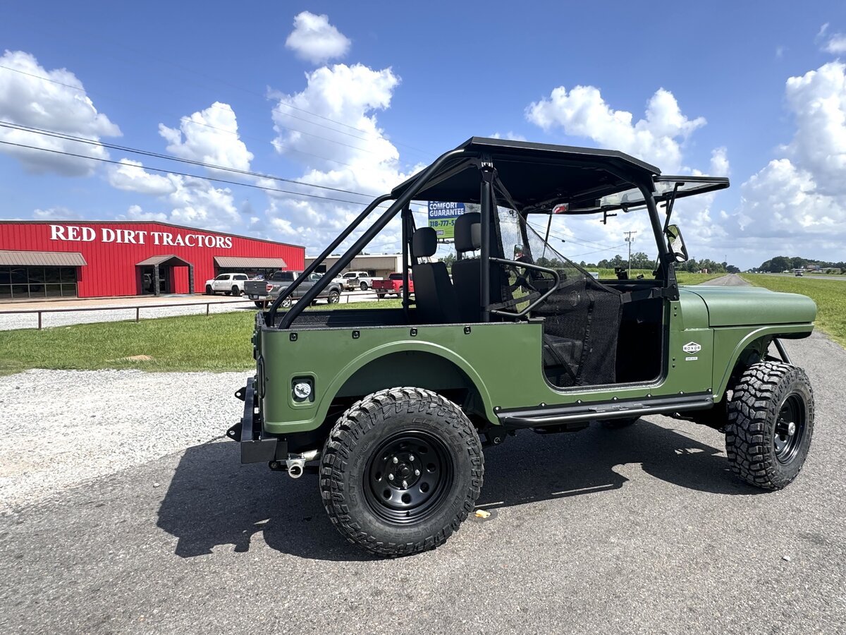

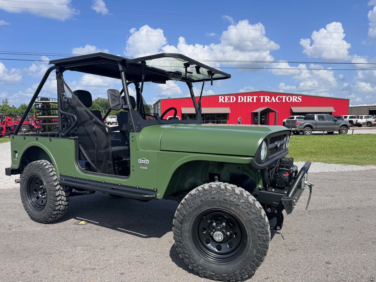

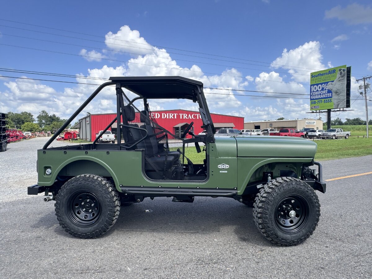

Here is the Green Goat. Just got the updated pics from Red Dirt. I haven't been able to pick it up with my work scheduled but happy with the outcome. It is what I was going for as far as looks. Now to see how it performs!

Gabe,
That looks nice with that tire tread and green paint. They didn't have green available for mine so I had to go with black.

They have a separate mechanic to do the rear locker which is the last item on the list.

It is looking very good. I hope you get it home fairly shortly.

Some pictures of the OX Locker Levers would be good. I have seen pictures of some installs that left room for improvement.

I have picked up my unit from Red Dirt. Unfortunately, they were not allowed to install the Rear OX Locker at the dealership. I was told this would void the warranty on the unit. I am leaning on running the unit as is for some time but in my conditions at my place when it gets wet in my hills it is only a matter of time where we need the locker. So working to solve this issue. I am happy with the unit and modifications done so far. The unit top end speed may be just over 55 at 56 even with the new tires on gps. I would like more top end but the unit is just not built for it with the gears. I will never do that speed at my property but if I do use for some road stuff at least I am comfortable at 50 without pushing it to the max. The bilstein shocks make a nice improvement on the ride from stock. I will have to rename the green goat to something else until I get the lockers as I know it can't be a goat without them!
Bob R1
Mar 1, 2023
463
Missouri Ozarks
I am of the opinion that the only thing they could void the warranty on would be the Rear Axle Assembly. No reason the OX Locker would cause any damage to any other parts. I really cannot believe the rear OX Locker would be a problem to cause a warranty problem at all.
