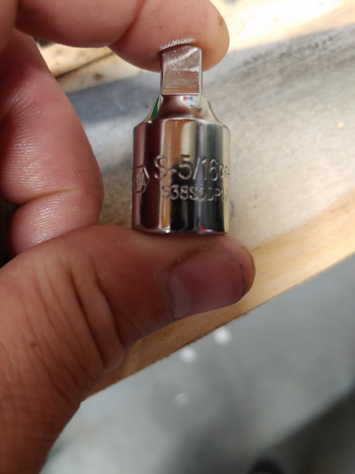

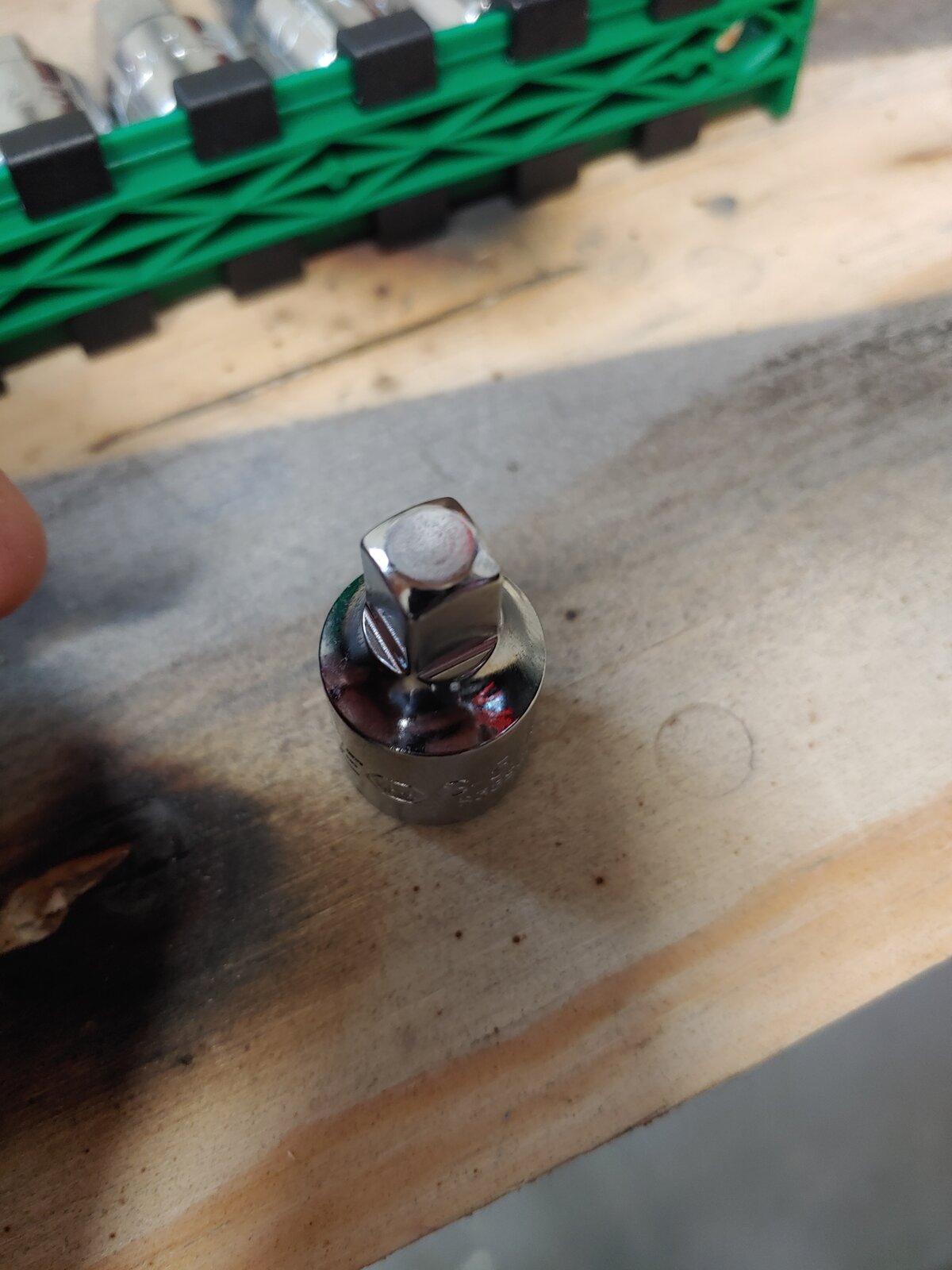

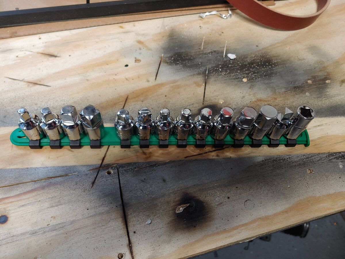

Just changes all of mine. As you know I am a huge Amsoil guy. So As far as the fuilds, Amsoil is my route. I did notice the trans case uses what is called a S 5/16 (kind of a special tool, I found at Napa, see pics). The front and rear are a 10 hex and the transmission as well. Hope this helps!
