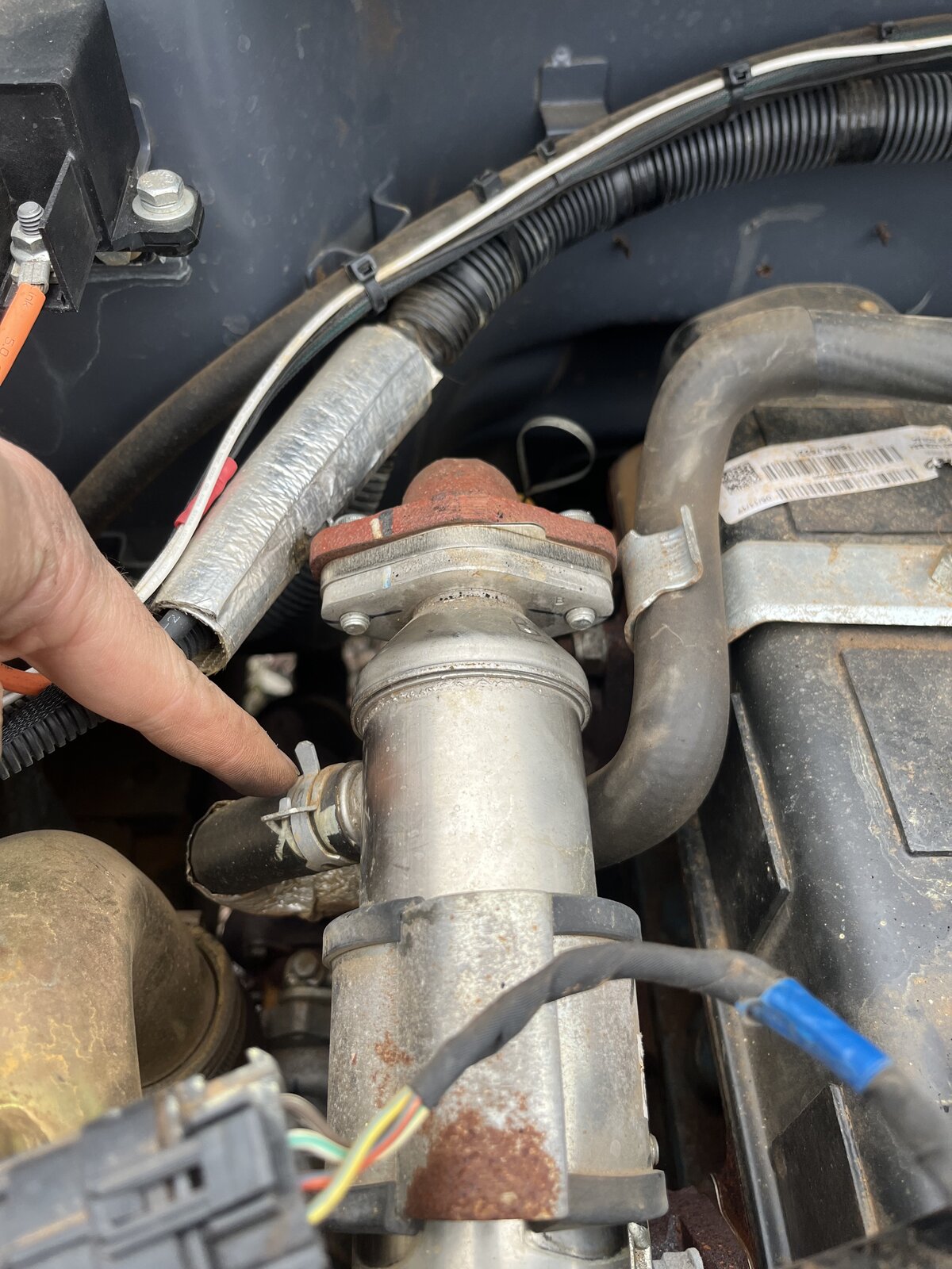

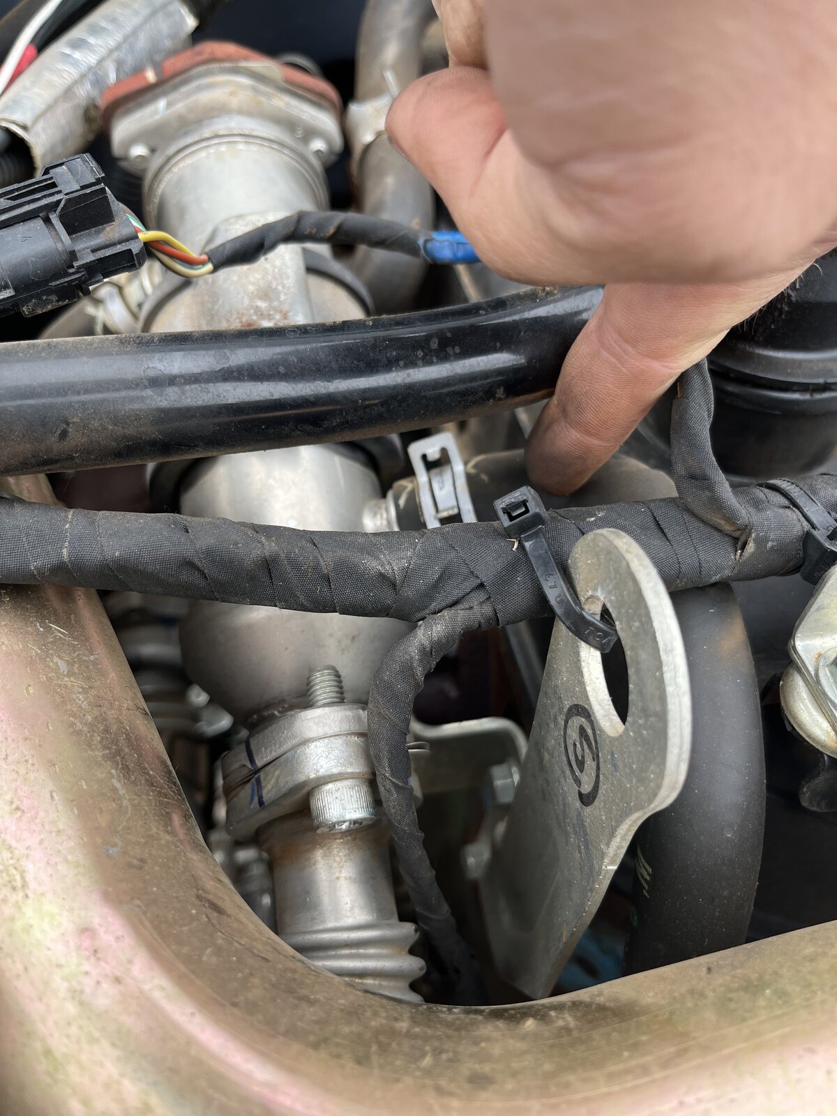

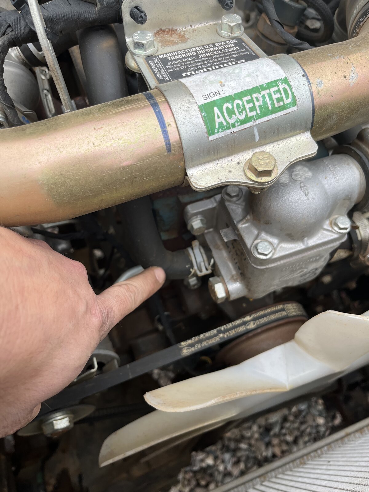

Anyone know what size plugs to use on the coolant lines for the egr?
And where to buy them?
50431853-8BA1-49CE-A5BB-77C5B88585DE.jpeg 78D42142-A633-4D25-AD12-815C413086EE.jpeg FCB7871C-2FA3-4384-BACA-C63306C1C17C.jpeg
813
Auto store. I think they are 1/2 look on the existing lines. Pretty sure u buy the caps in multiple sizes as a kit. Pretty cheap
1,268
I thought they were 5/8. But there should be some rubber caps in the help section at the auto store. Put them on and a clamp them down and you’re good to go.
