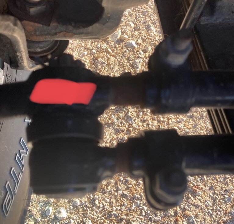

Drag bar twisting while turning. Normal?
1,326
Ok, so just smack the silver (about quarter size) end of the ball jont?
I will try that this evning. Appreciate it!
No. Hit the sides. By sides I mean 90 degrees from castle nut.
1,326
hit it on the red line. Can also hit it from the bottom swinging up in the same spot.
