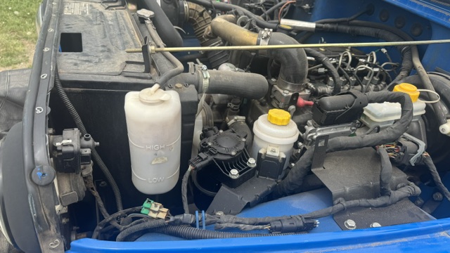

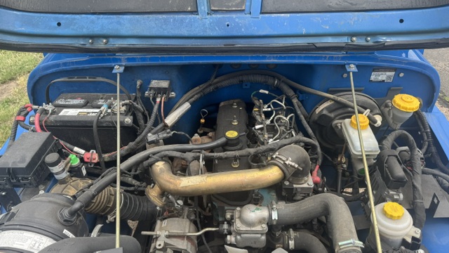

Crank no start still happening after replacing the ECM, FCM and now in tank fuel pump... Sometimes I would try it and it will run fine for days or weeks with old fuel pump... then crank no start or shuts off while driving ... still has electrical power just dead then crank no start... No water in fuel drained tank and fresh fuel, no sediment, new filter.... then again with drain for fuel pump install...
So frustrated at this point... Last thing I tried today was pick up fuel pump... after install, I bled air at fuel filter seemed to be no more air... Open bleeder and turn key to on, will shoot fuel 2 ft in the air...close it ... crank no start... 2018 10K miles

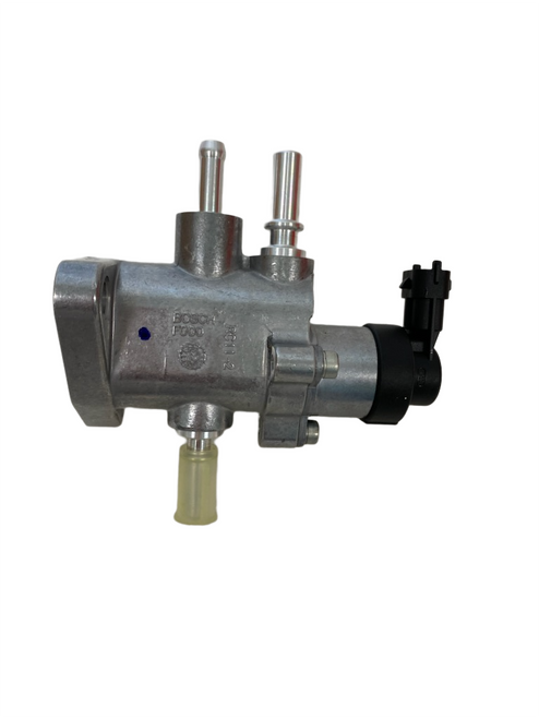

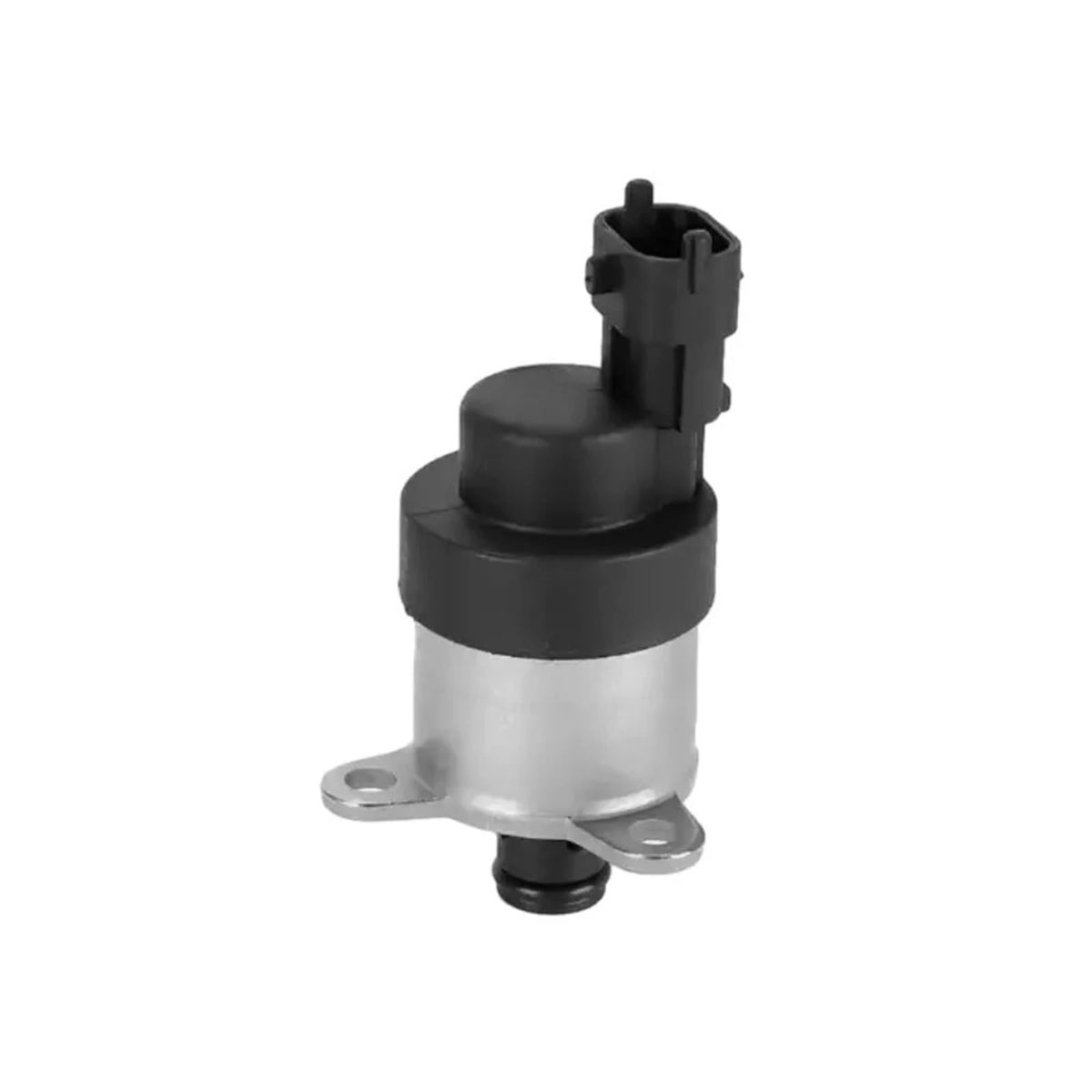

Metering valve on the hi pressure pump?
TXroadkill, veryone uses different terms, do you mean roxor unit pump and roller tappet?
