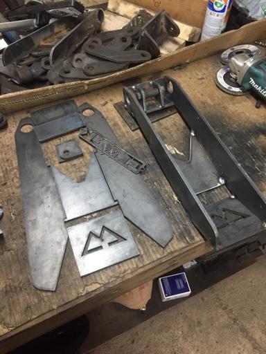

Good news! Kits will be rolling out soon. Ill be emailing you guys in the order you are on the list once I have the kits finished.
One thing I didn’t account for is the new table and new plasma table needed new programs so I had to go back into the original drawings and re work them for each little part of the kit. I finally finished that today.

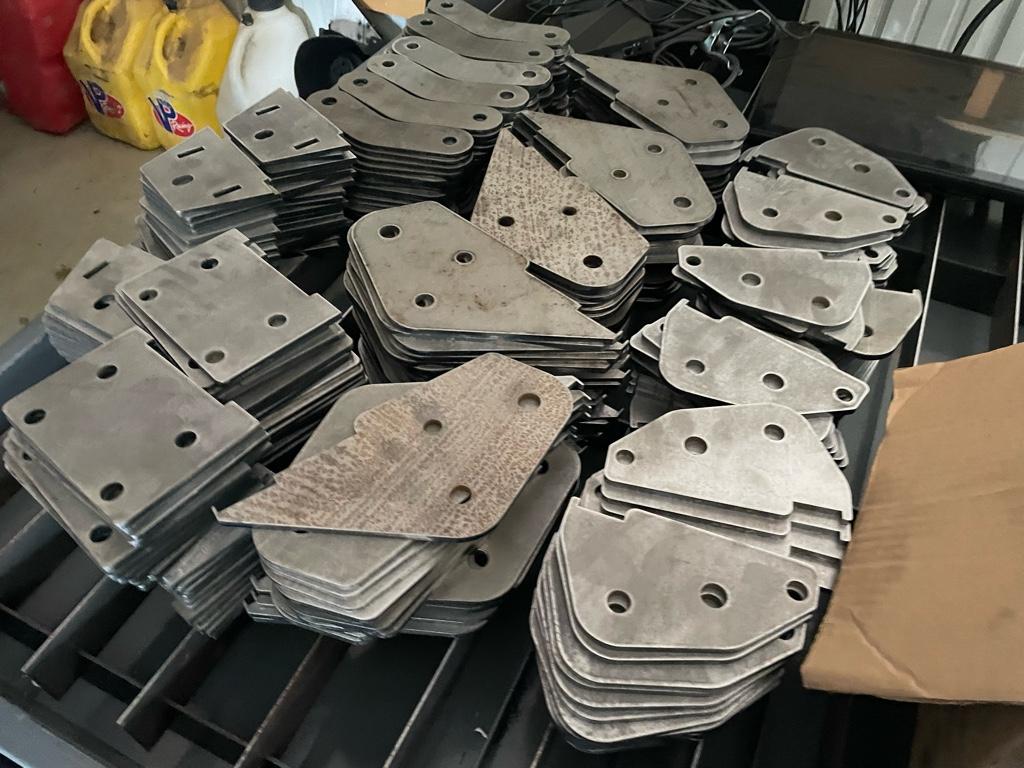

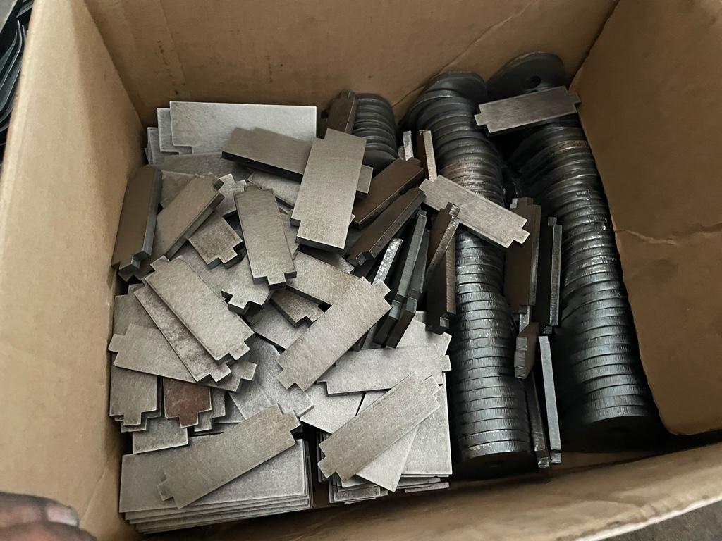

24 kits cut. Waiting on bushings and material to make the sleeves.

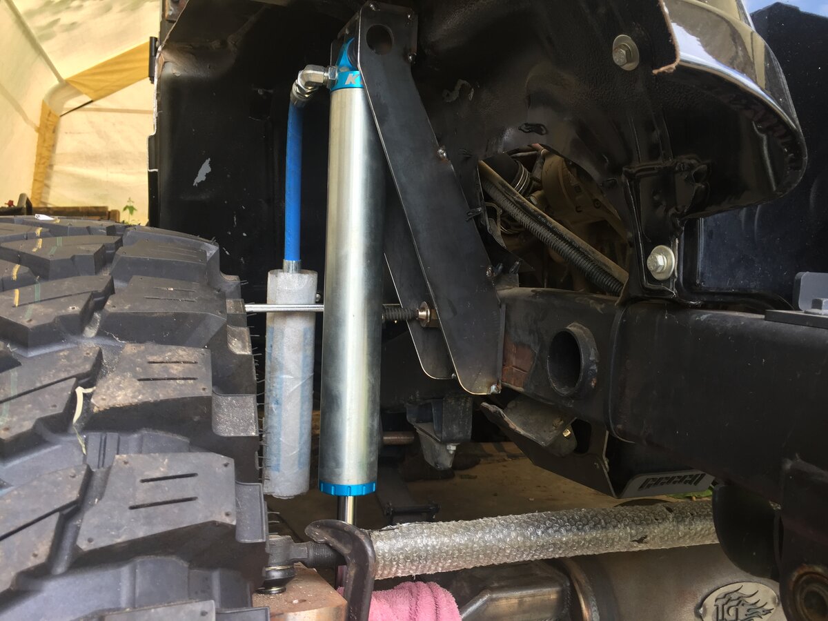

Has anyone attempted to make new shock mounts for the front end on the new body style roxors? Not sure how much this endeavor varies from the original body roxors or not

Ford shock towers are pretty universal. You’ll have to do some modifications I’m sure but it will get you close. Dorman 523-054.
My aftermarket shock towers only work on aftermarket axles unfortunately.

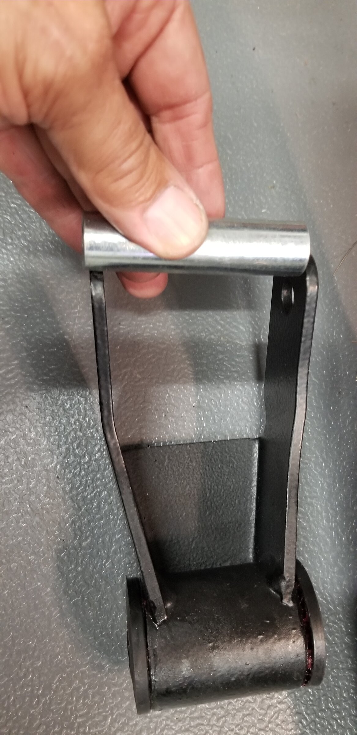

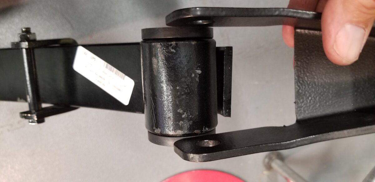

I have a question. Can someone offer advice who has installed the Max Anthony kit? RE: The front leaf spring hangers. I believe they are called Stone Brackets. They are 2.78" wide where springs mount. My spring bushing kit has 3" steel bushings and when rubber is installed in spring, it measures 3.01". So, do I have to cut down the bushing and try to compress the rubber? Do I have the wrong bushing kit? Thanks, looking forward to any advice.

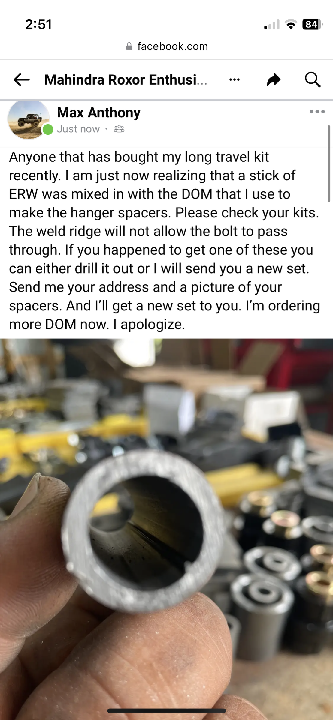

I've had 3 people recently not respond to emails that their kit was ready. They kits have been passed down the list. Keep an eye out people.
I'm moving in the right direction to have everyone on the wait list shipped by the end of the year!
