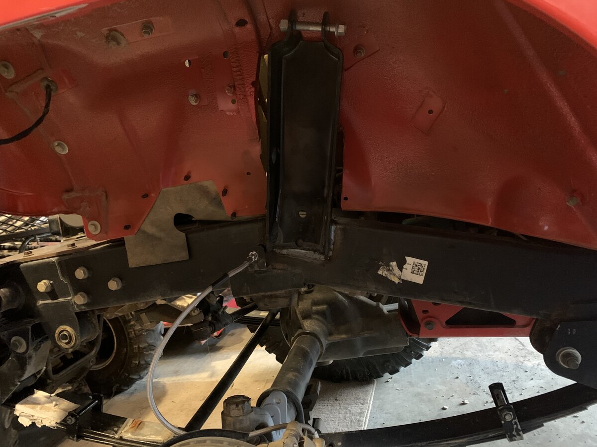

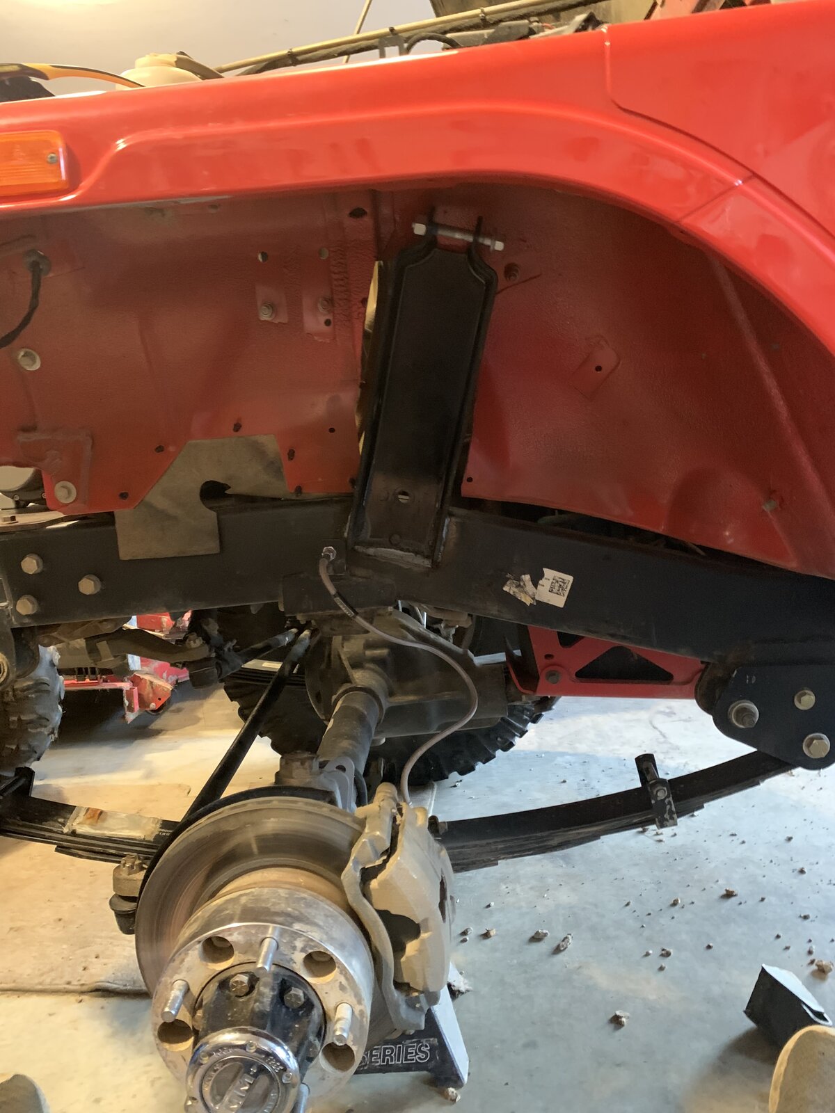

Did you get those compressed and extended lengths figured out. I am thinking of running 4 inch springs as well, but not sure about the shock length.

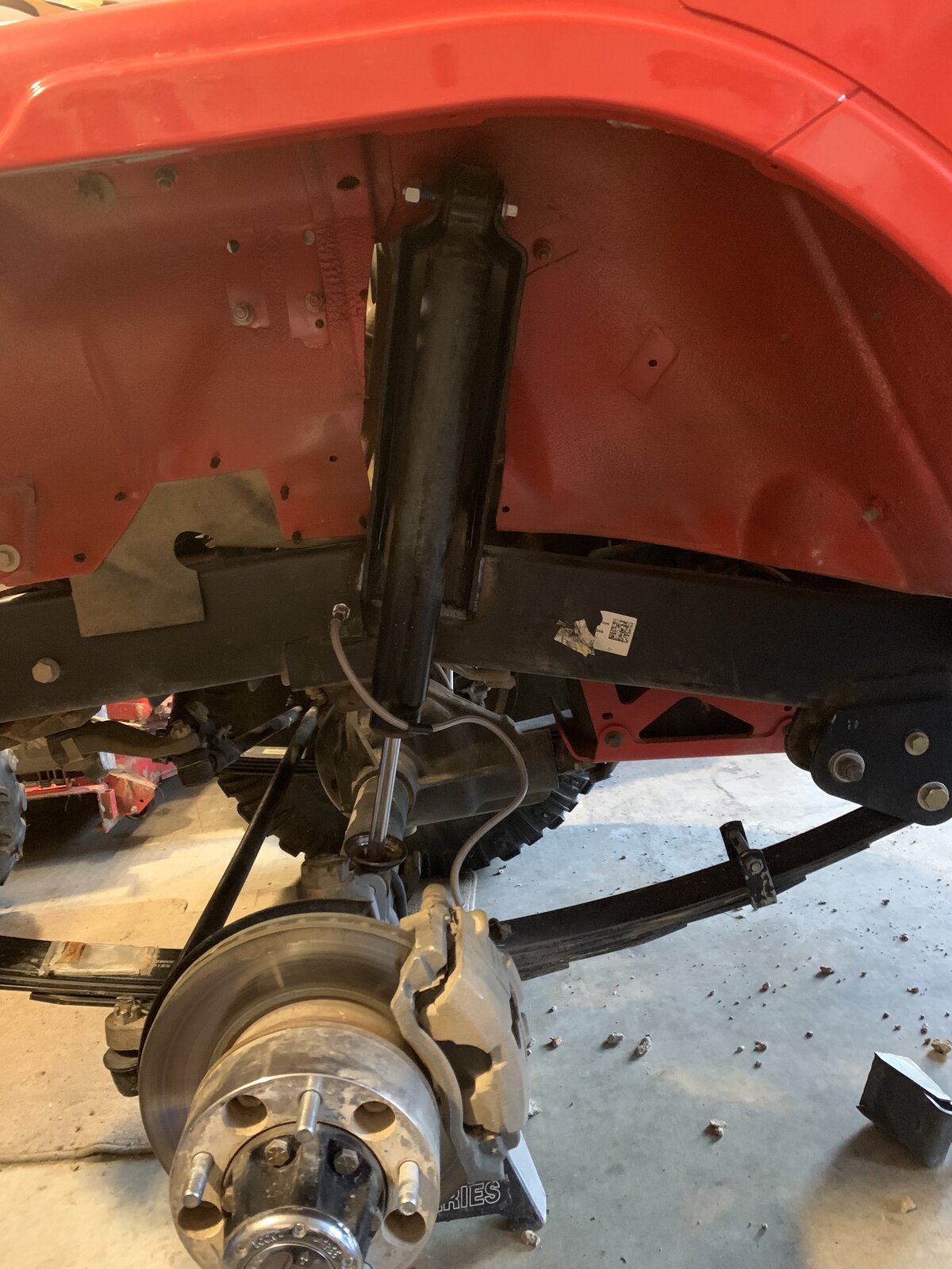

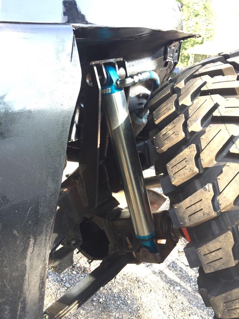

Man the stock shock location SUCKS. I went ahead and installed ford shock towers and 12" travel shocks up front. Rear i have stock Z-71 rear shocks out back they are a about 8" travel. A 10" out back is about all you will need cause they are inboard so much.
Take any pictures of the shock tower install?
796
From which truck? What year? Need pictures .
796
Nice. Simple bolt on. I have a set of Dana 60s that are going under this winter. I'll have to do this shock tower.

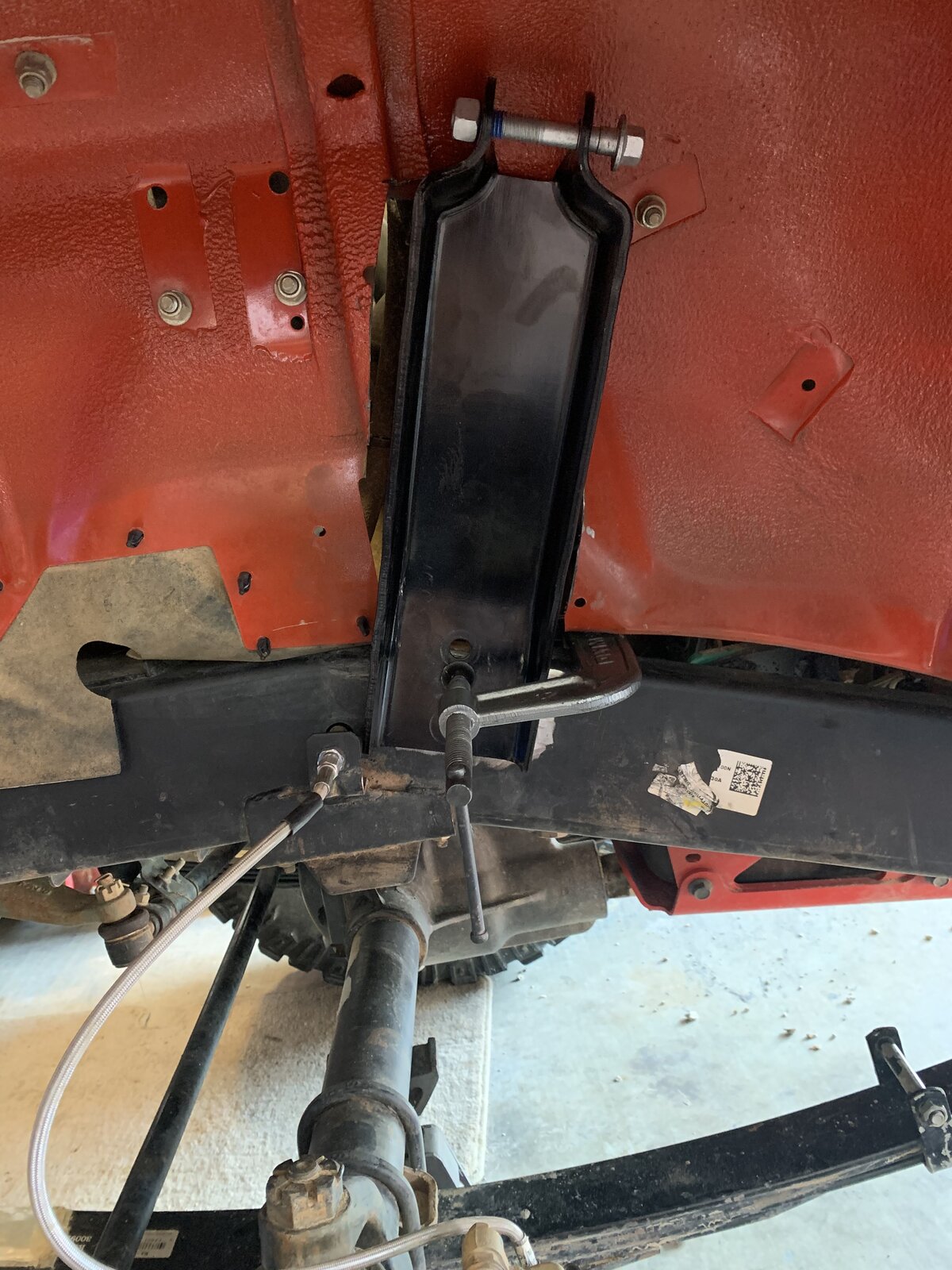

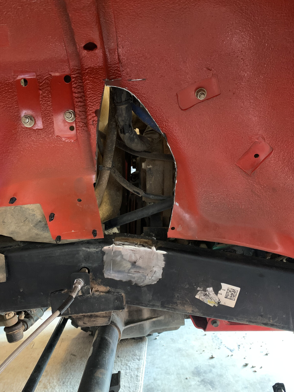

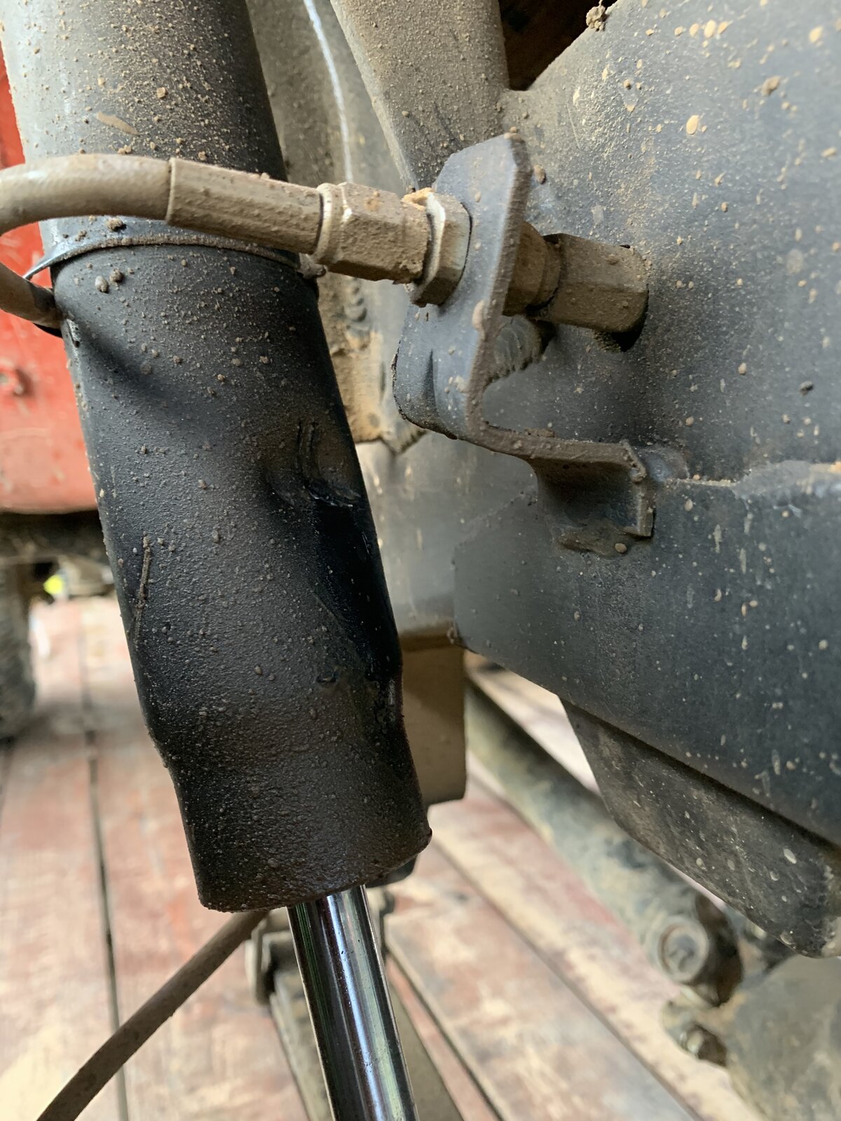

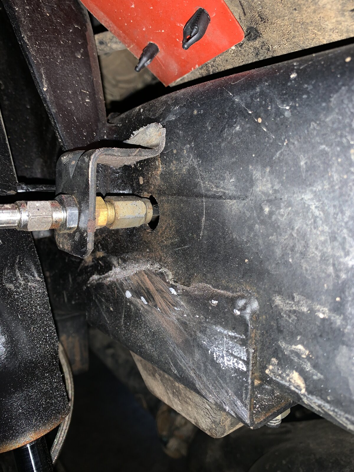

Be aware that you will hit the shock body with the stick brake line bracket. So I’m relocating it you can see I cut the bracket just haven’t gotten to see where to reweld it back

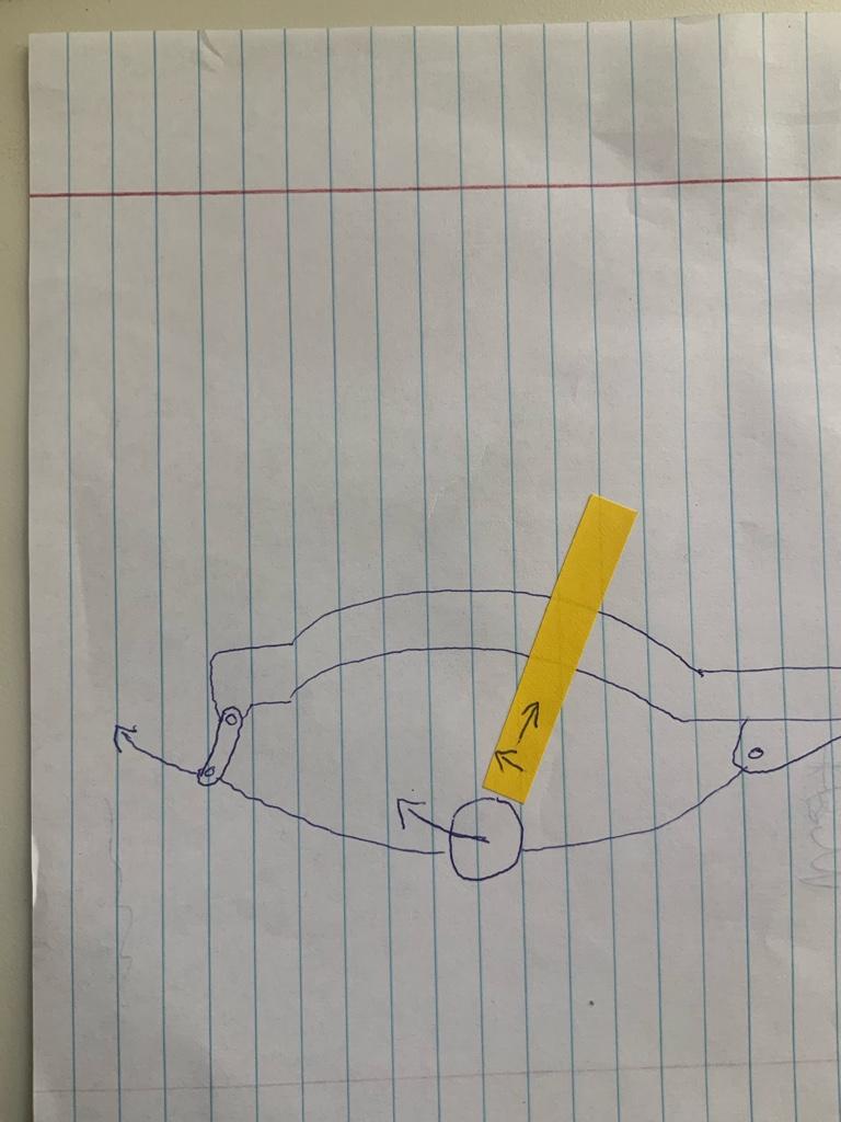

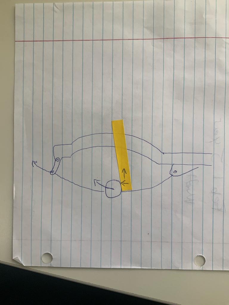

If your going through all that work you shouldn’t mount your shocks on the top of the axle. Keep your axle mount low and to the front or back of the axle. Shock placement on the axle will affect ride quality and axle wrap.

Ideally you want your shocks to be mounted in such a way that they are staying as close to vertical throughout the axle path.
When your shocks lean away from the axle path your compression rate softens later in the travel making the suspension bottom harder.
you should split the difference so that your compression rate stays as static as possible.
It should look like this at full droop. Vertical at ride height and slightly leaned back at full compression.
