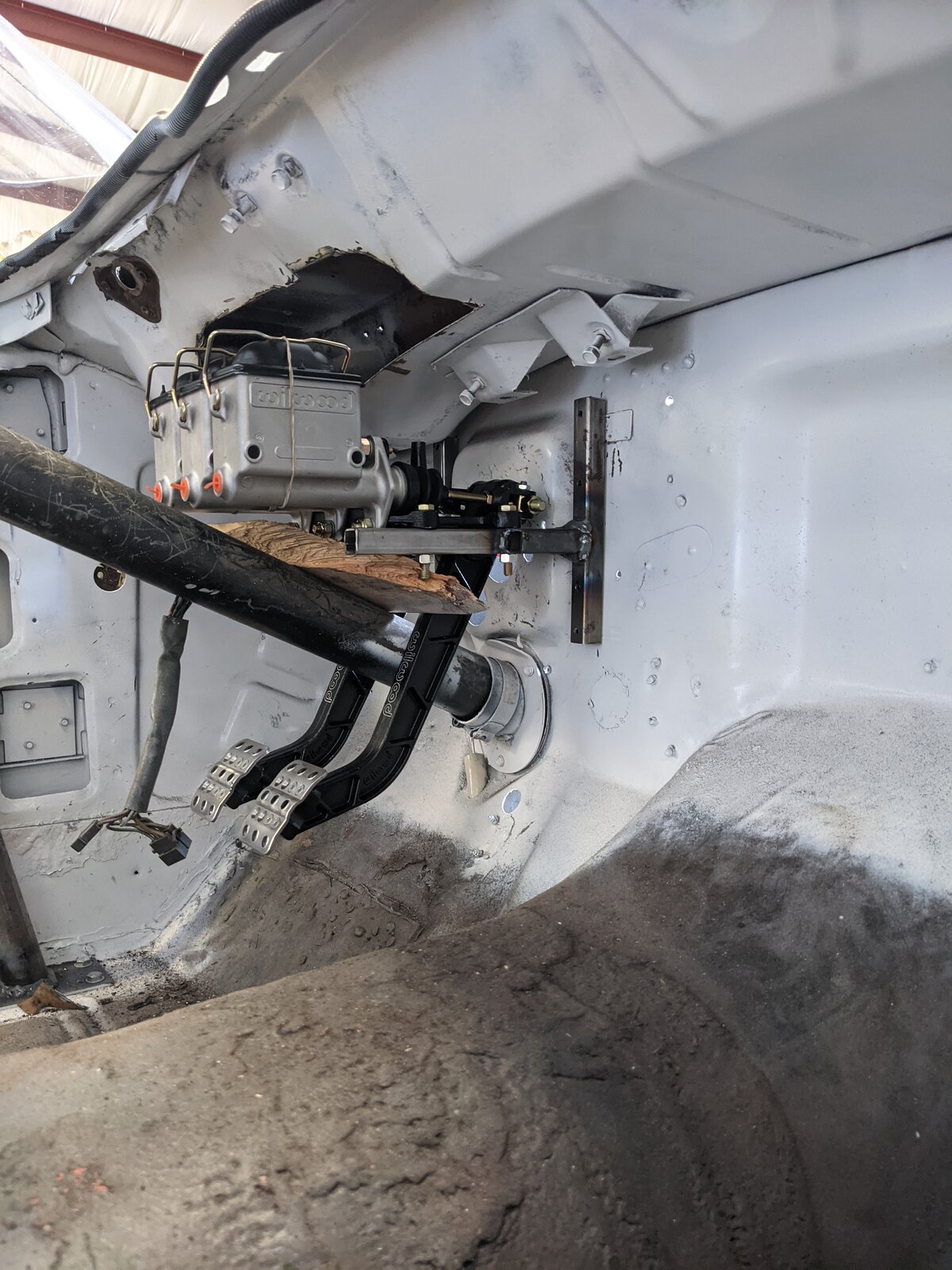

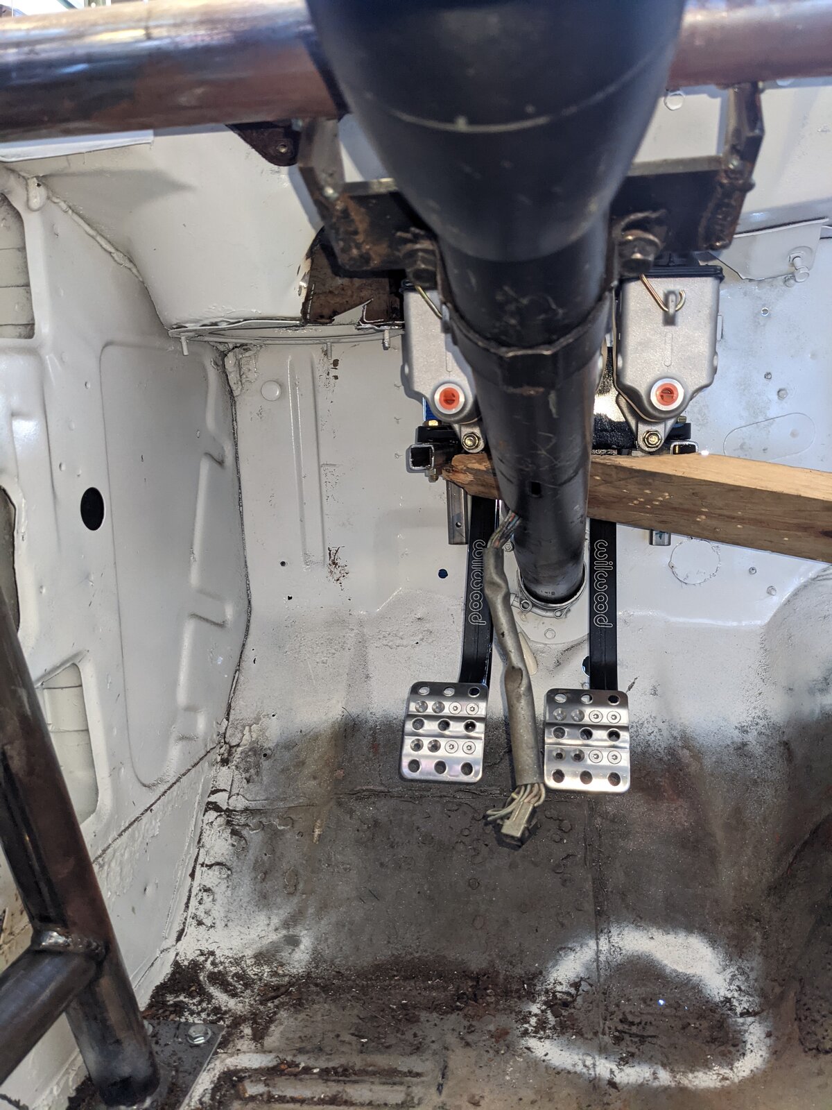

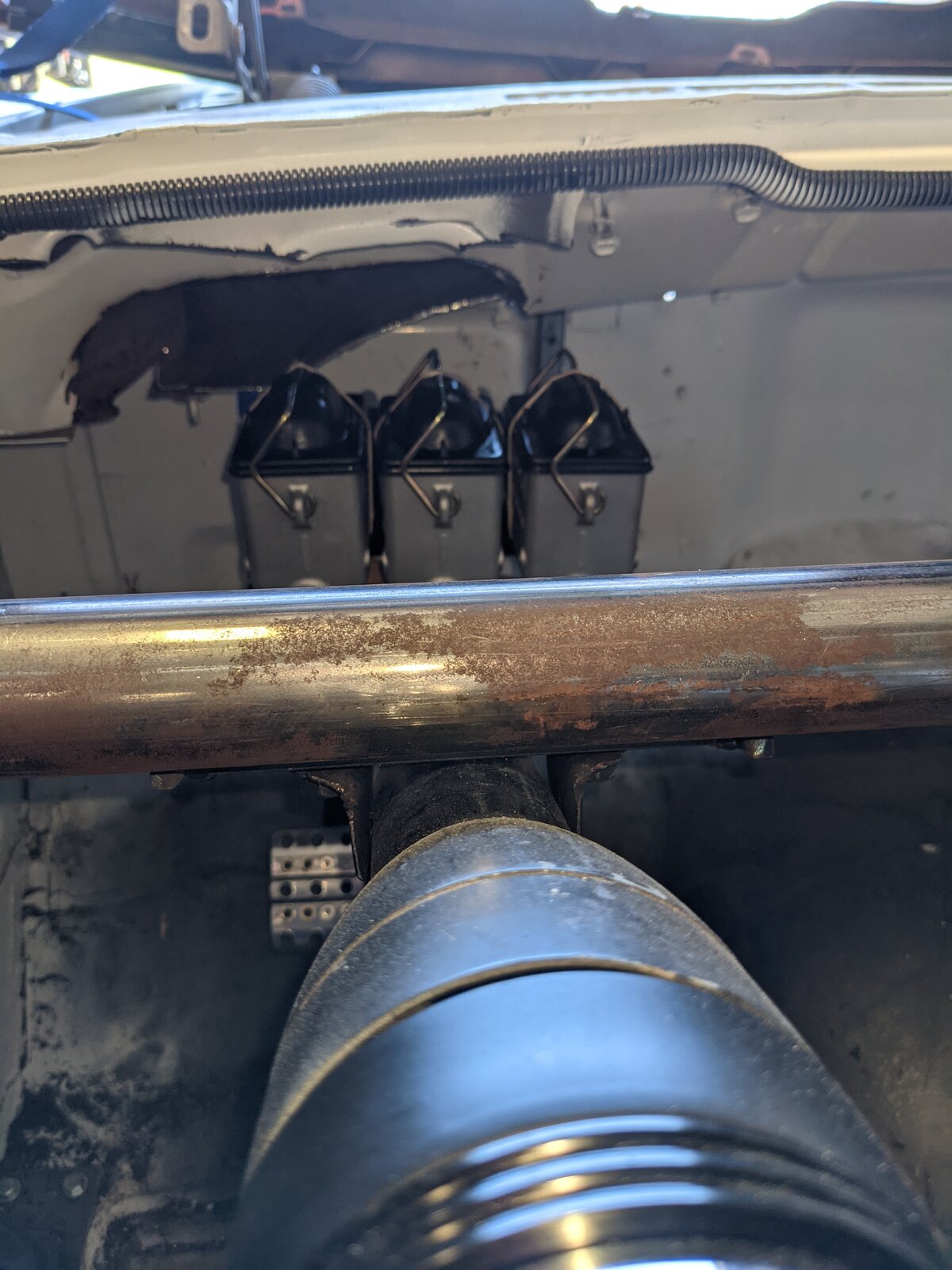

Started the brake pedal / clutch assy install. All master cylinders will be inside car. Engine compartment is only gonna have a motor and radiator. All the electronics will be inside the car as well.

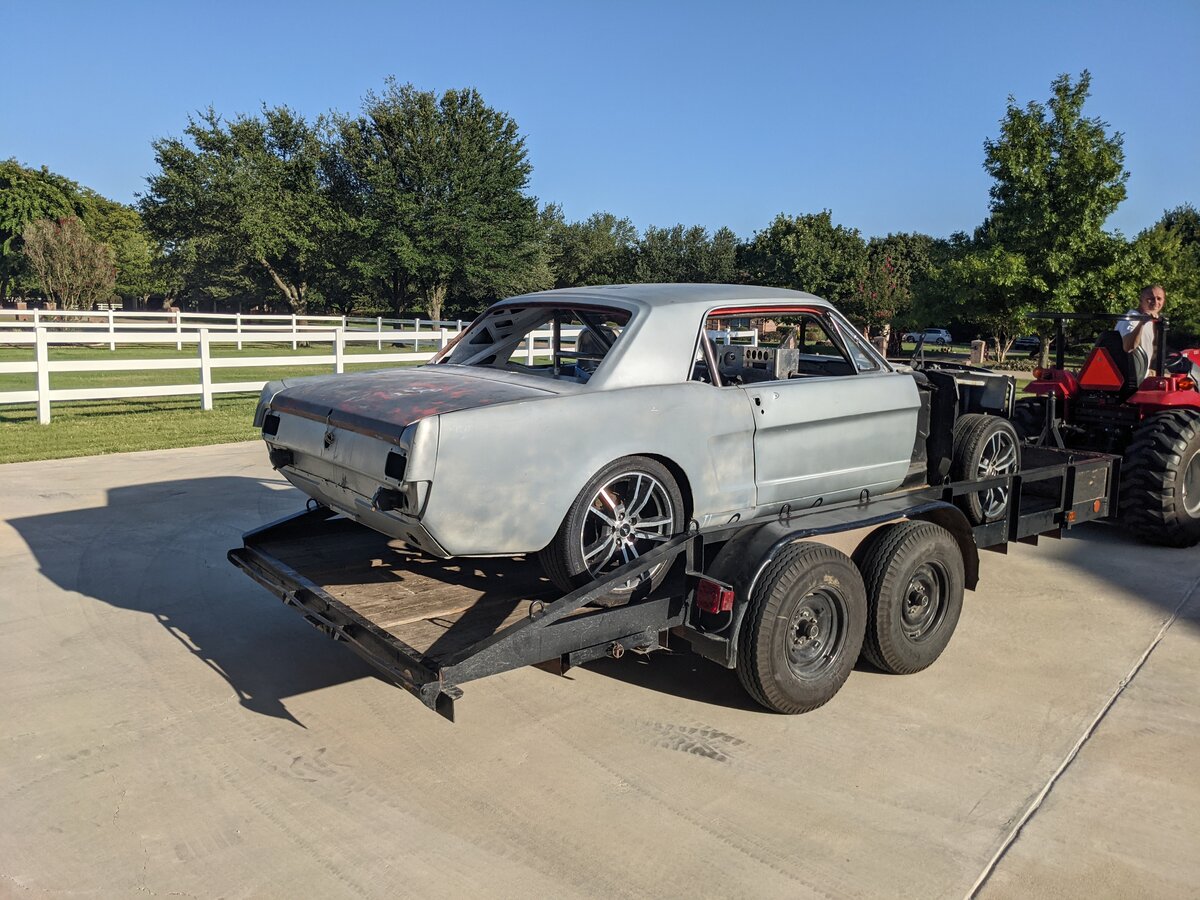

I have a meeting tommarra with local police detective to get the VIN authenticated. The guy I bought it from had to use a title search company. They got tags and clear title. We then got it in my name here. Title comes in mail and it is missing a digit. Great! Long story short. I gotta get it verified that it ain't stolen. I'm not worried, I did a VIN search on line and it clear and never been on a total lose list.
So before loading it on a trailer tonight, I spent a few hours and made the dash back panel, drilled it on, tapped the holes and then dimple so holes in it for effect. Lol. Steam punk! Lol.

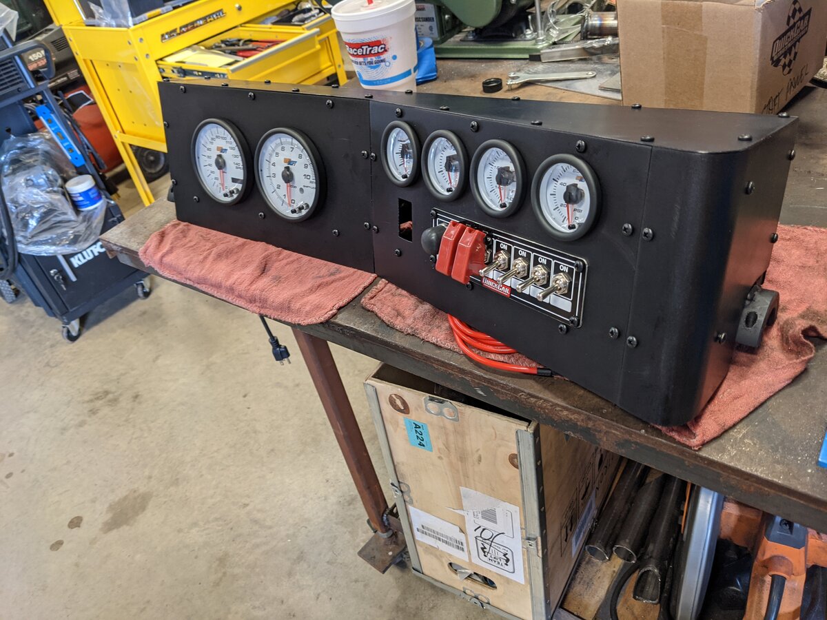

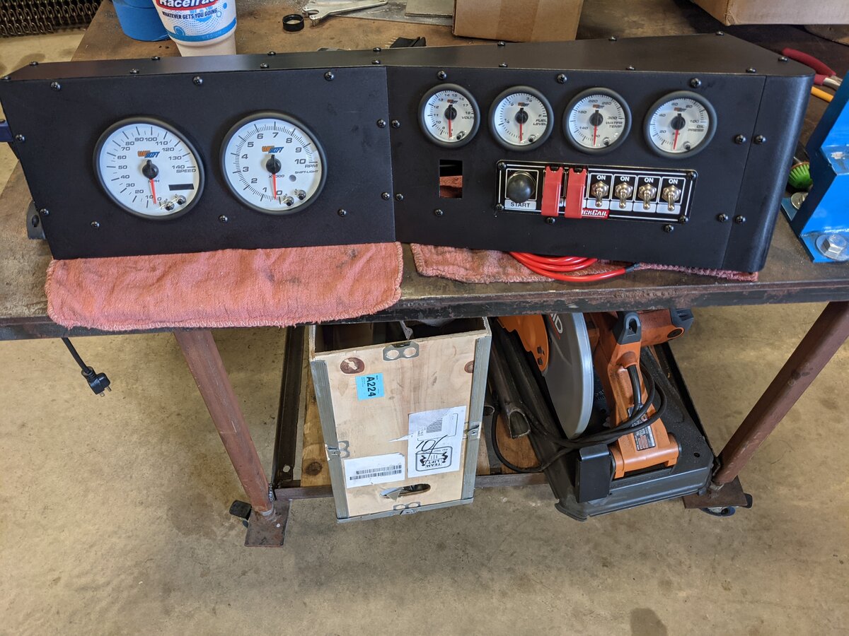

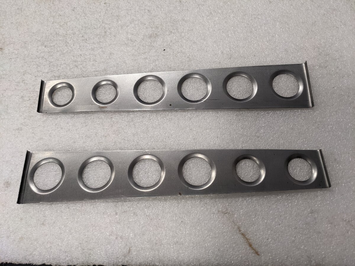

I took the dash pod panels by the platers that I used to use when I had a job and got the girl to run them through for me same day turn. Black anodize. I jitterbugged them with 220 so I would have a flat look. Got that all assembled, popped the gauges in it just to see what it was going to look like. Think it looks cool!

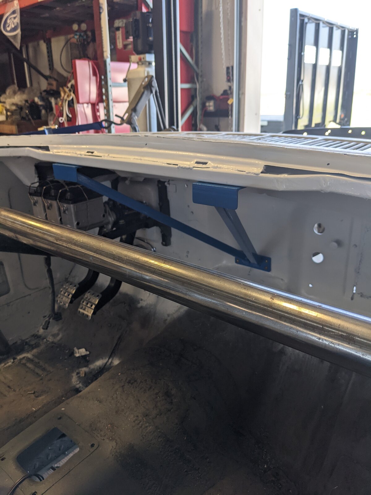

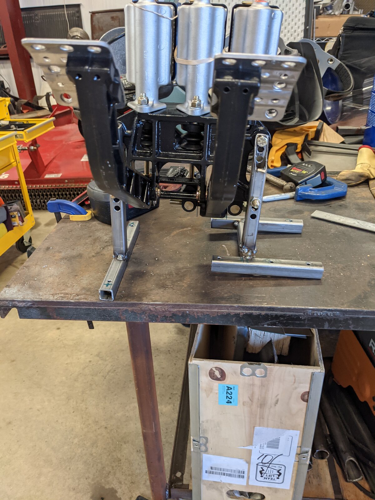

Did my final brake assy mounts. Built some 3/4 x 3/4 L angle stiffeners for opposite side of fire wall. Welded nuts to the angle for installation ease.

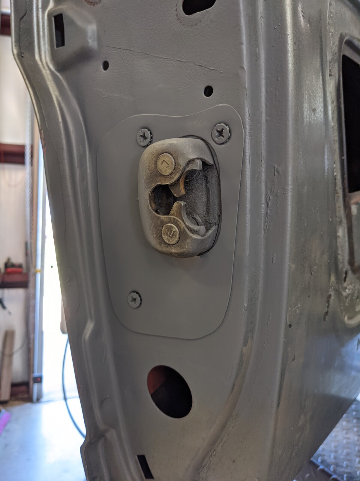

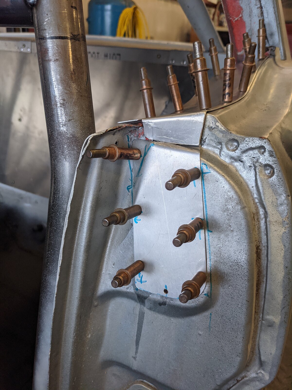

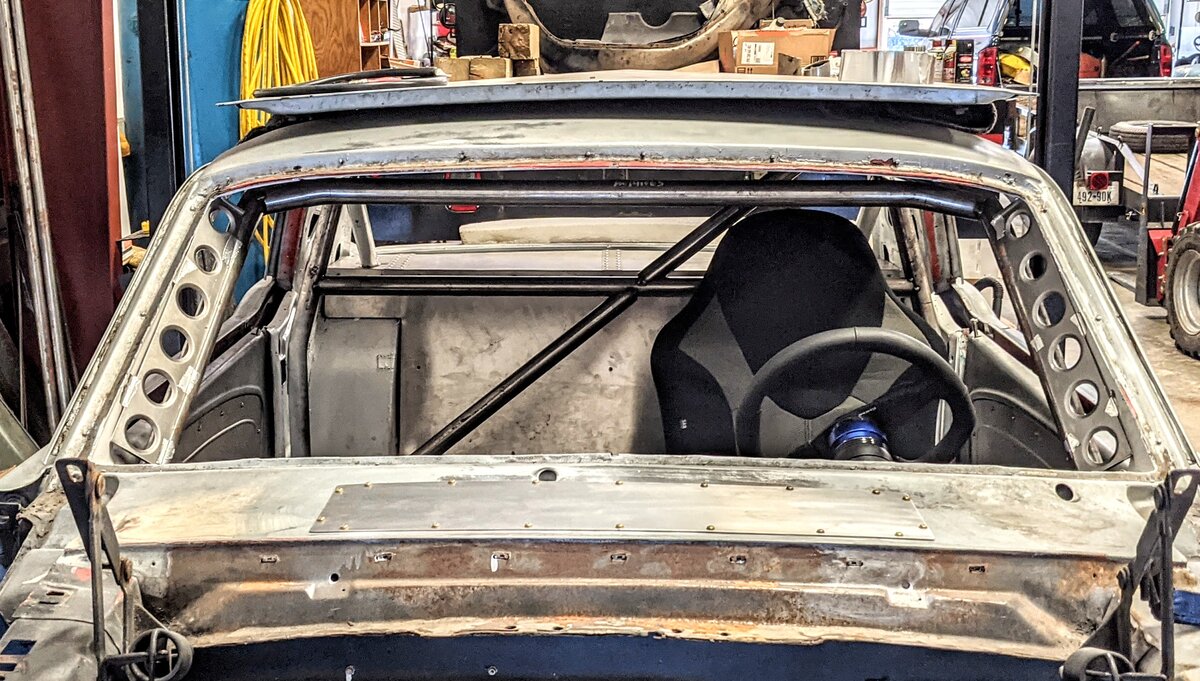

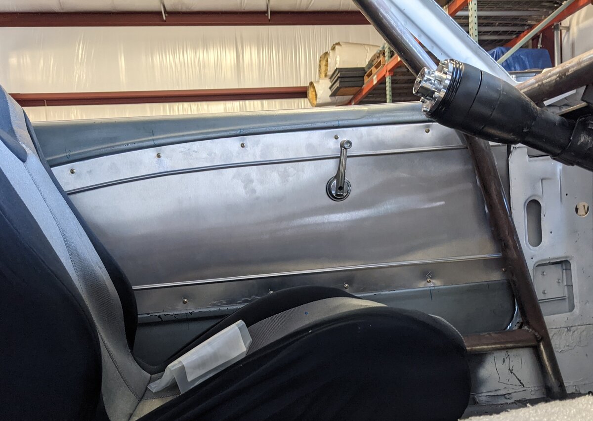

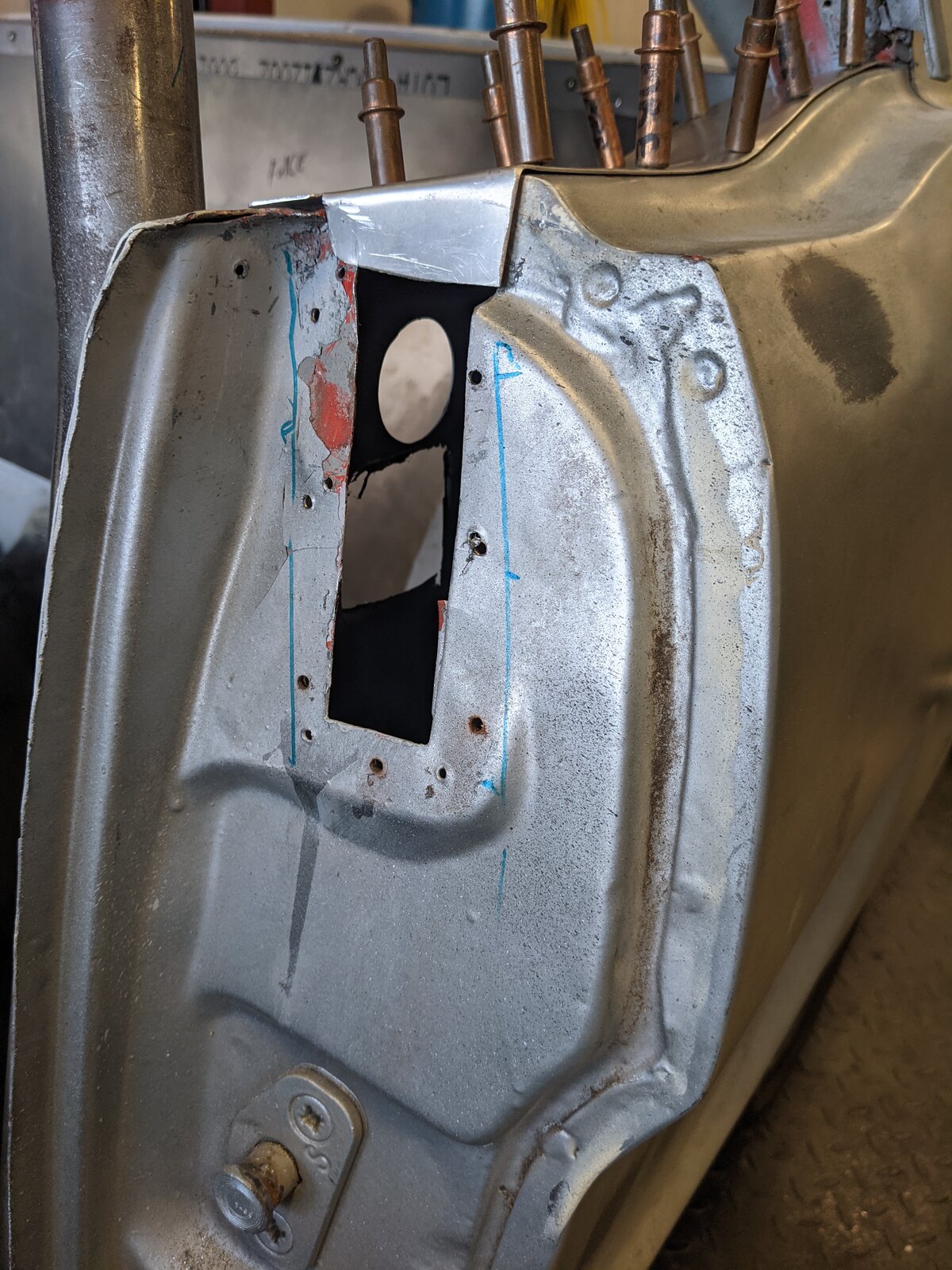

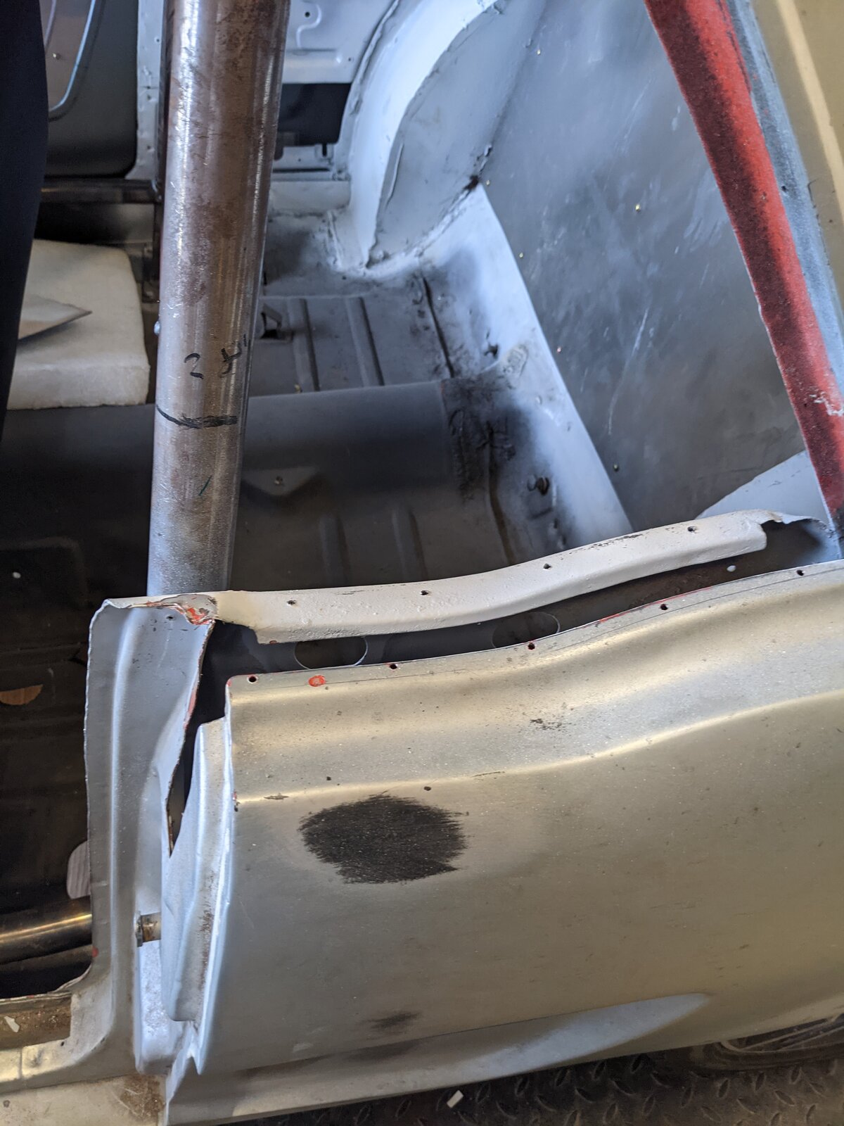

Gutted the doors. No more windows. Shaved about 75 lbs. Off. Repaired the cracks around the door latch screw area. Welded and then made and installed a doubler.

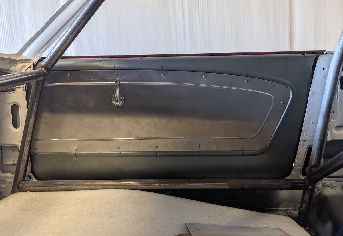

Got my inner aluminum door panels fit and installed. Re-pops of the 1965-66 350GT R.

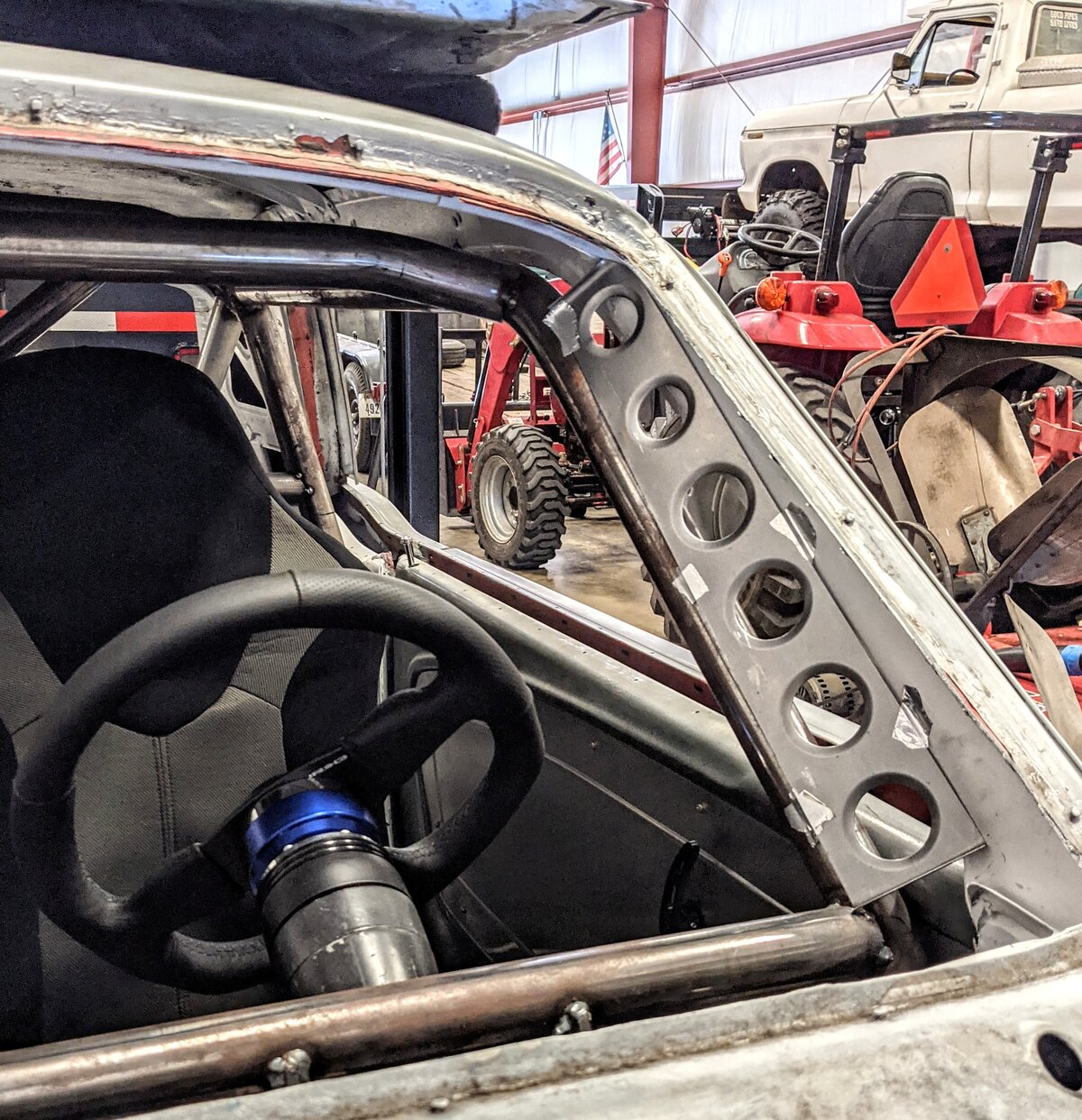

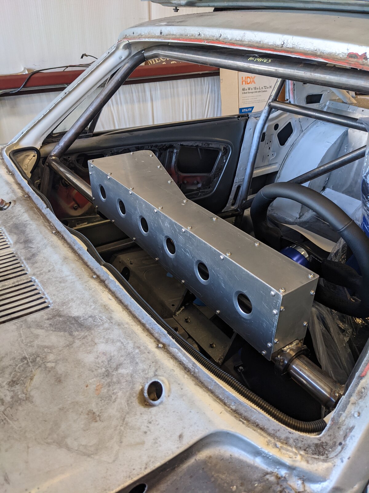

Started the closeouts to cover over the gigantic gaps left by removing the side glass.

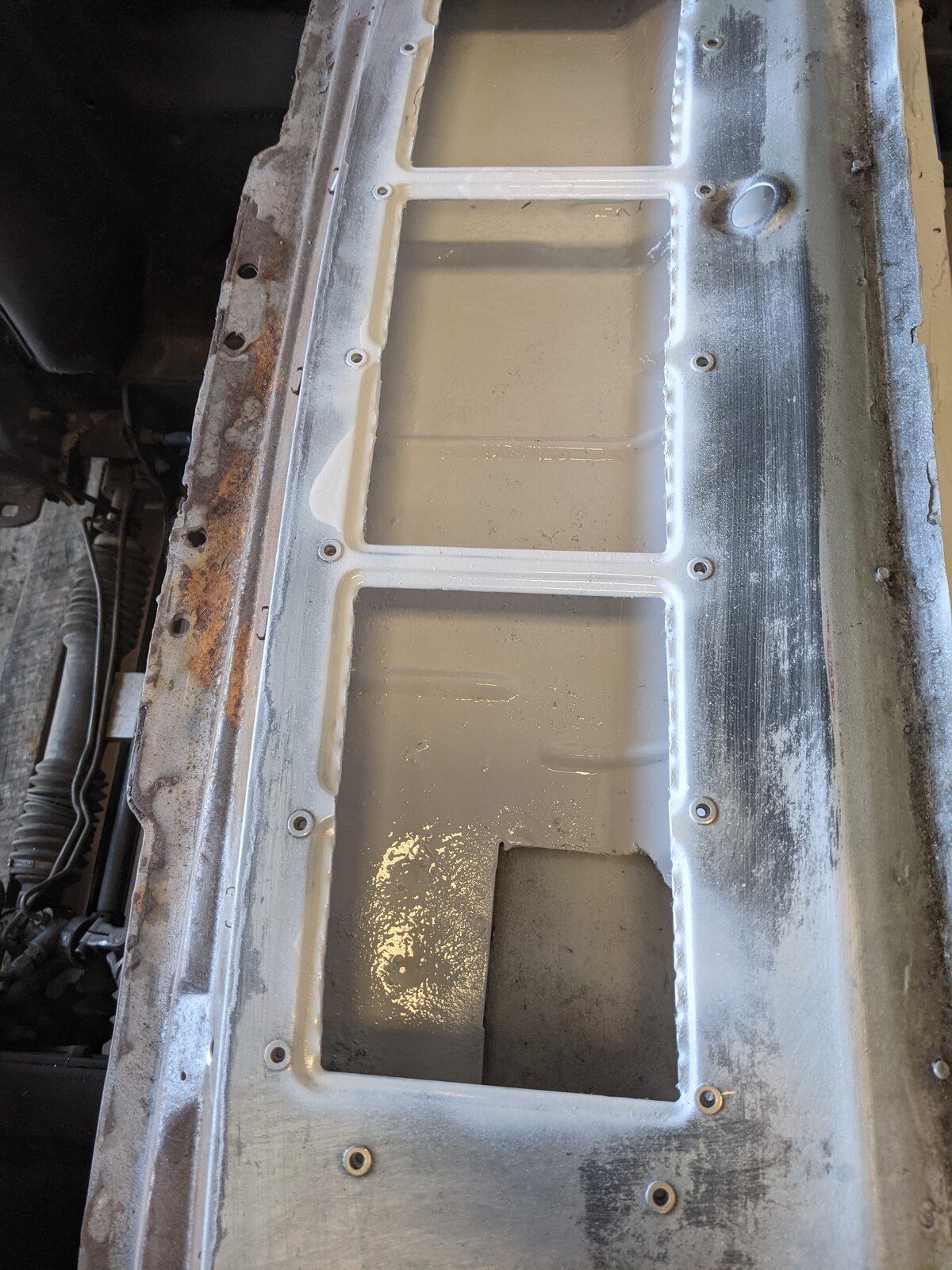

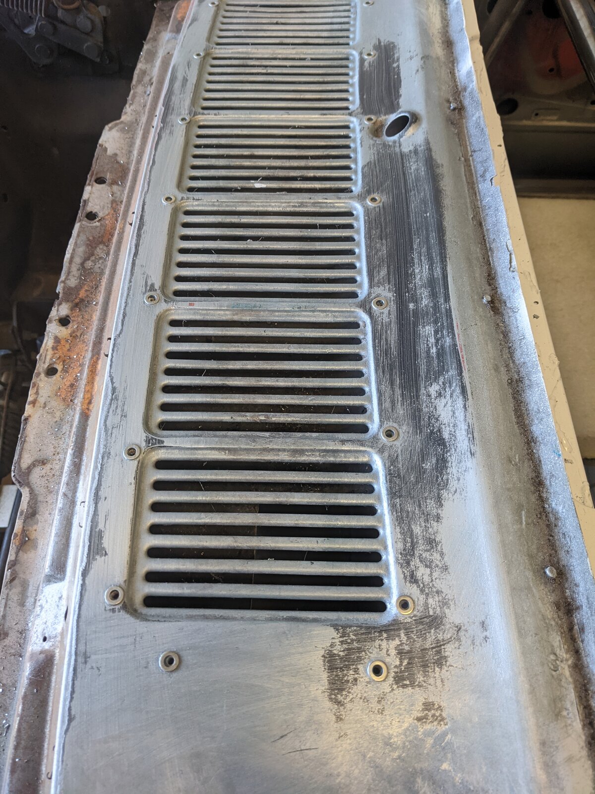

Also got the cowl closeout panel built and installed. Cut out all the grates to access down inside the cowl to clean out 55 years of crap and clean up the rust and paint.

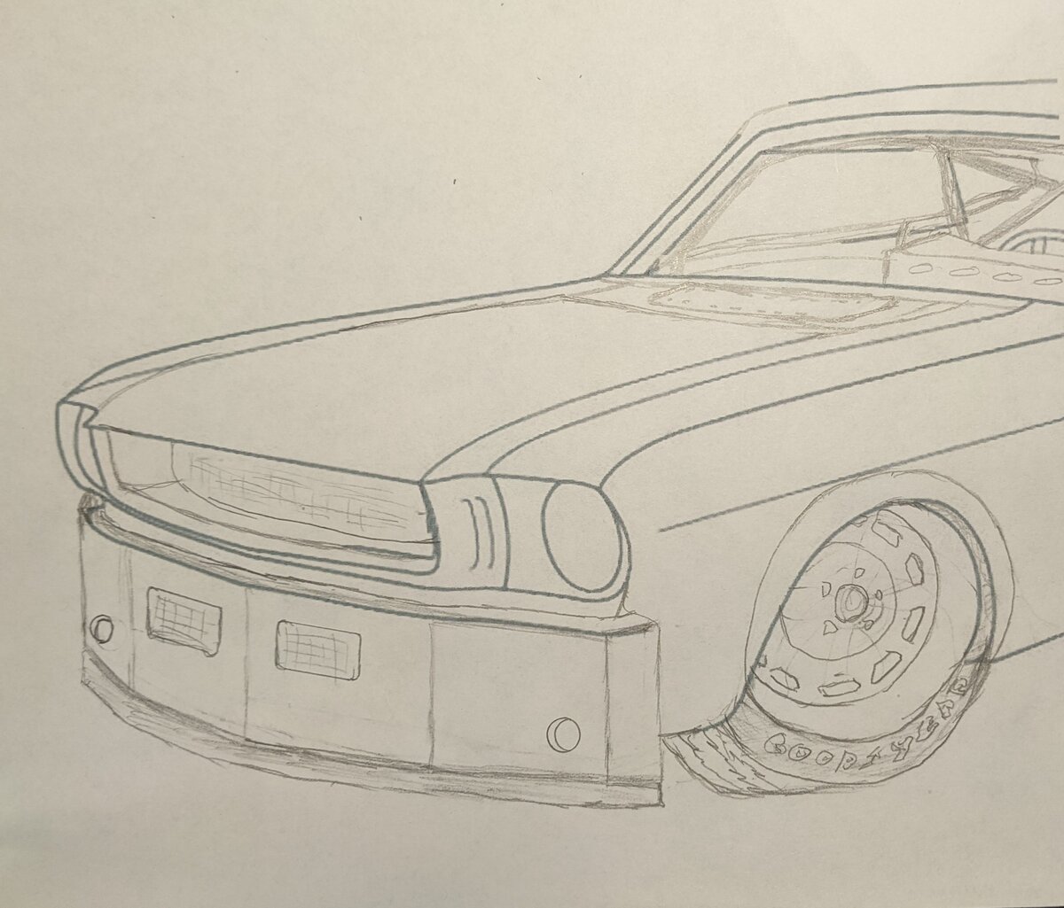

Thinking of fabricating an old school IMSA style air dam of yester year. Sketch.

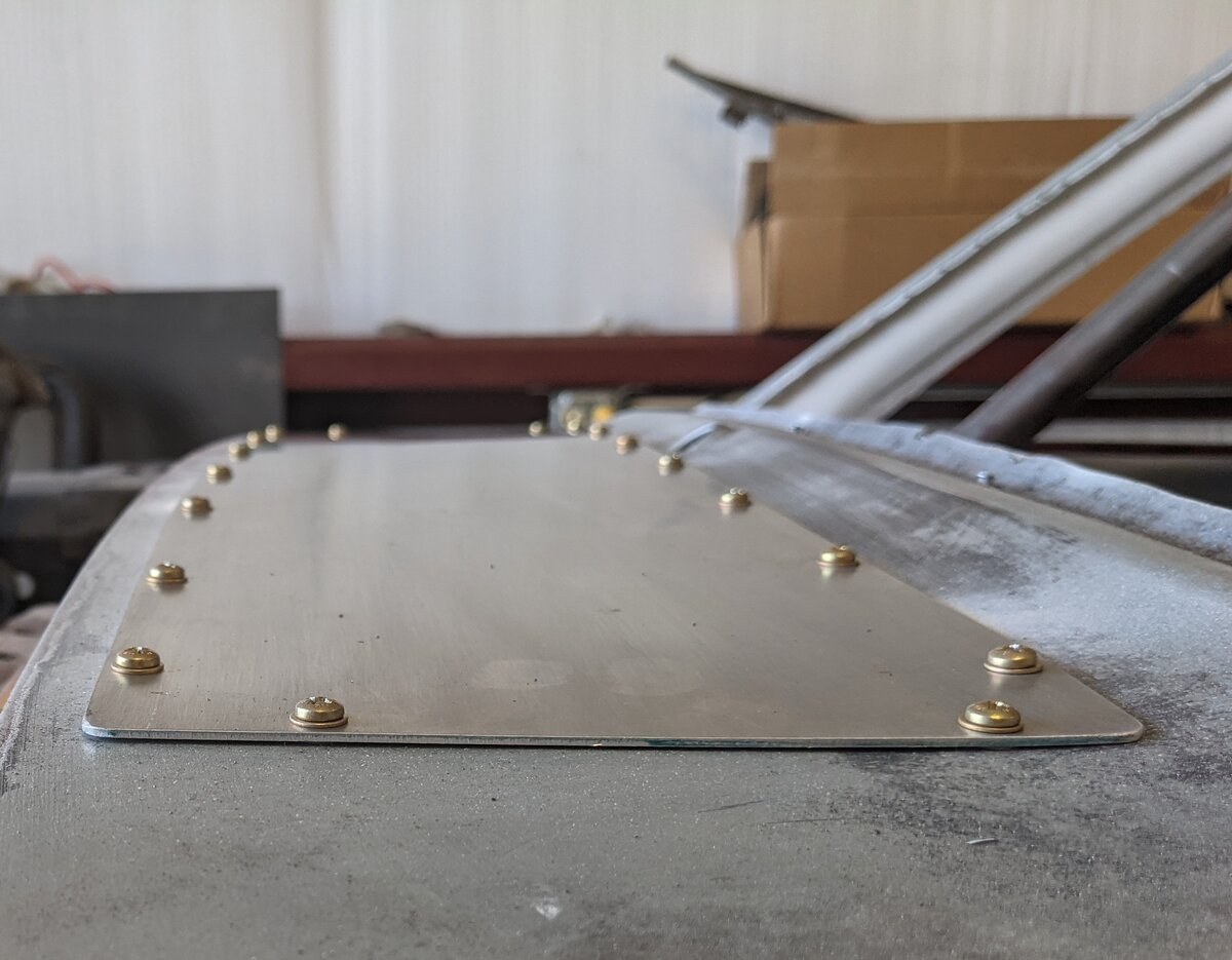

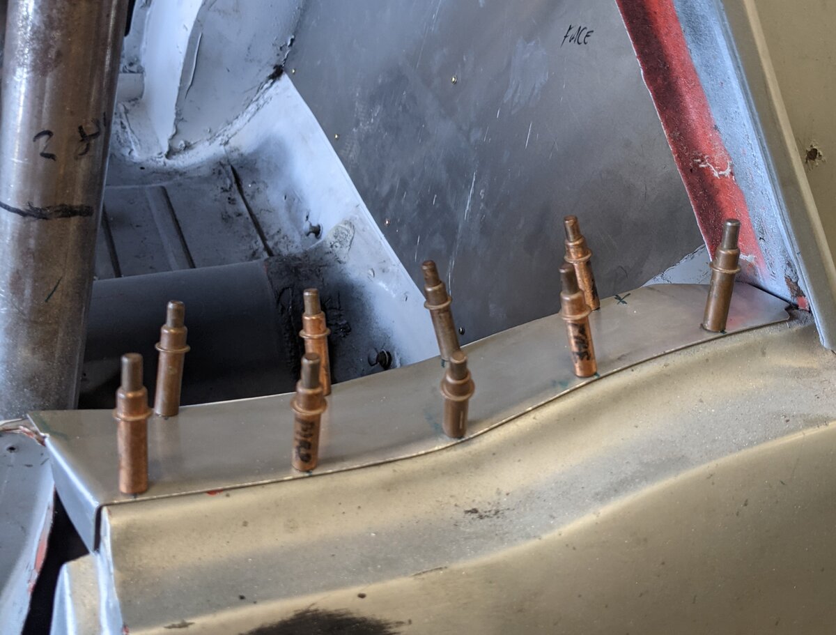

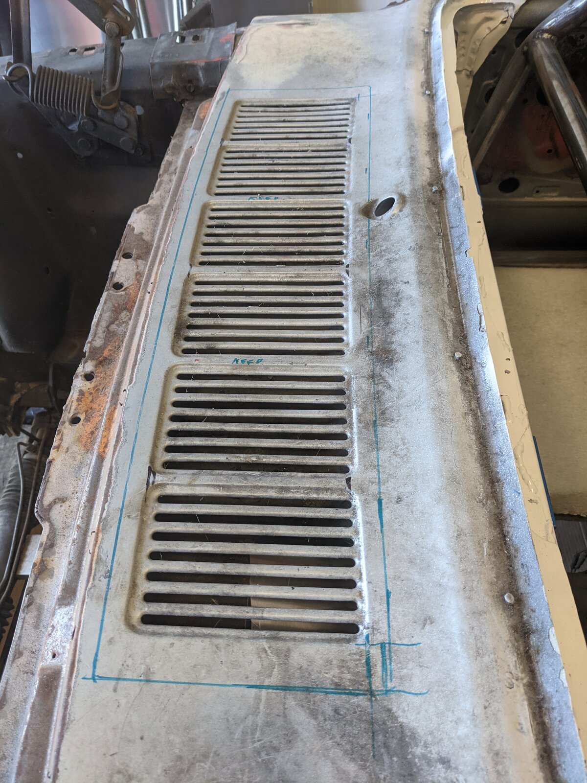

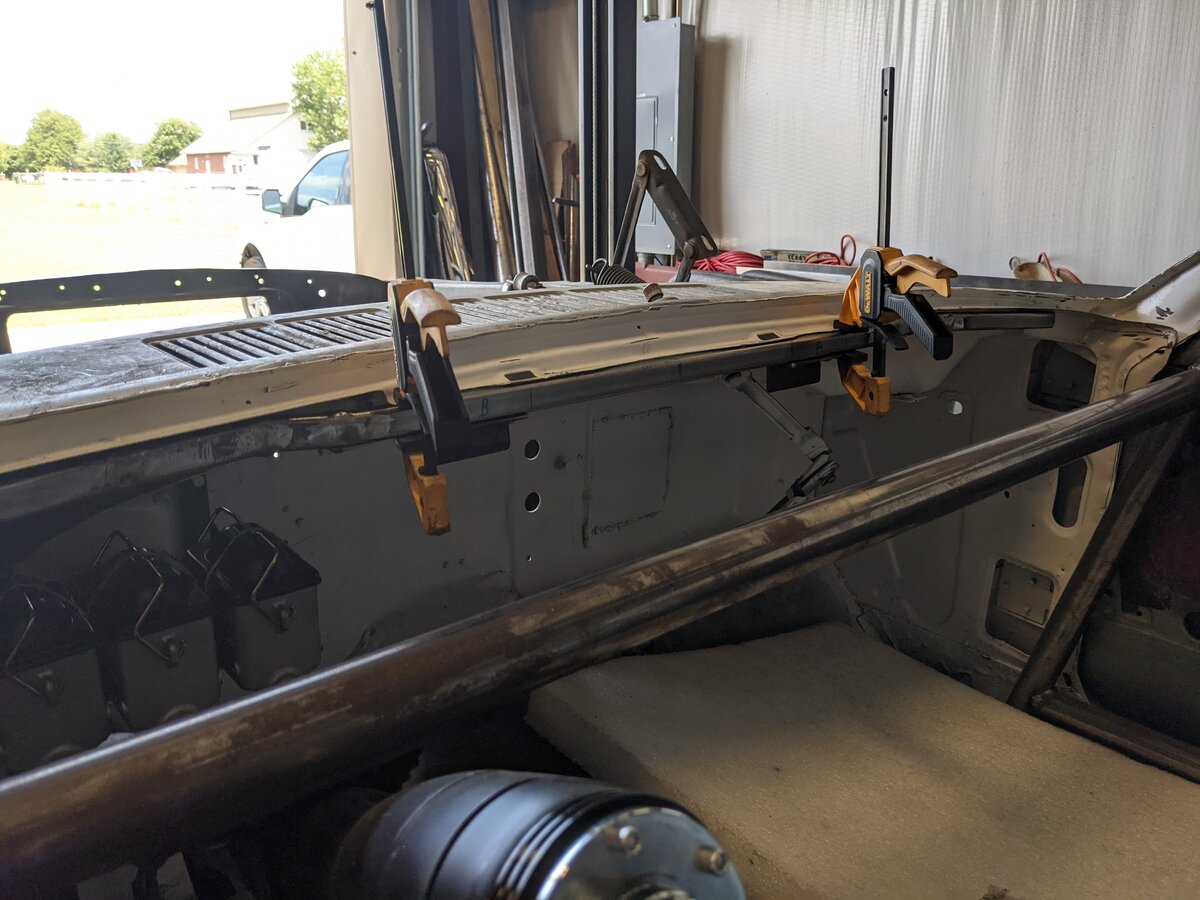

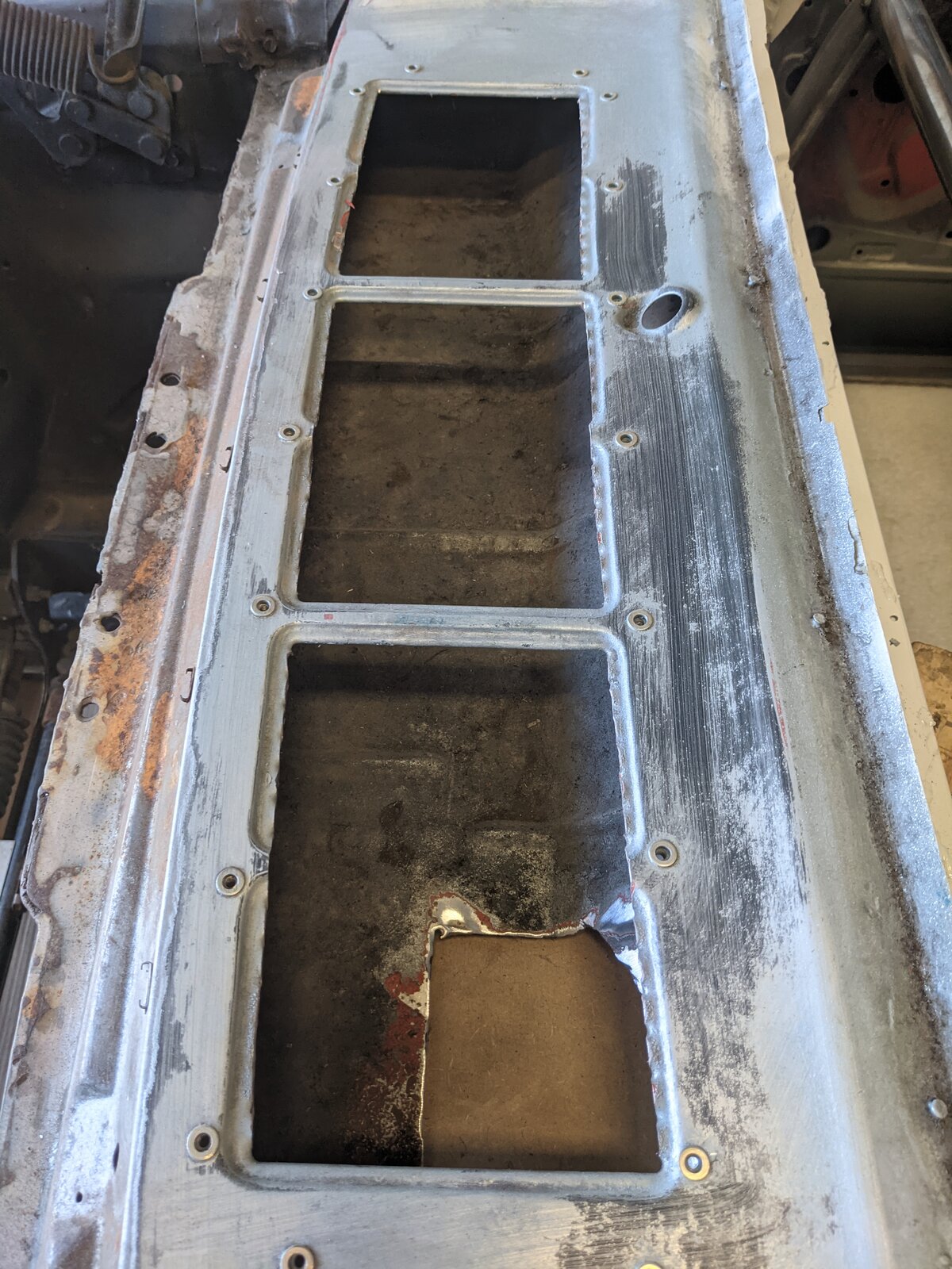

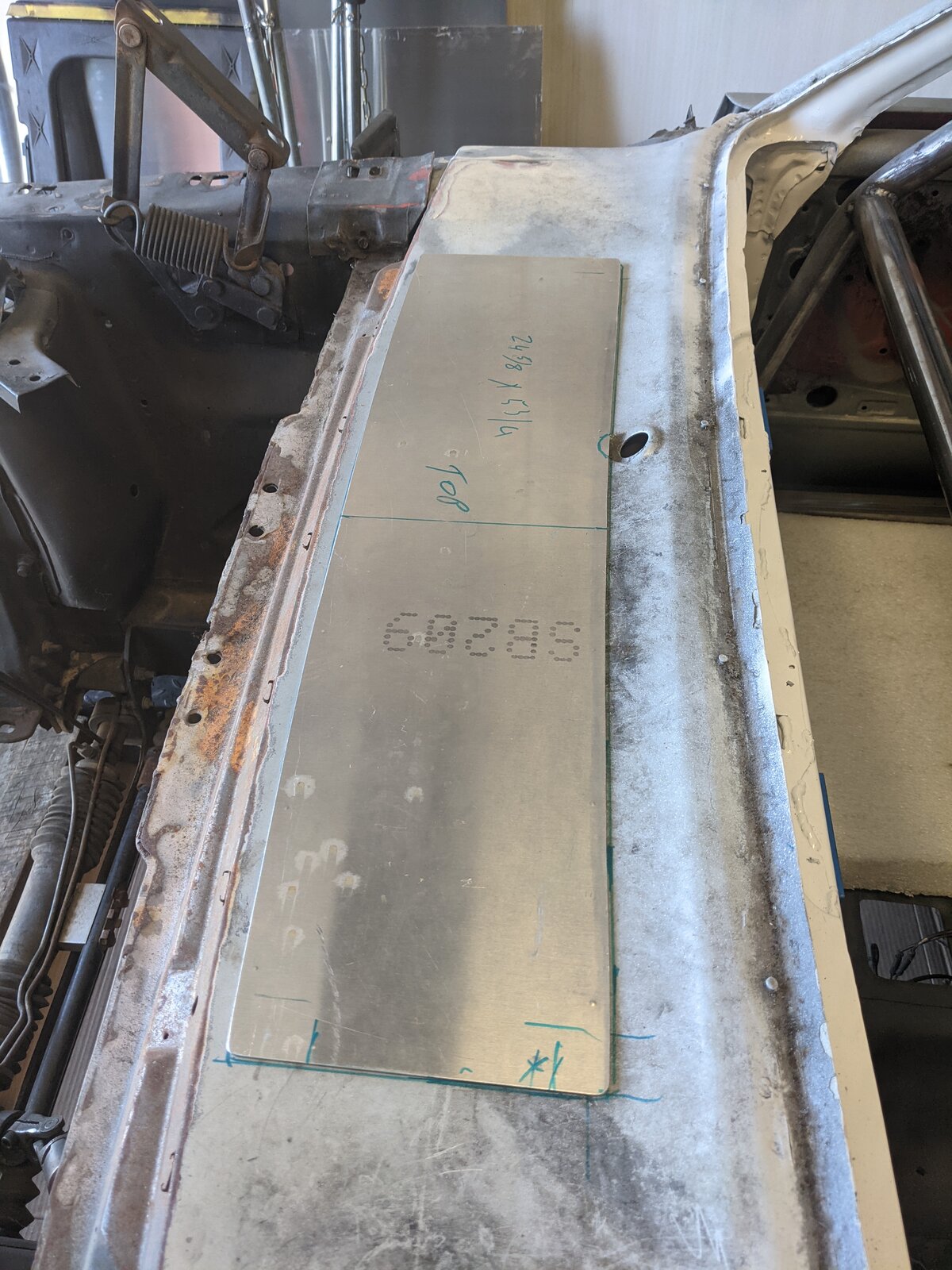

Cut open cowl to access all the 55 years if grunge and rust. Started out and layed out where I was going to cover the opening with a closeout panel. Fabricated the panel, layered out my fastener pattern. Drilled the panel and then drilled it to cowl. Drilled up the holes and added threaded inserts.
After all that I cut out all the ribs except the two main ribs. Then sucked out all the crap, sanded and painted all the cowl insides. Then attached cowl closeout. Just that took 4 damn hours!

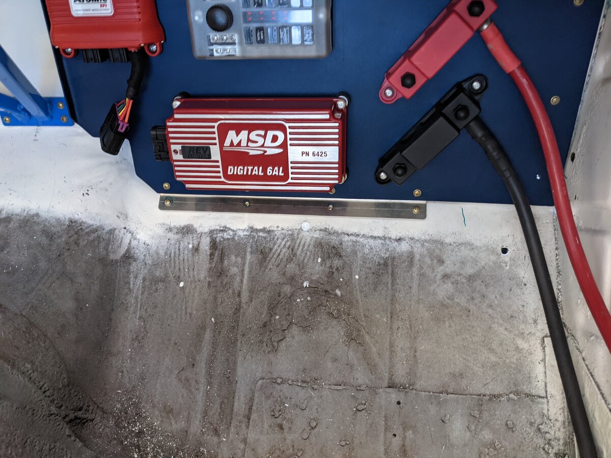

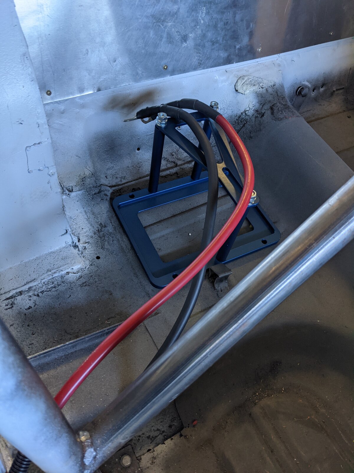

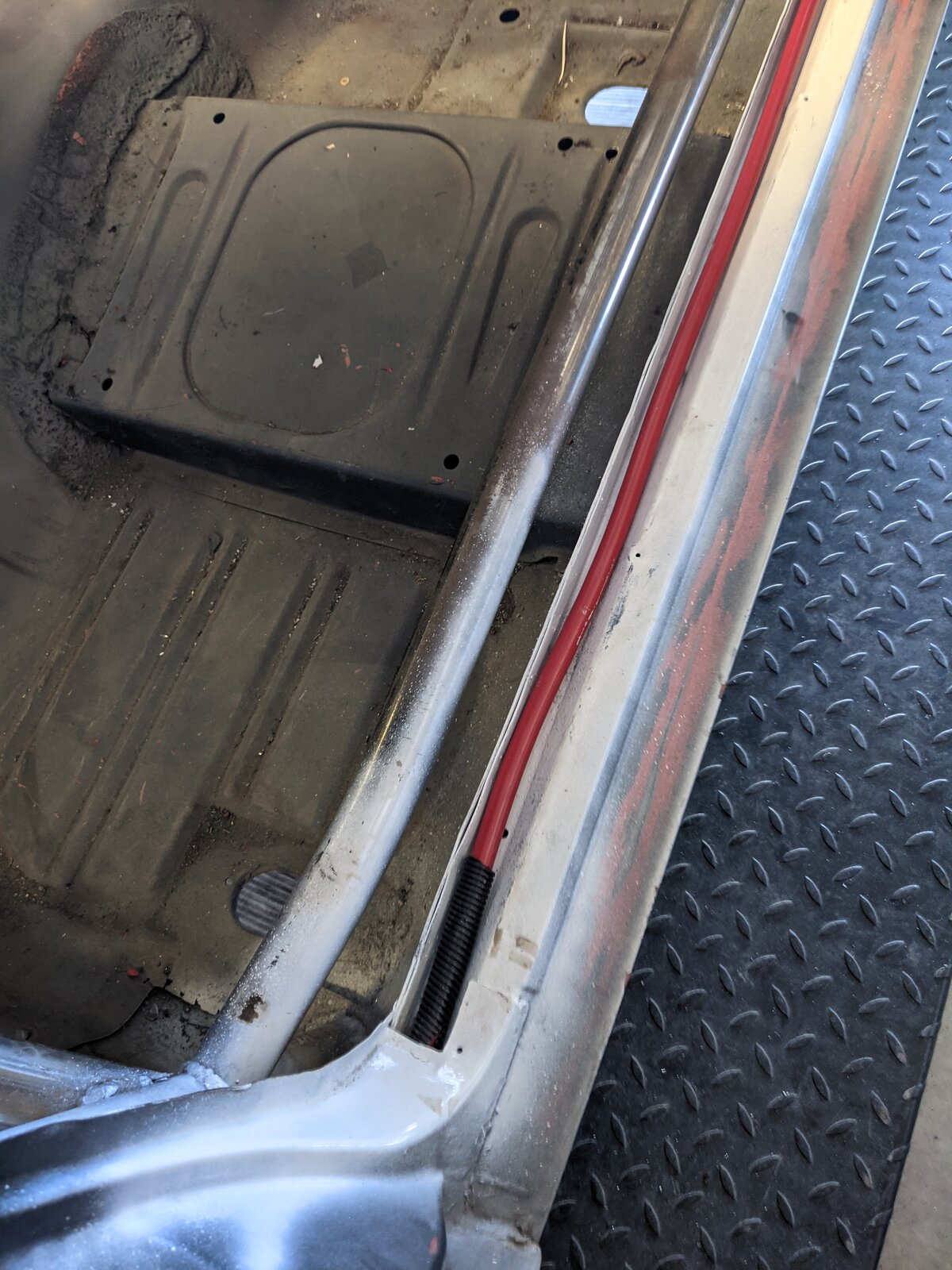

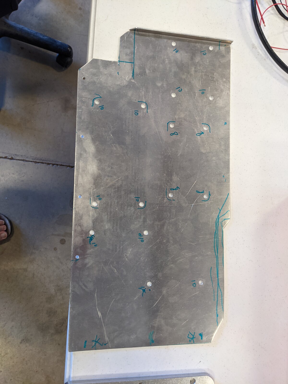

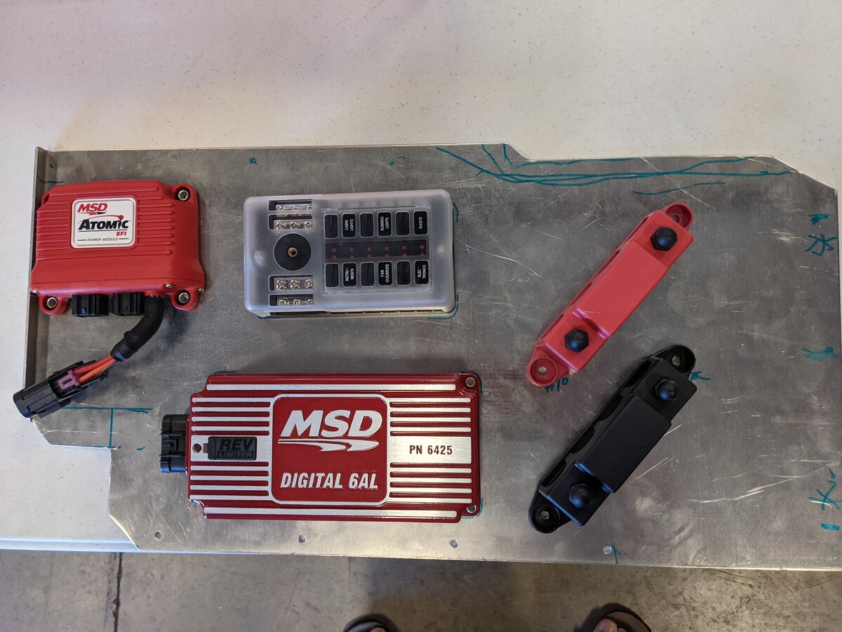

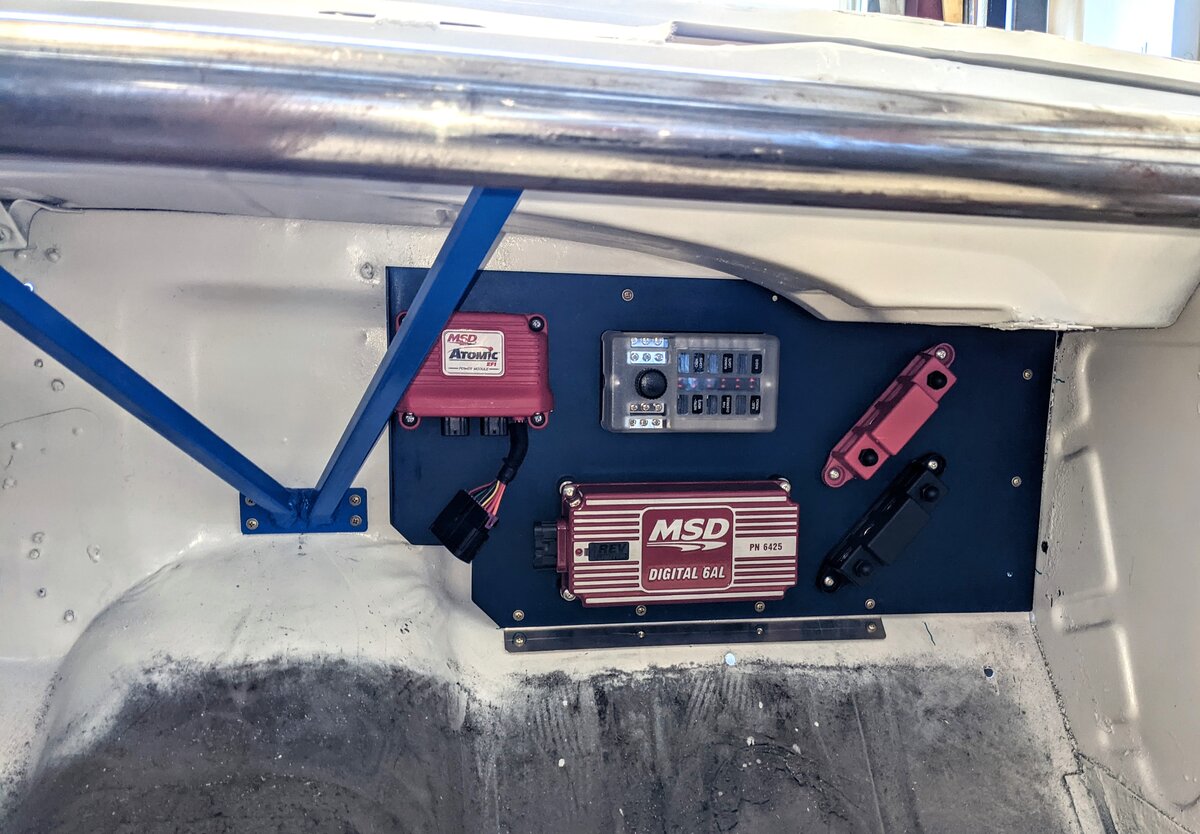

Got my engine and power panel done and installed today. Located where my battery hold down will be and ran my 0 awg wires for it. Plan on using the roll cage as part of my negative wire circuit.
I still look in on you and your Crazy build bubba?
It sucks to have sacrificed my Roxor for this project but I will use the Mustang much more than I would the Roxor. Plus my buddy Mike moved to Texas for his wife's health and don't have an in in Colorado.

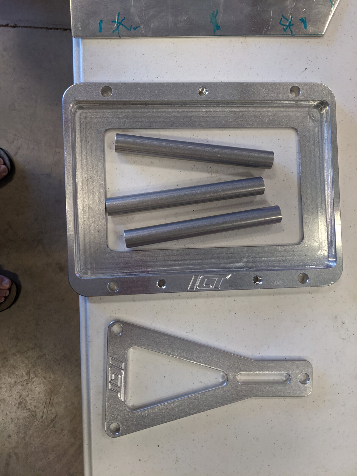

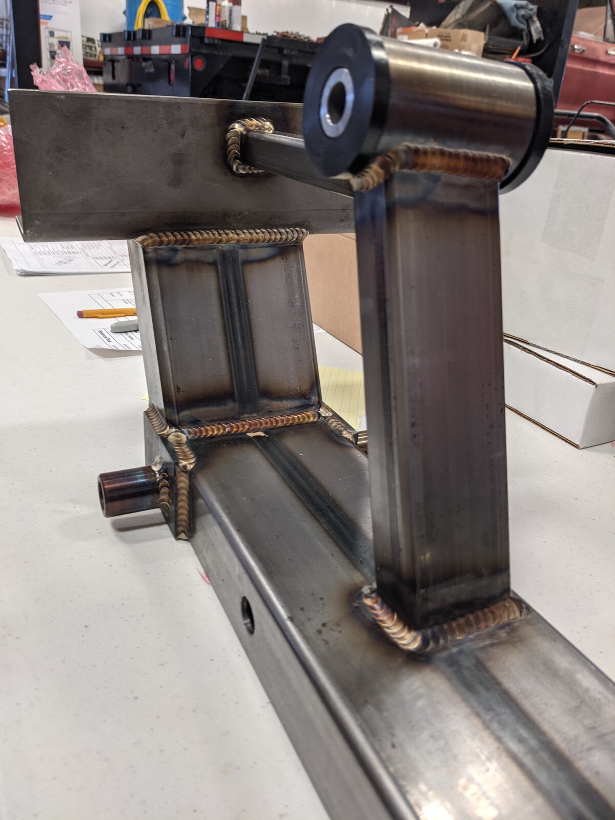

Finally got most of my suspension parts in from Rod & Custom Motorsports. The quality is fantastic at this point. My welds will look like bird *hit compared to this part. It's the new Front sub frame. NASA welds. Lol

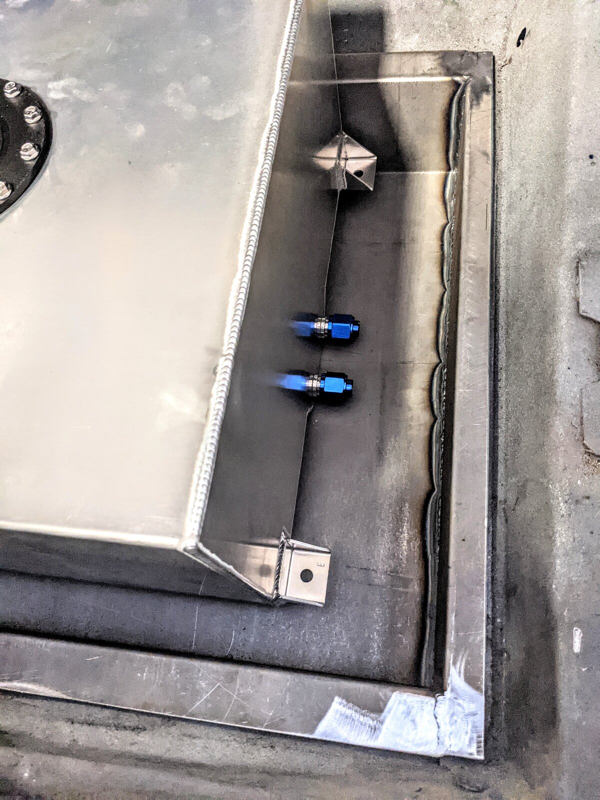

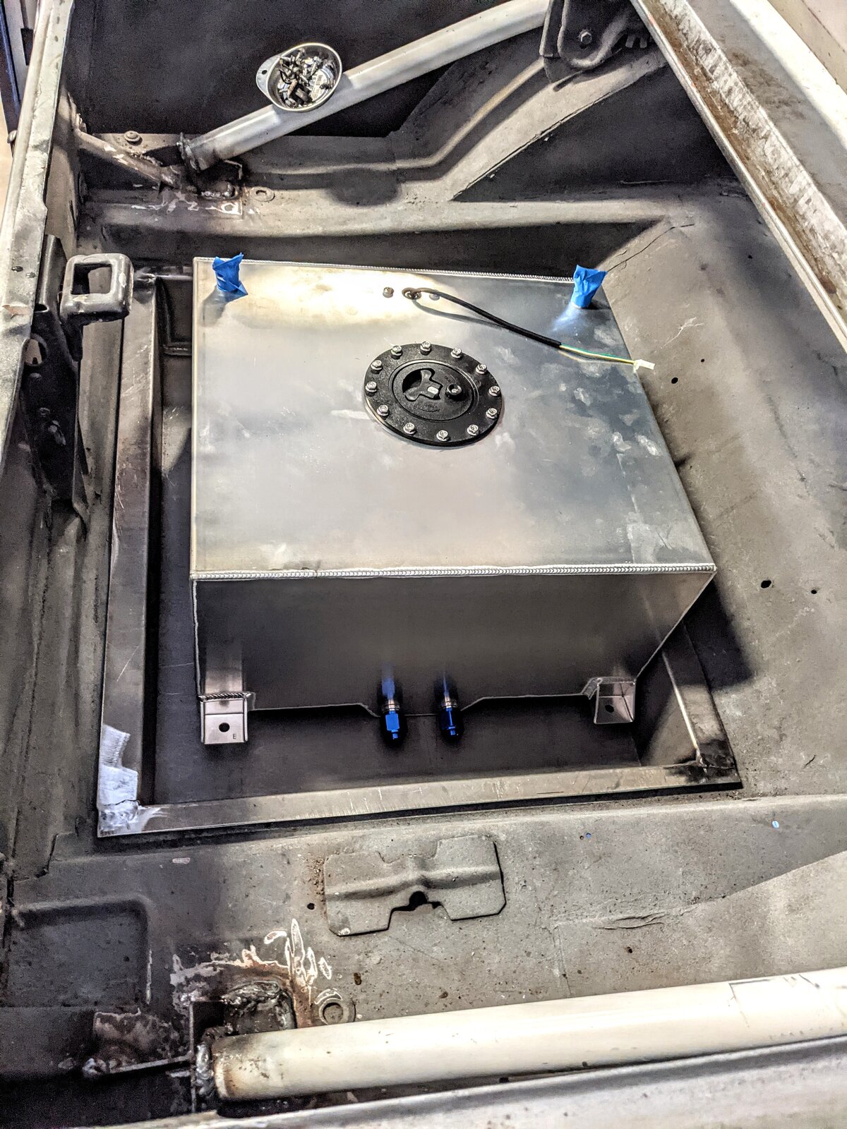

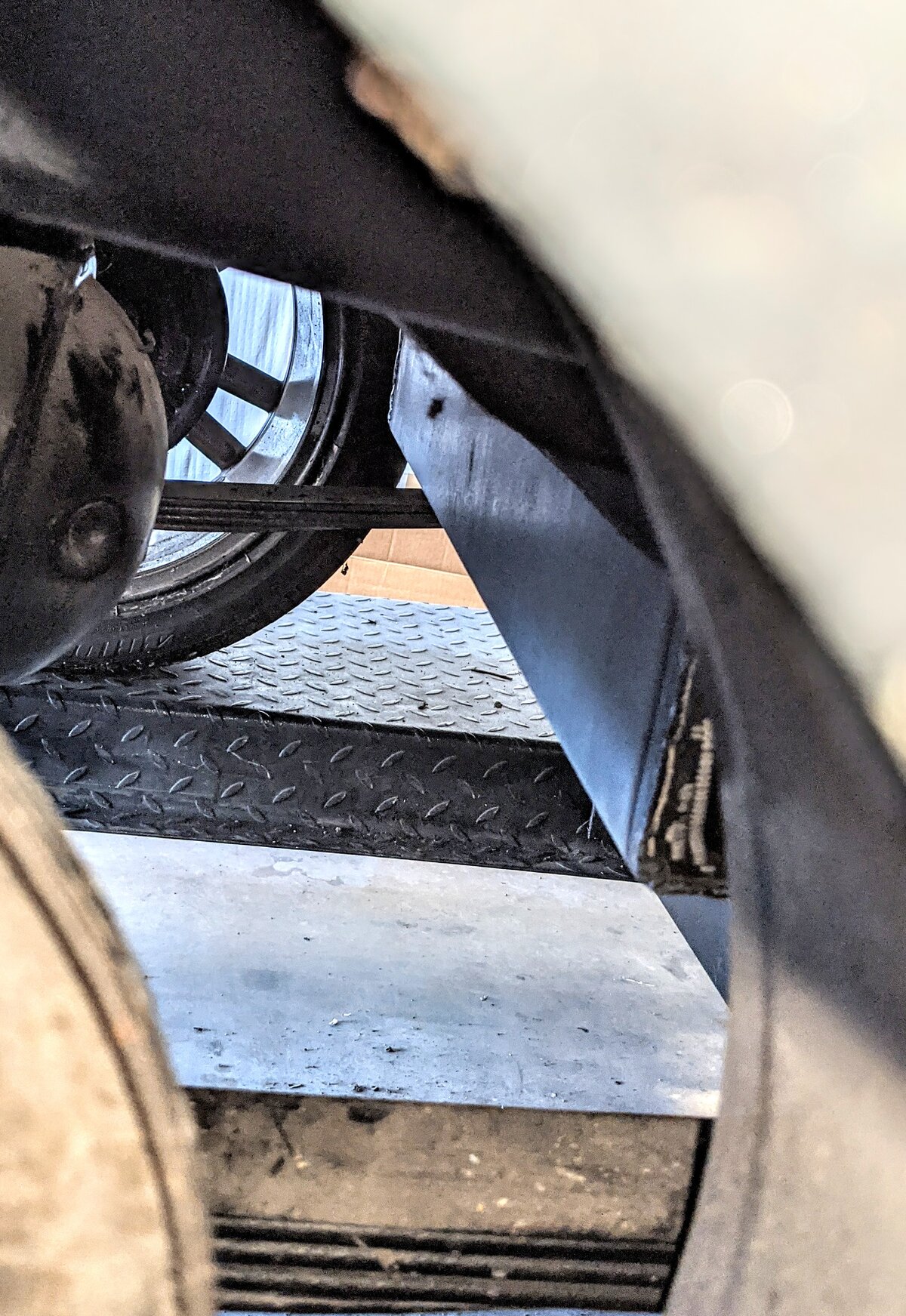

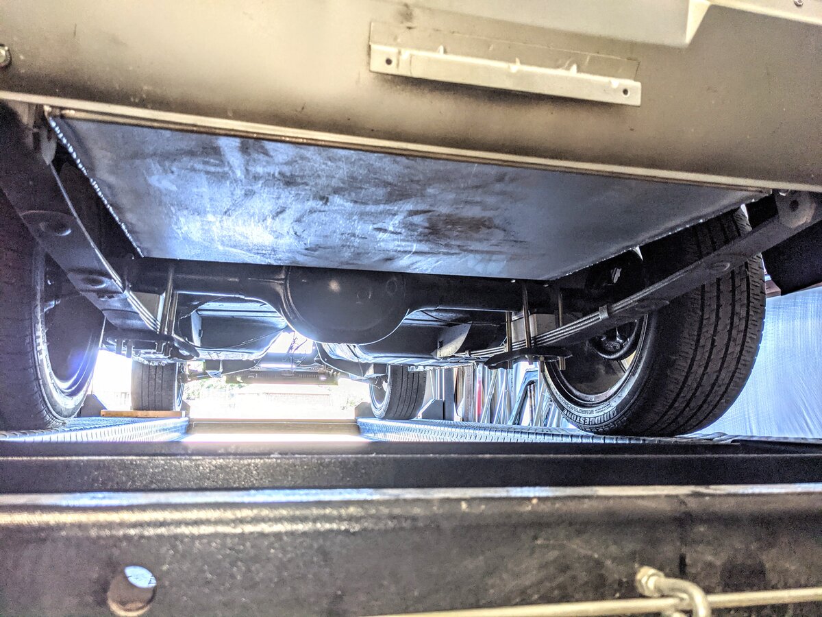

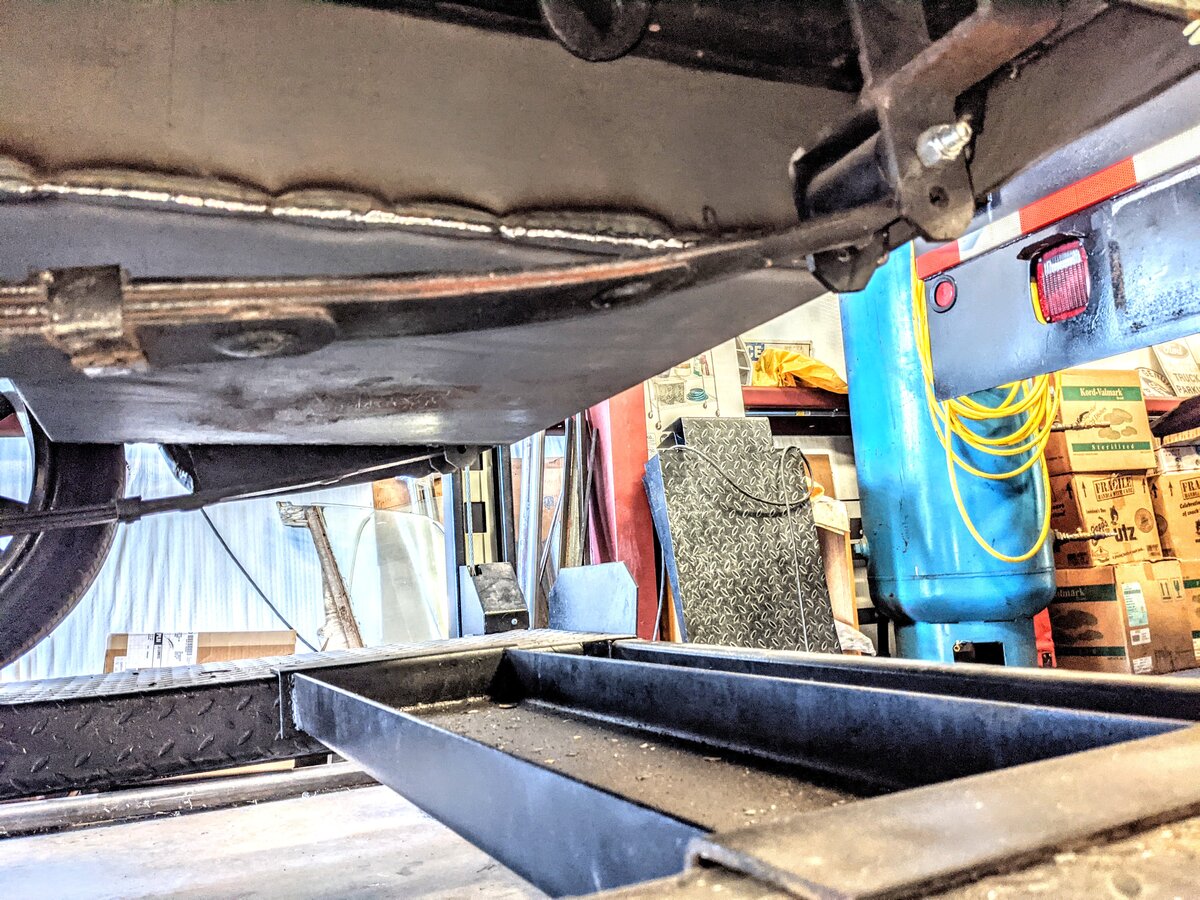

Got the old fuel tank out of the way so when we start the rear 4 link. All the suspension came but no rear end housing yet.
So while I have the time I made a trunk recess area to drop the fuel cell down into. I had a shop bend the main body because my break isn't big enough. Used 14 ga. steel. Welded the ends on. . Trying to decide weather to cut out the area where tank drops for pickup fittings or use some stand offs shock mounts and raise it up and keep lines and fuel pump inside the trunk. Had hell getting it to drop in because of the narrow shackle brackets previous owners installed to narrow up leaf springs for their s h I t t y tub job. Look at drivers side, bolt head flat against my pan.
May run a conduit through cabin for fuel line to keep it out from under car.

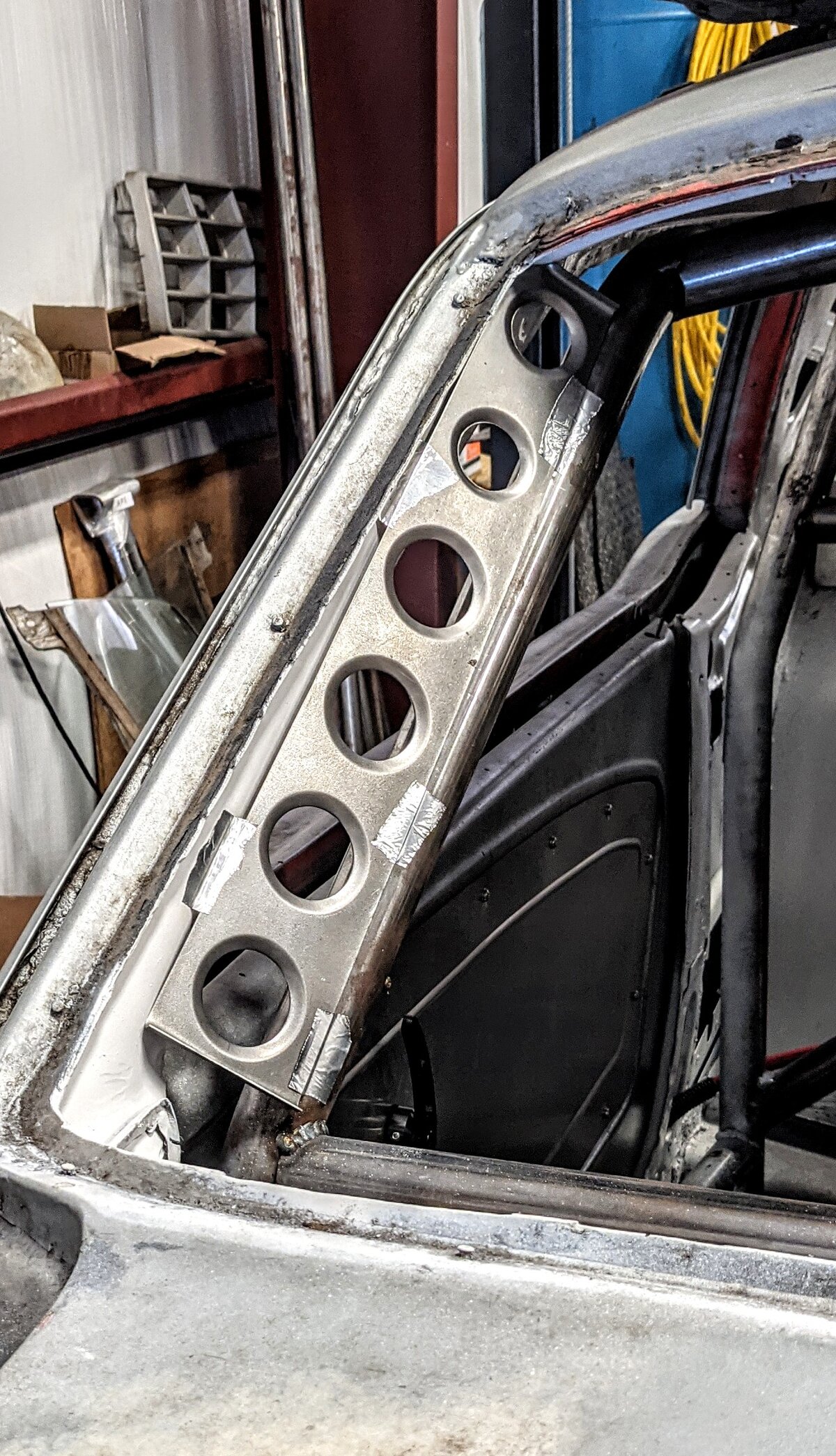

I did get 3-1/2 hours in on Thursday. Got my front body to roll cage tie in plates done. Keep body from flexing and shores up windshield uprights. And they look cool too! Lol.
