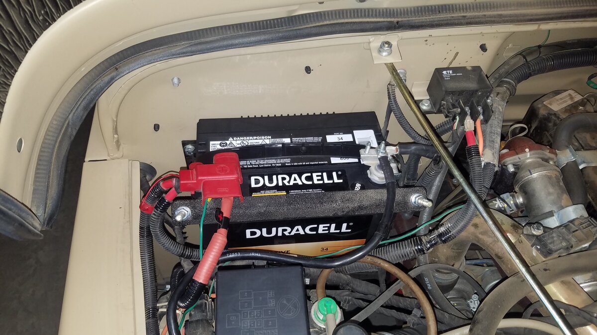

Dropped right in!! Exact fit. Plus it was on sale for $82????

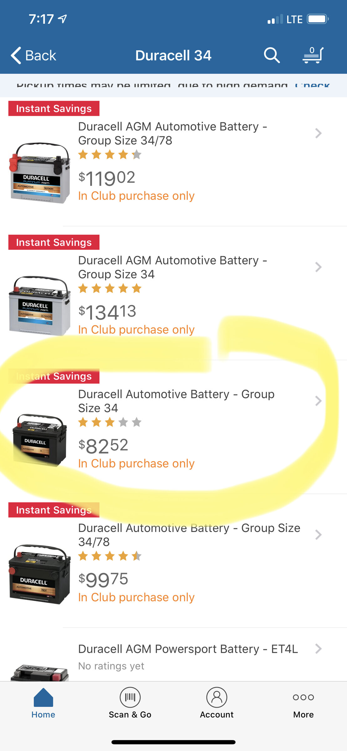

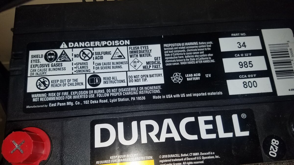

Found a Duracell battery at Sam's Club, group 34 with positive post on left, 800 CCA,
and the same dimensions as the OEM battery. $102
Bunny, is there a Sam’s club number or Duracell Number?

i think it’s this one, but what’s the difference with the AGM? Is it better to go AGM,
I have LEDs, light bars and winch.

Not an expert but I believe the AGM batteries are top of the line. I just didn't want to pay the extra $$$$. For what I'll be doing, this one should be fine. It's much better than what came out.? The one you have circled is the correct battery.
Good luck.
