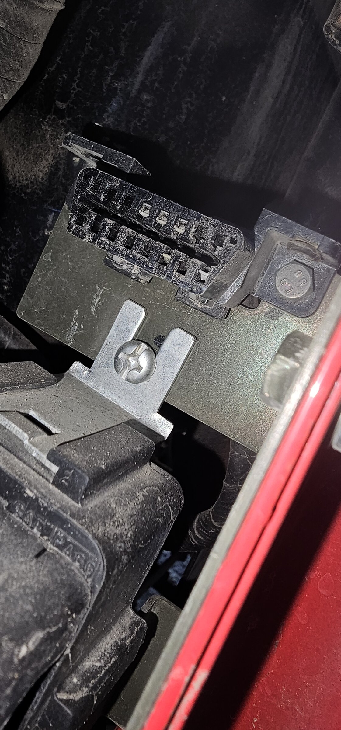

I saw a video of a guy pulling what looked like an obd2 port out from under the dash area. I had nothing like that on my 5555. I will open the hood and take the dash panel off today for a better look. I think I can see the ecm under the dash.

I opened the hood and removed the left side panel. I found a standard obd2 port on my tractor. Obdlink bluetooth worked with the torque app. Coolant temp and rpm anyway. I found 1 code no related to diesel, I was able to clear. Hooking the same equipment to the 23 Roxor gives me a power light and a fault light. The communication light never illuminates.

With your tractor using a standard OBD2 connector and your scan tool communicating with it, your tractor is not using the HD protocol like my CAT. Your scanner on the 2.7L HD is failing to communicate just like mine. There is still a chance that the Roxor is using the HD protocol like my CAT, I will find out the next time I am at my ranch, unfortunately it will still be awhile before I can get down there.
