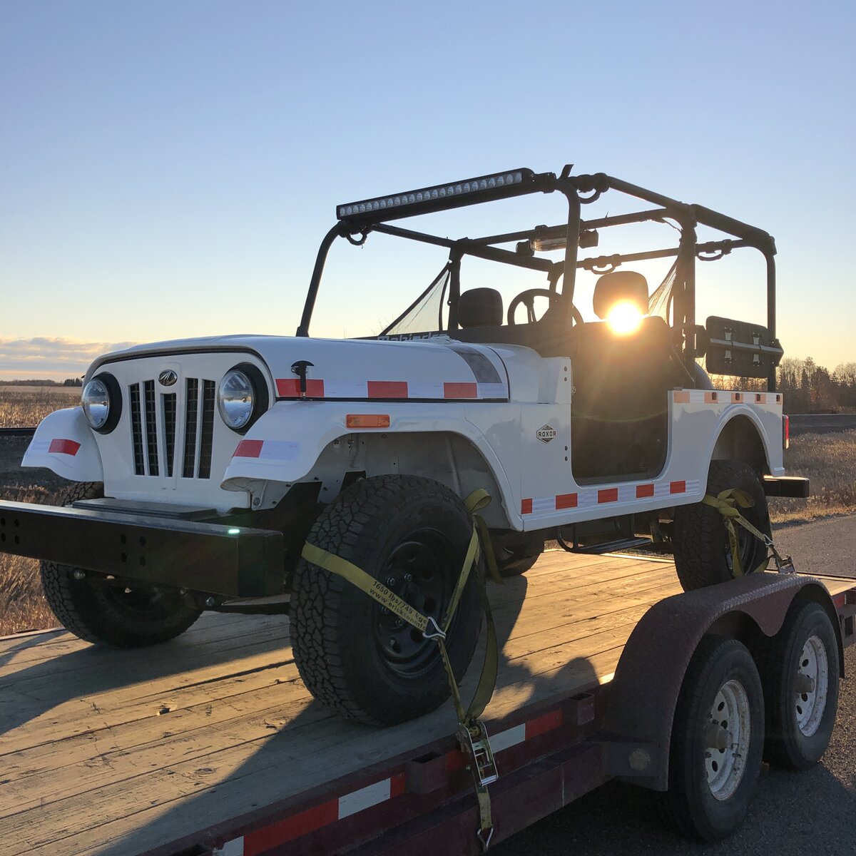

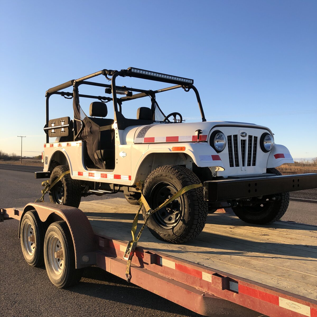

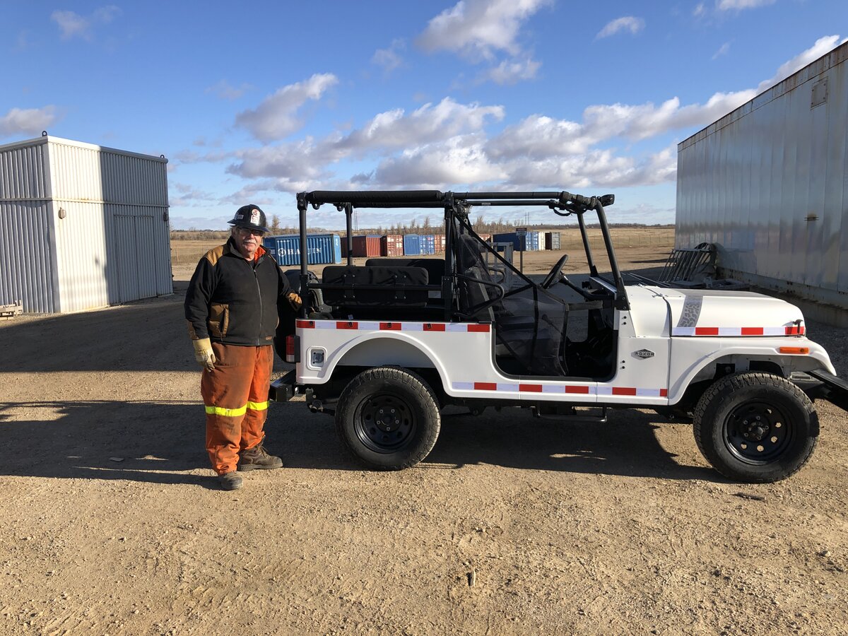

Nice. I help my dealer out some here in Saskatchewan with stuff and he has at least 6 or 8 underground here in the potash mines with more to come.
I delivered this one last week for him.

The batteries have to be changed out to a GEL to go underground here. Nothing serious for a 'weak' spot that I know of. I don't hear much of that stuff. I know they needed a couple Speedo's fixed and a parking brake cable. I think one of them is over 25,000 miles now. These ones are all limited to 25 mph.
They are replacing Gators (belts and bearing eaters) and Kubota's (engine eaters) and others. They like them compared to the plastic stuff they have been using.
How are those side facing rear seats?
I think they are ordering them in most of them. I guess they seem ok for what they are. You wouldn’t want to go off tossing with them I don’t think. If they are used for what they are intended for, slow speeds, they work good.
