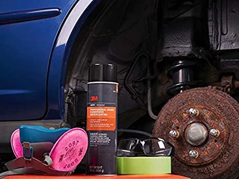

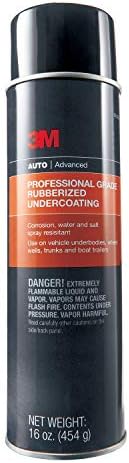

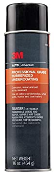

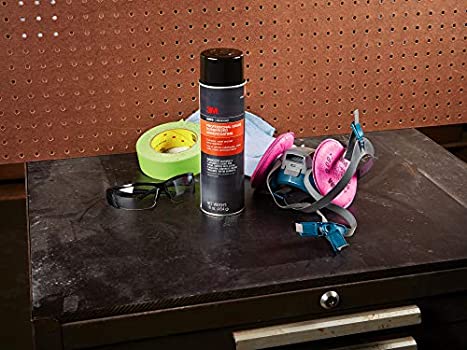

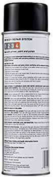

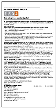

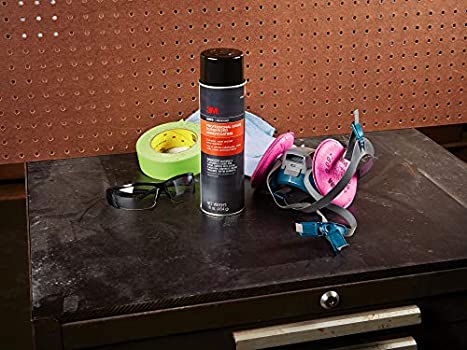

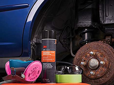

I've seen some use this product
3M - 03584-6PK Professional Grade Rubberized Undercoating, 03584, 16 oz

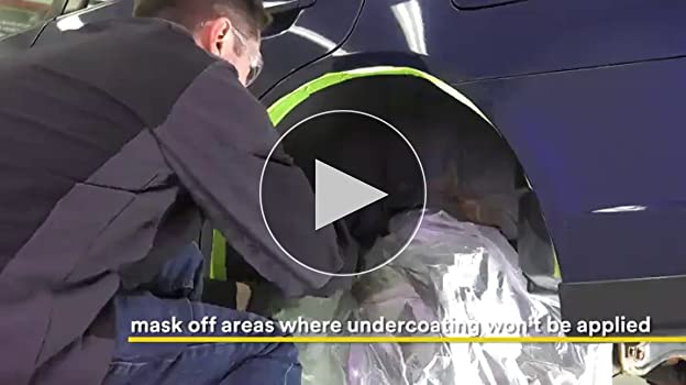

Great idea, not to insult anyone's intelligence, but I would just make sure you mask off and nuts, bolts, fittings, ECT.
813
Wouldn't suggest doing it in a garage. Mask the floor if you do

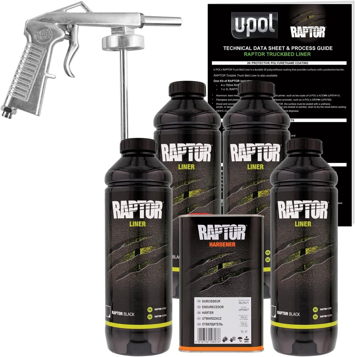

Thinking of rhino lining the undercarriage or a product similar to rhino lining. Has anyone done this and if so are you happy with it and what was the cost roughly? Every pickup I’ve had has already had the at least the lined
If you have a compressor this is great. I did the bed of my truck in less than an hour after it was cleaned properly.

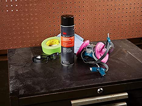

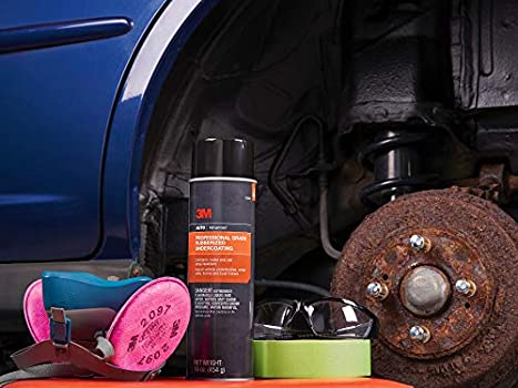

Living up north I am familiar with this stuff , can't say I'd use it again. If you spray it over any existing rust the rust will not stop. Plus it peels off easily. There are must better products out there IMO , we have have good luck with some wax based products, had it on my truck for 6+ years where they use salt and sand on the roads here in the winters and had no rust where it was applied.
