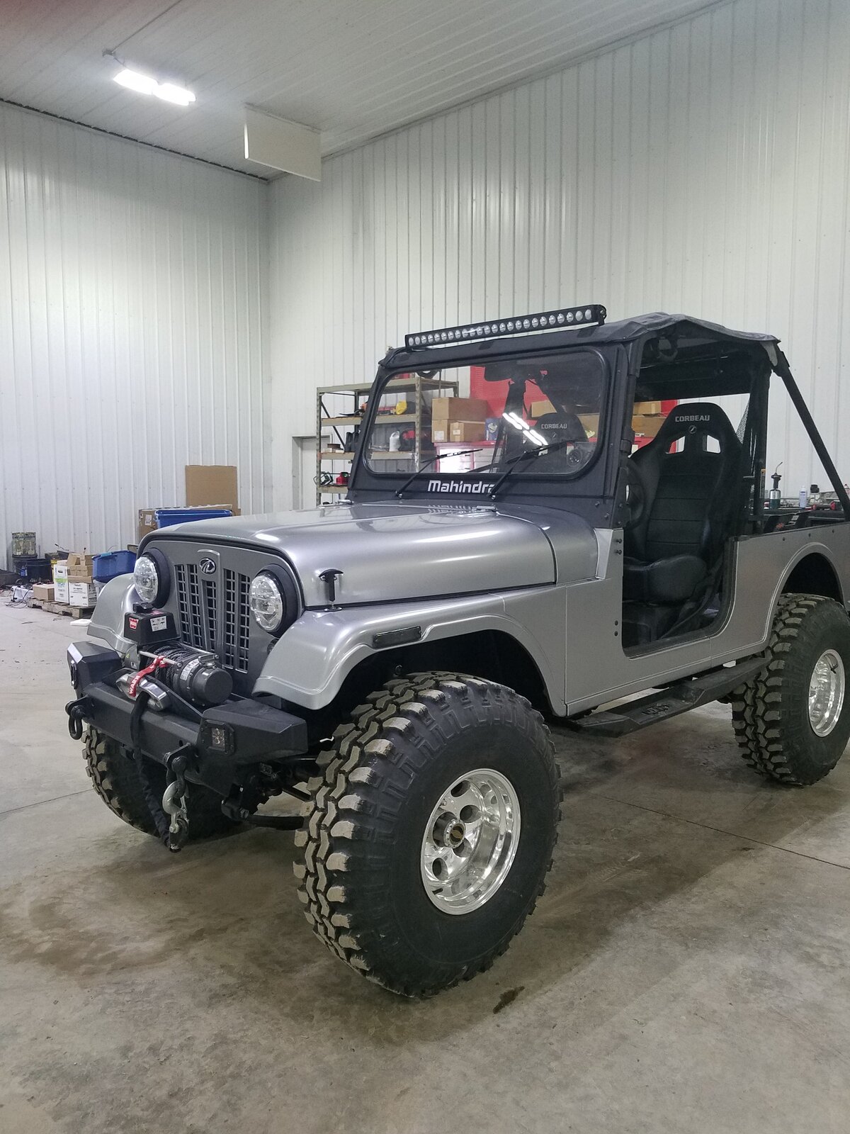

I am running 36-12.5-15 Super Swampers on mine. Did have a few issues at first. Now have about 5 inches of lift (3 inch spring lift and longer shackles) added light air bags on rear axle for rough trails. 10 to 20 pounds of air will prevent it from hitting body. Cut out flares will also work.
Those nerf bars / sliders are pretty slick too. What brand are they?

RxR Perfomance
