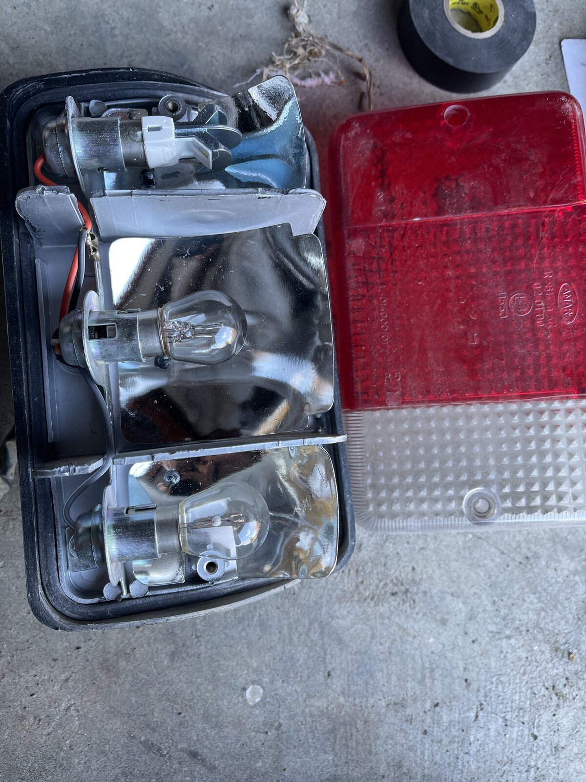

The taillights got to go. Has anybody taken off the tail light yet to see how they mount? It appears as if swapping over a stock CJ style taillight may not work because the ROXOR light is on the radius of the tub. Hopefully there is a simple solution to finding a light that will fit without leaving holes in the tub visible. I was looking at the round light DOT's and those may work but I don't see where they would cover the holes in the tub. Need to find something that can surface mount. Tub corner guards would cover things up but to me they are so ugly. I'll keep looking, but could use suggestions.

There is a double filament bulb in the tail lights. The Roxfanatics kit uses the stock rear bulbs.

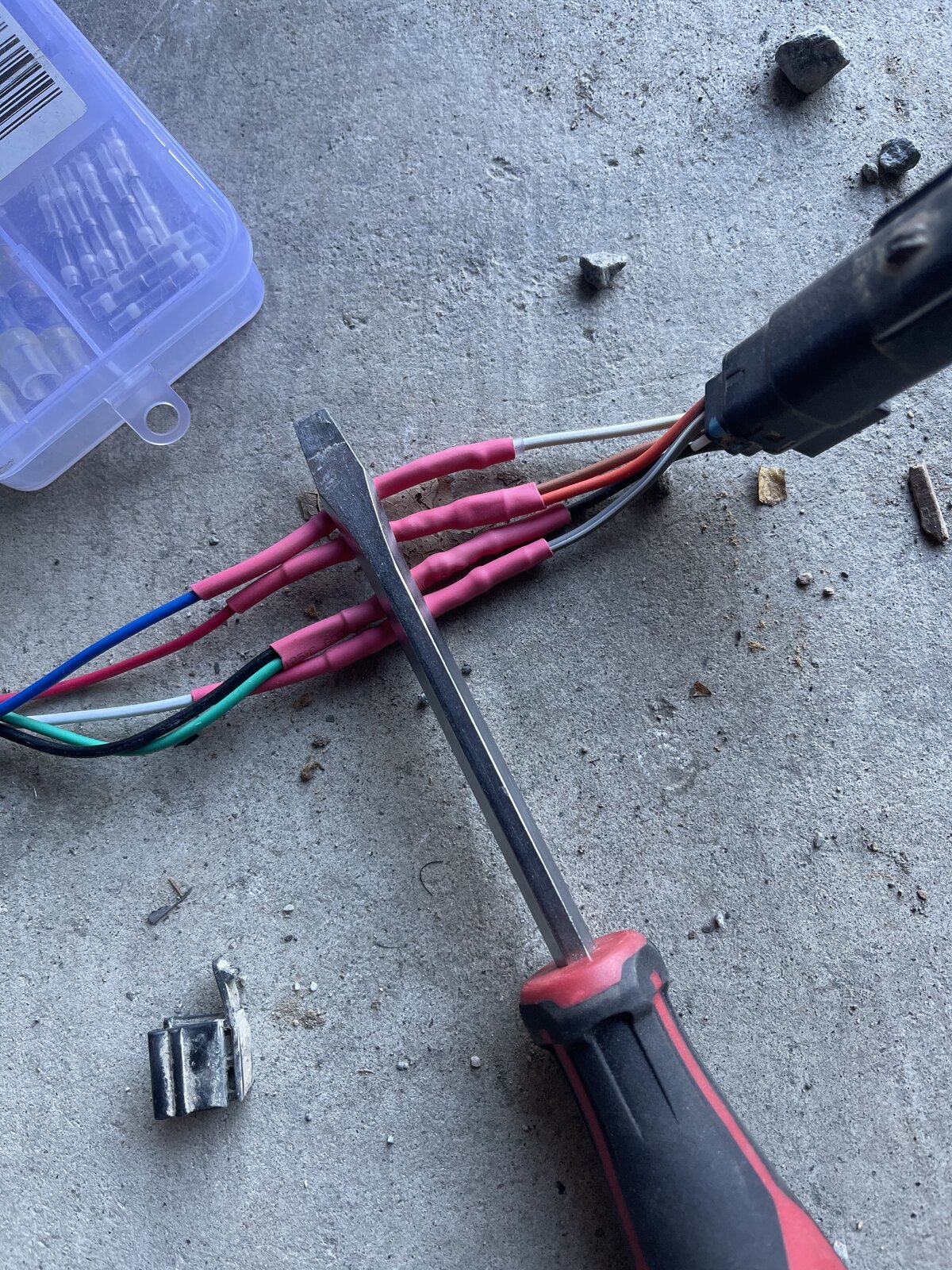

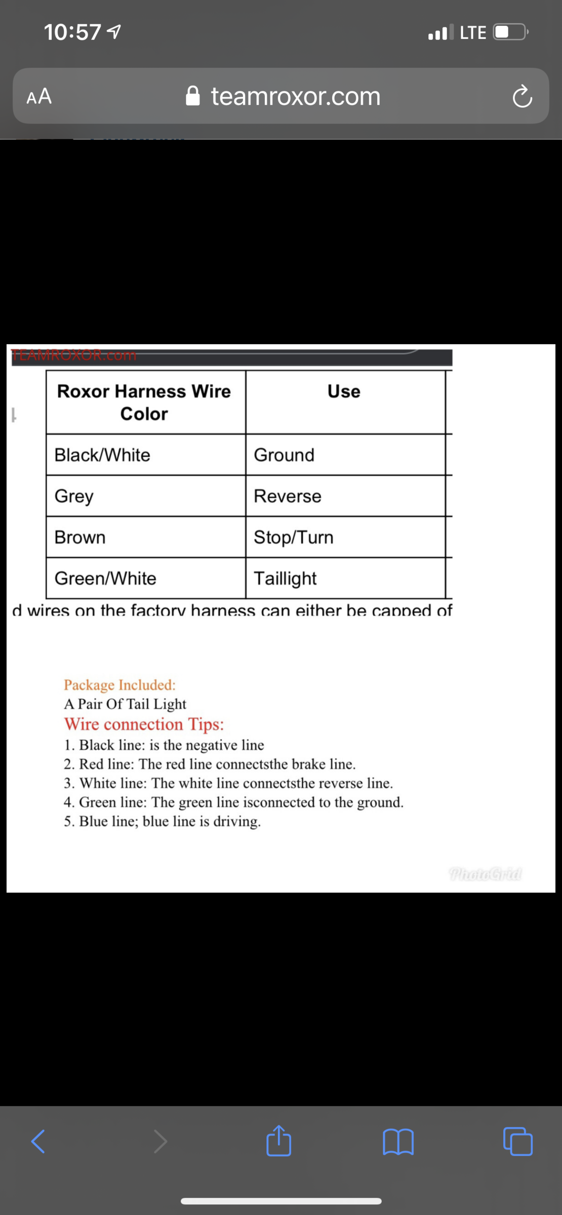

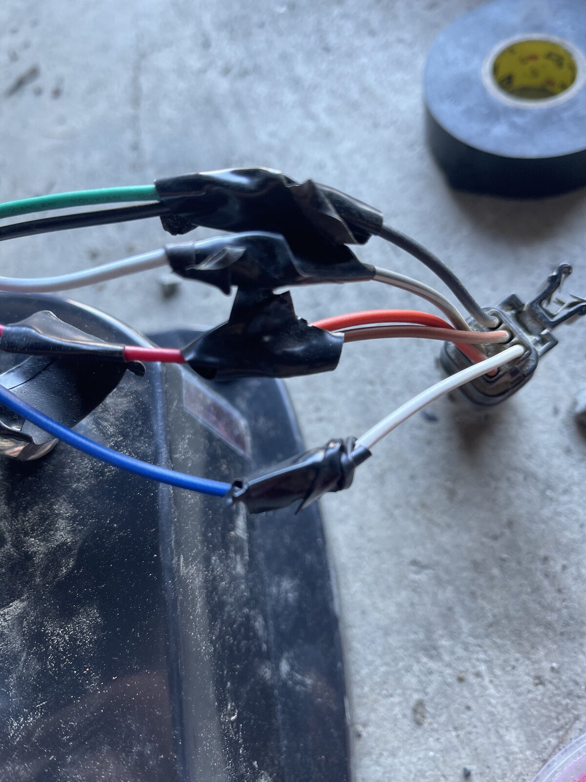

Campy man, question, I have a 2019 and I bought some after markets, but it’s confusing me.
I’ve got it hooked up, but then I realized turn signal works..... till I put on the brakes. Then only brake lights.... any ideas? The attached image of color wires is for a 2018 Roxor harness. The old style. But the bottom part is the light MFG... and the 2 pic show how I wired it.

So are you using a factory harness or a XTC kit???? The LED lights will NOT work with the factory harness nor the XTC standard kit. XTC makes a 3 wire adapter that you'll need to request when you purchase their turn signal kit and that will work perfectly. I loved mine.

XTC! Yes that is it. Thank you!!!
