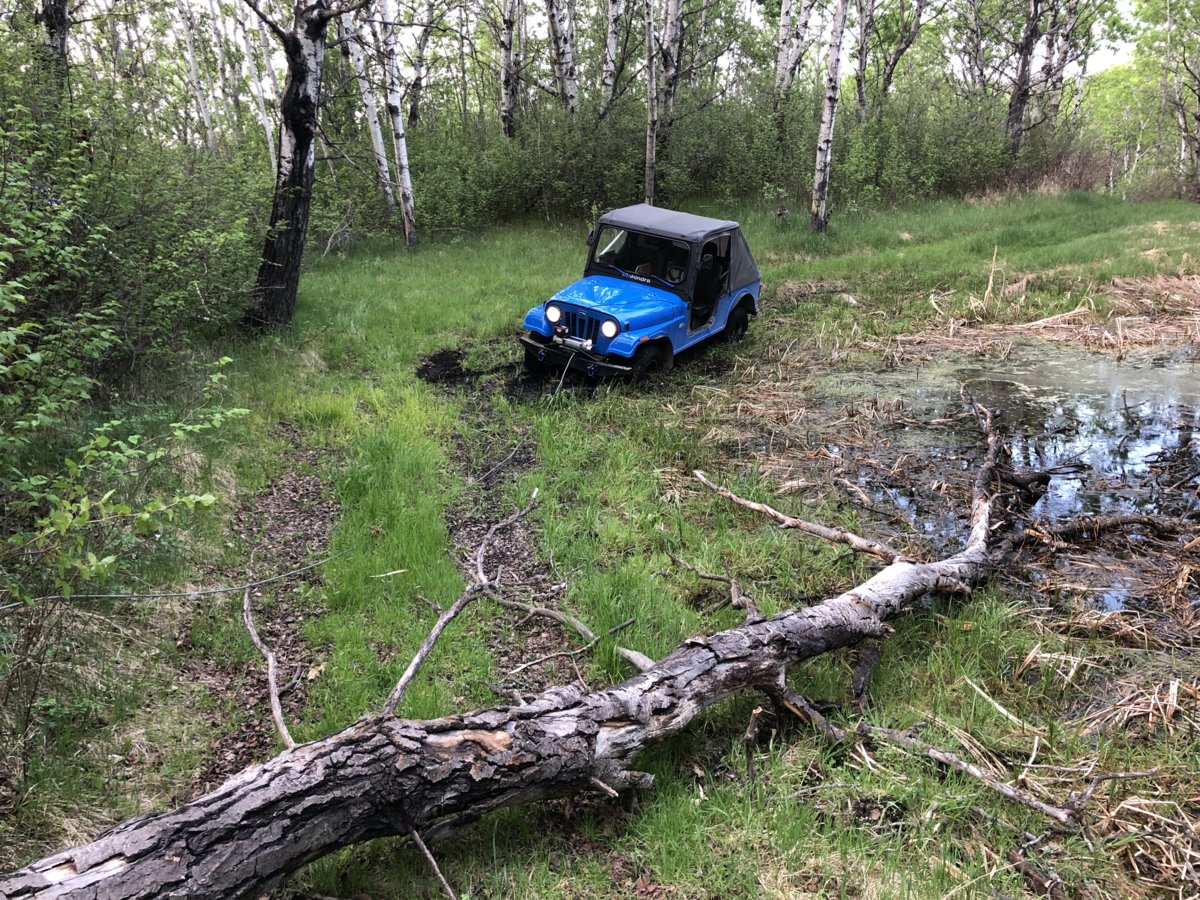

So I have, as the title says, the Roxor lunchbox lockers front and rear and the warn front hubs. I really like this set up....but, my question is: If I leave the front hubs engaged, cause I don't want to get out every time I come to a location that I NEED 4x4, is this going to cause any major issues when running in 2x4 other than a bit tougher steering? That's all I kind of notice anyway.
I disengage once I get back to where I probably won't need 4x4, like on the way home at road speeds, but not always.

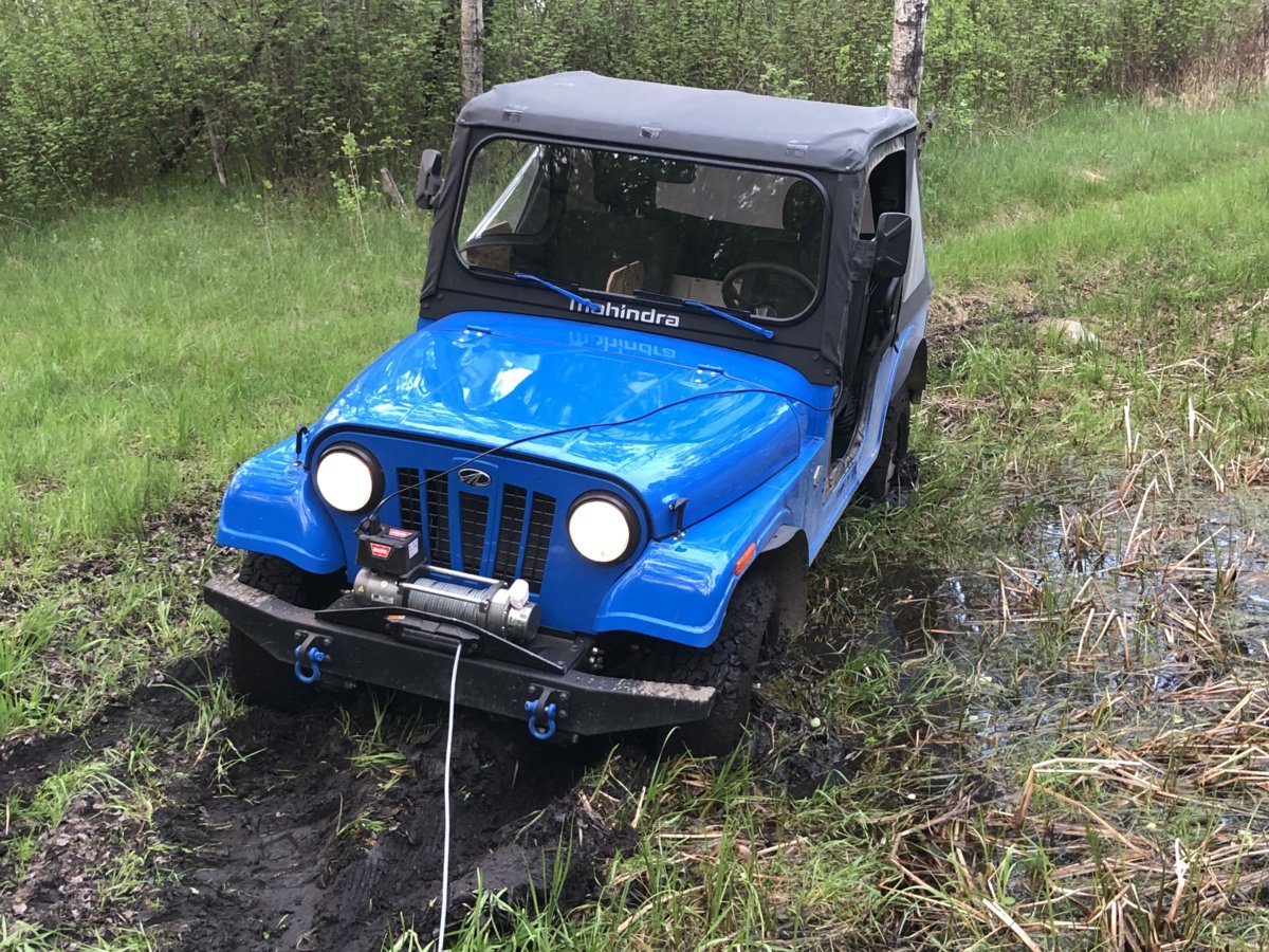

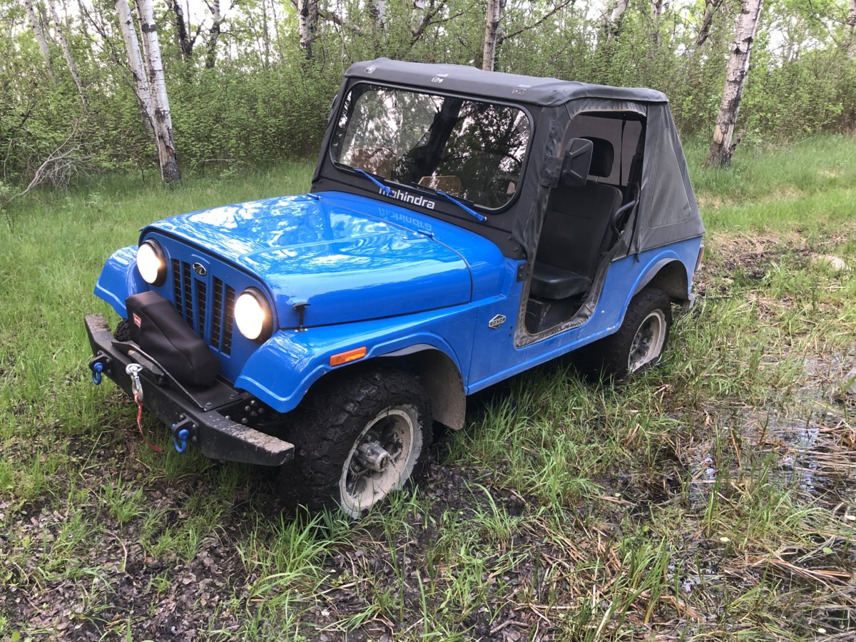

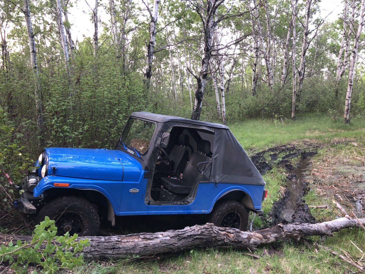

This is what happens when I stay in 2x4 with the hubs disengaged vs being able to hit 4x4 when needed cause I figured "yeah, I'll make it". lol
PS. Winch to a good tree, not a rotten one that you pull out of the ground.
