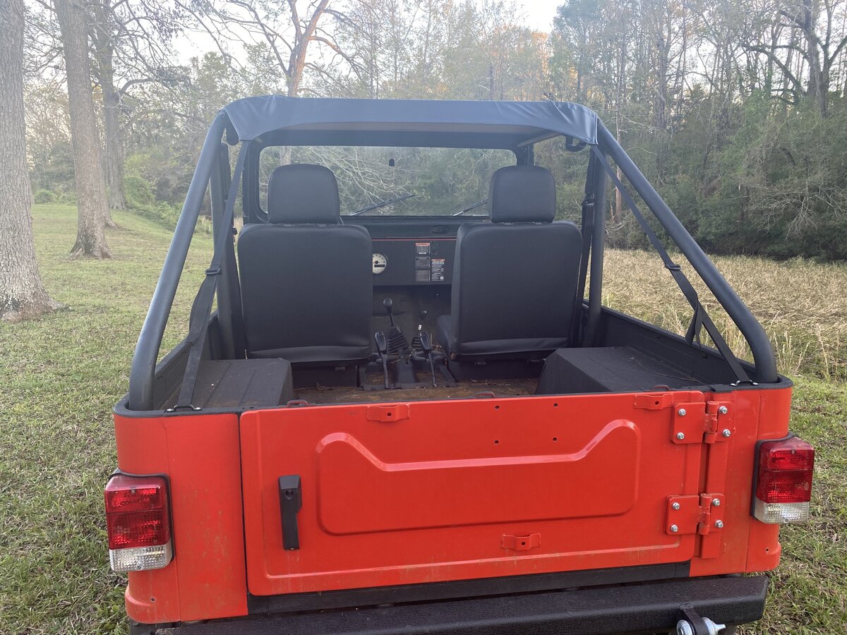

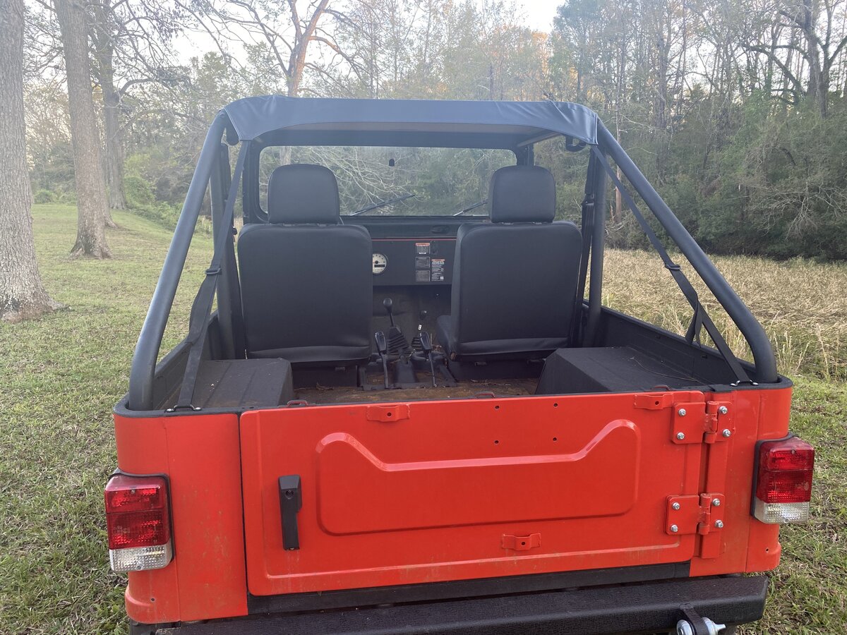

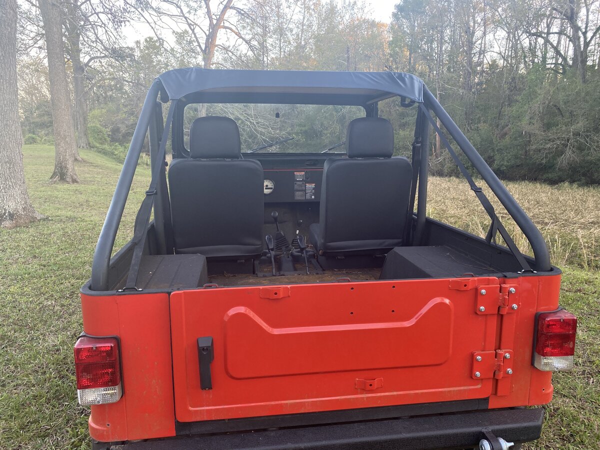

I think you will find, like I did, that the CJ/YJ bikini tops are a bit narrow at the center hoop. I just put a CJ bikini top on mine with a YJ windshield and the center roll cage hoop is about 3 inches wider than my friend's YJ. I made it work but it's not perfect.
View attachment 8017 View attachment 8018

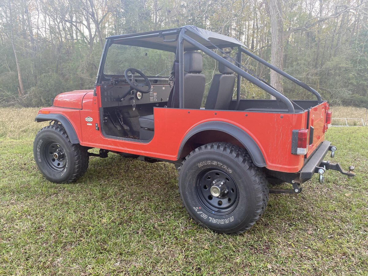

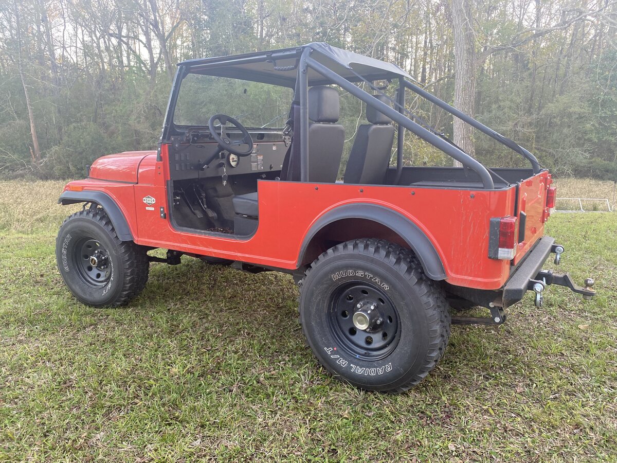

The YJ windshield bolts right on with no mods. Just use a set of CJ/YJ hinges. The only issue is that the lower-side bolt holes don't line up with the Roxor threaded holes. Everything else is a perfect match. I have been planning to weld up and re-drill that hole on the hinge to match the Roxor but havent done it yet.
I bought a YJ windshield frame with good glass at the junkyard; mainly to get the OEM wiper components. I did buy a new frame but still havent taken it to get painted to match.
I did have to do some fab work on my roll cage; cut 4" out of the center hoop and re-bent the rear kickers. It would probably be easier with the 4 person ROPS. I also installed the YJ hoop to windshield tubes.
I don't have a head-on picture right now but heres one that may give you some insight.

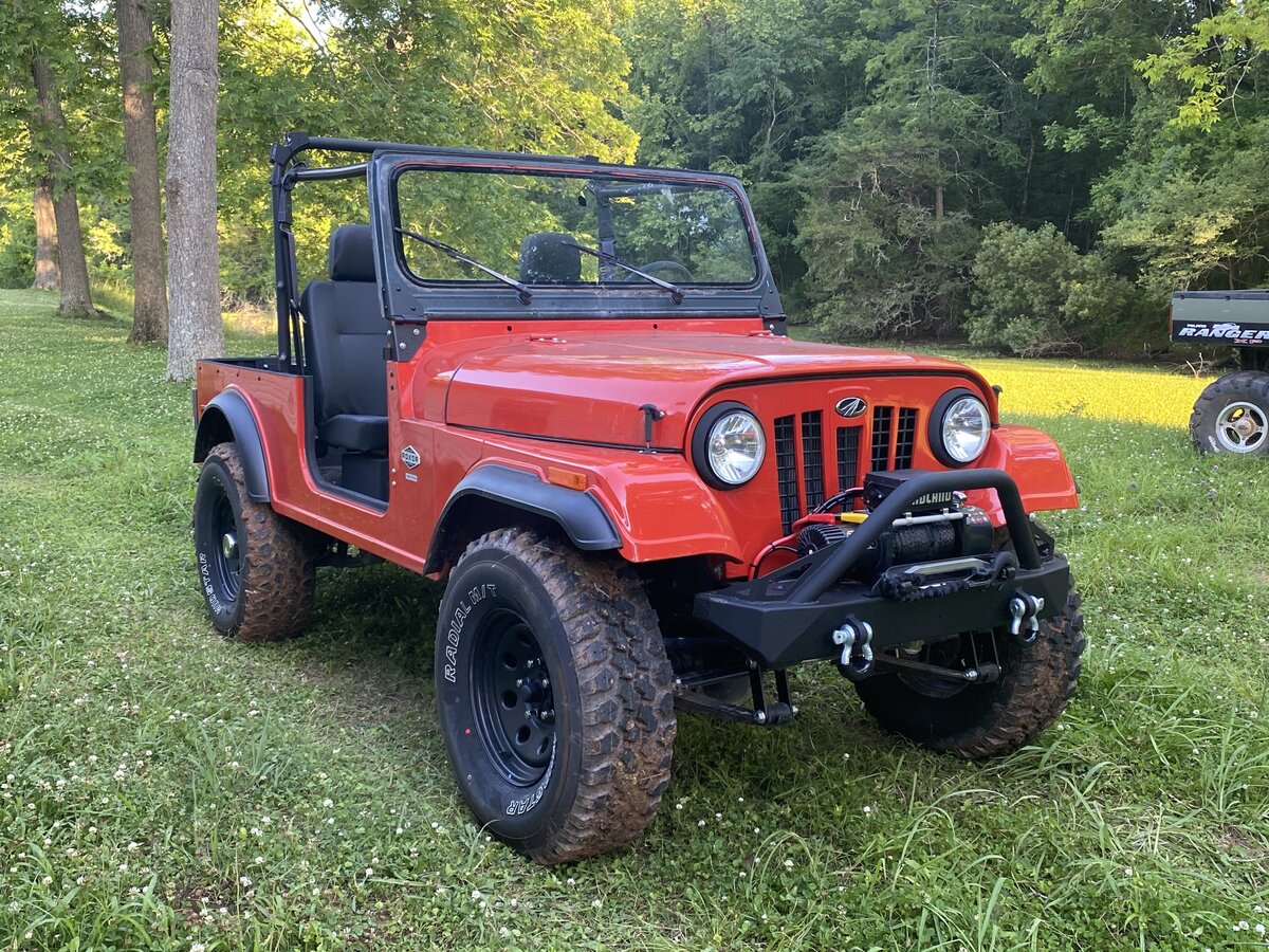

Here's a picture from when I first put the junkyard YJ windshield on. I hadn't made any ROPS mods yet, just took off the upper part and had a pair of old TJ hoop to windshield bars tyrapped in place.
