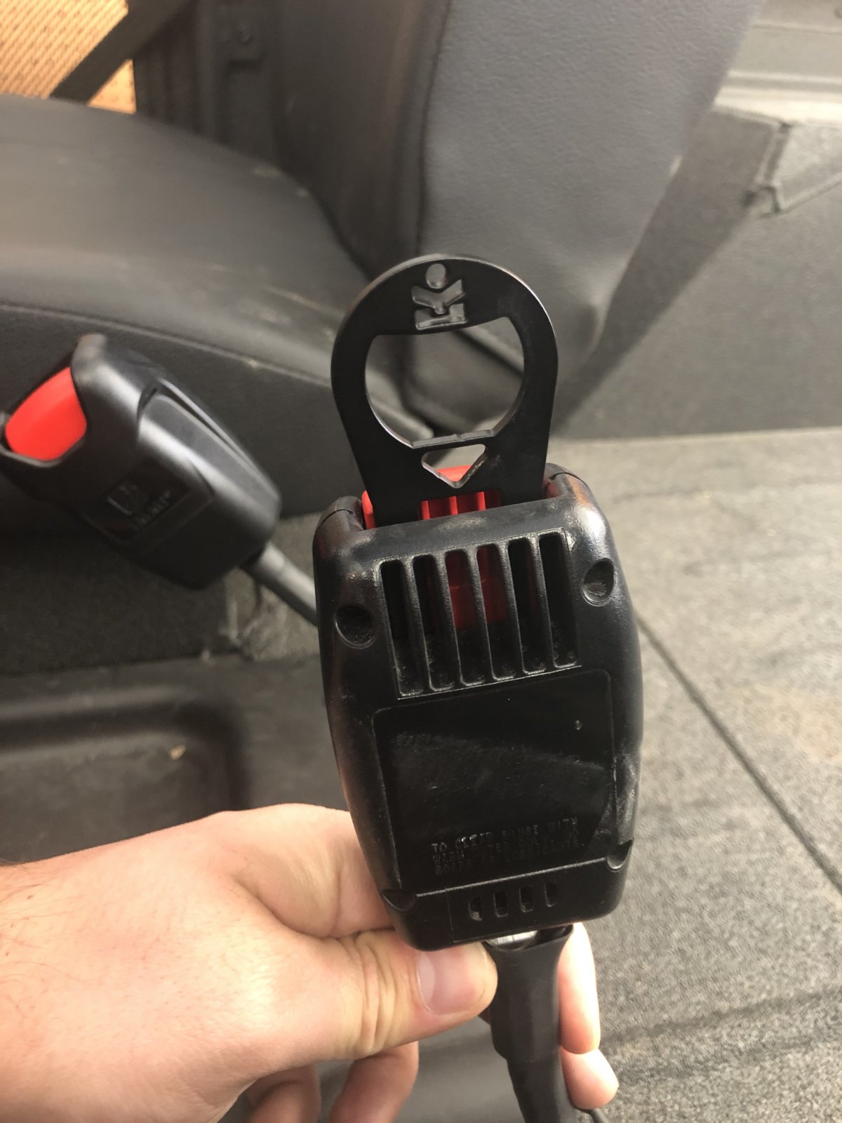

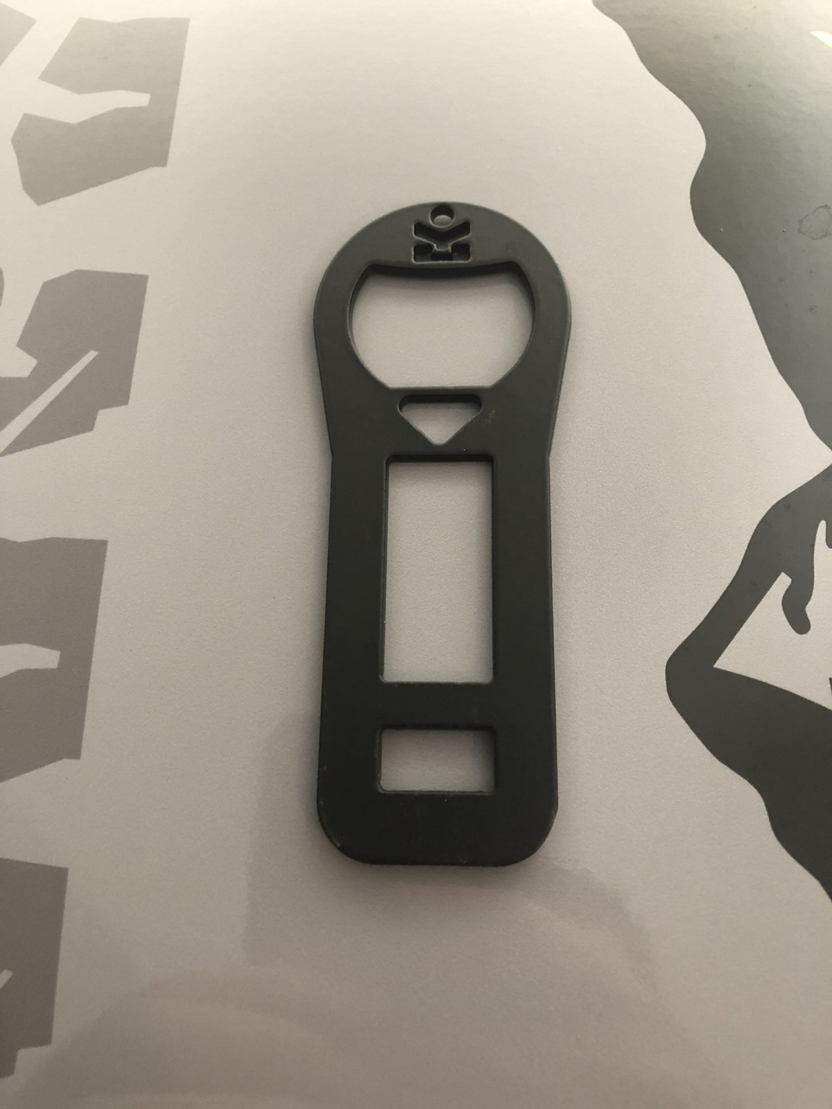

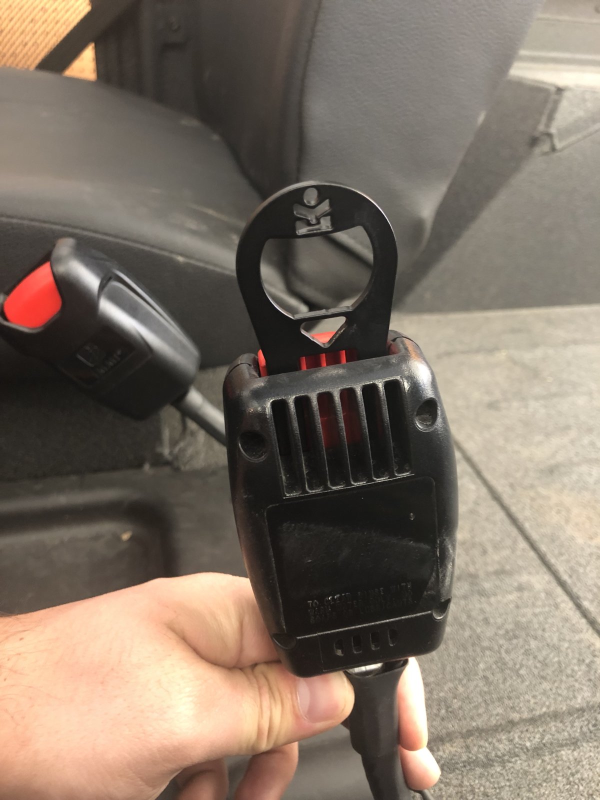

I’d like to start out by saying that 99% of my Roxor use is for hunting and is usually in 1st gear or 4WD Low crawling up hills in South Texas at very low speeds. I have a need to get in and out very quickly so the seatbelt has been buckled behind me ever since I bought my Roxor last May.
That being said, this is an awesome solution that is perfect for my needs with the Roxor.
$20- The Polaris one fits it perfectly and deactivates the seatbelt restriction.
Here is the link where I got mine.

I bought one and use it when getting in and out a lot. Dove field, deer hunting, spraying herbicide, etc. Cool tool and cheap. Tied it to seat belt shaft with mop string.

I ordered a Jumper Plug for the wiring on my Ranger. I do not believe the Seat Belt End was available when I deactivated mine in 2015.
This is a great way to fix the problem on the Roxor. No permanent wiring mods, and everything still works when you need it.

I generally ride around by myself, so I have the passenger seat belt plugged into the drivers side and when I need/want mine on, which is most of the time other than just moving it, I plug mine into the passenger side. I started with it hooked behind me, but I find this works better.

Do a search for "Seat Belt Over Ride Plug 2015 Polarus Ranger 570".
The Plug will be Blue with a wire Loop on one end.
Just unplug the wiring harness to the seat belt located behind the seat, and plug in the Bi-pass Plug.
I would suspect with the correct Plug End the same thing could be done with a Roxor. I believe the Seatbelt end is a better option however. I have a seat belt end for one of out Ram trucks.

Here's my MacGyver solution. I removed the cup holder panel to disconnect the seat belt sensor, then cut a paper clip in half (so it's shaped like an elongated "U") and shoved it in the two wire connects to bridge them permanently. Cost: 1 cent. Time: however long to find my 10mm socket. Fully reversible.

I took the seatbelt assembly apart and there is a switch inside. You can just tape the switch where it's Normally Closed and then re-assemble. No issues in 2 years.
