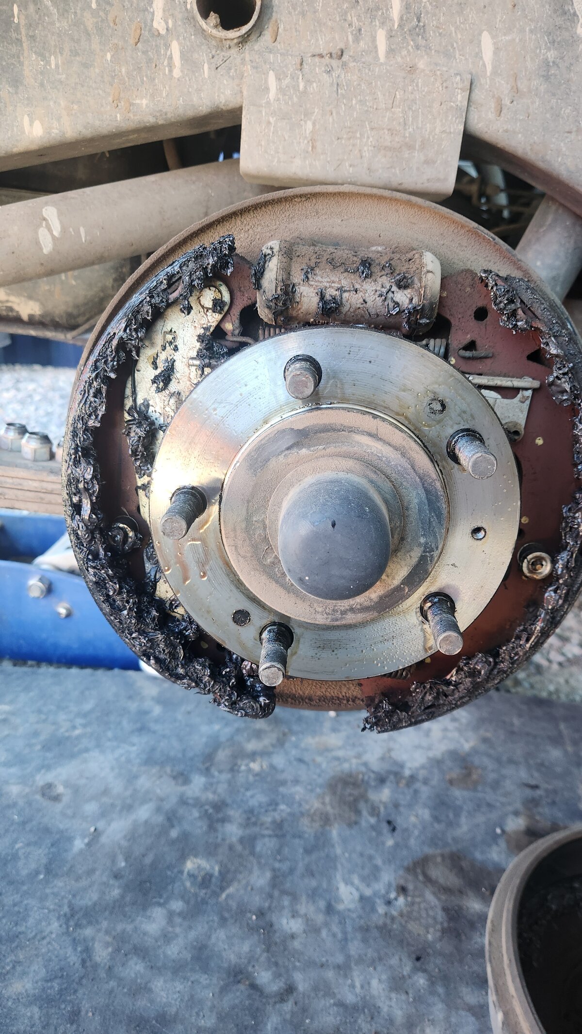

I just pumped over a tube of grease into the rear passenger side axle and still didn't weep out of the hole ontop? Anybody have this issue? Other side weeped almost immediately. Ive given up before when I had a hand greaser. Bought a battery operated one and it took a hole one before I gave up due to low light. Figured a tube and half is better than where is was. 2020 Rox
Make sure you clear the weep hole with a paper clip or something. If its clogged it'll cause you to overfill it. Just wiping it off doesn't do it.
Its always taken alot. I didn't do your idea but it was cleared. Grease gun the noise changes when it won't take anymore. Ive serviced other Roxors and have had the same issues. Thanks for the info.
Sometimes you get taught a new thing! Found out were all grease went!! Messy education! Make sure your weep hole clear
