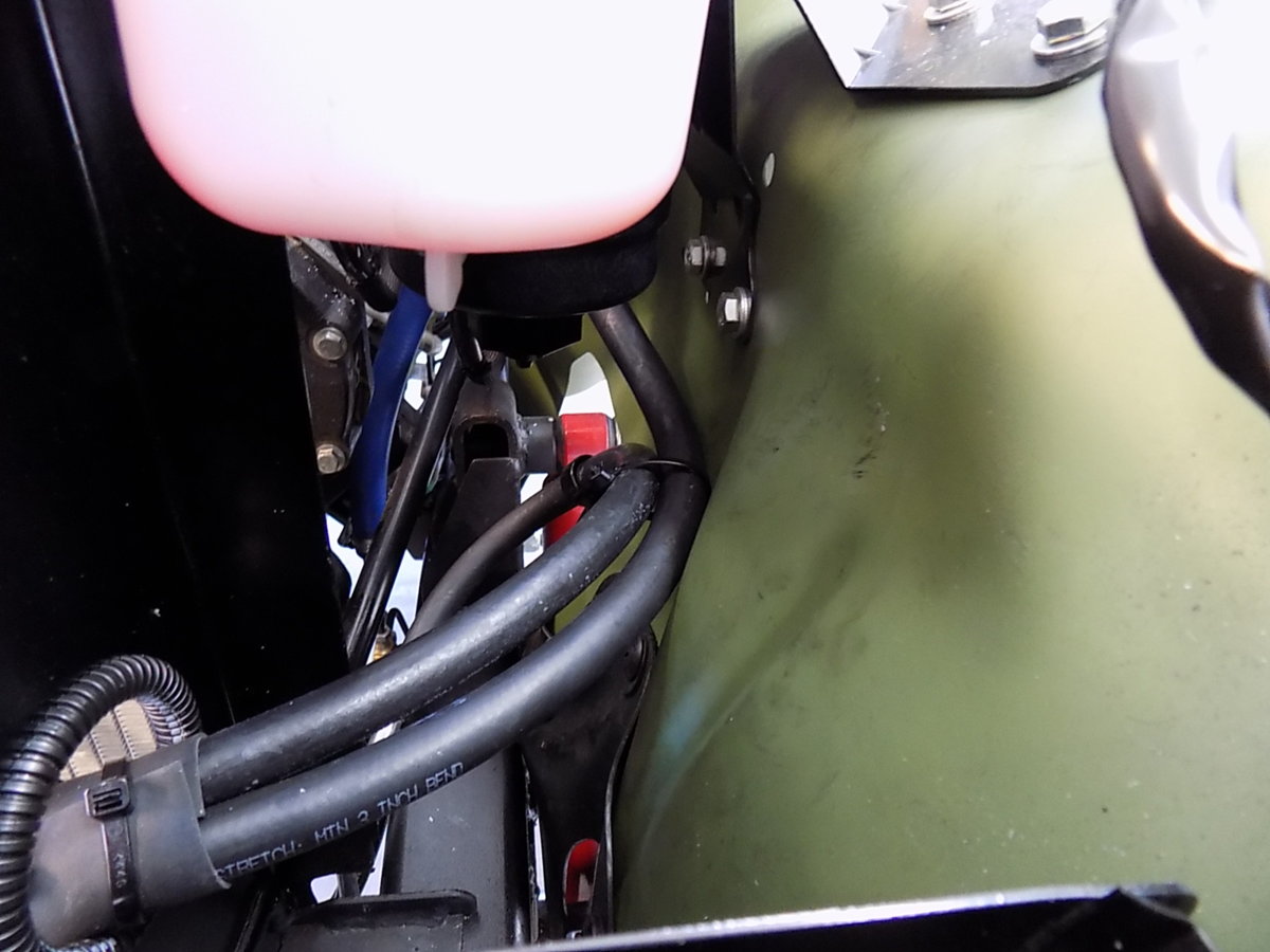

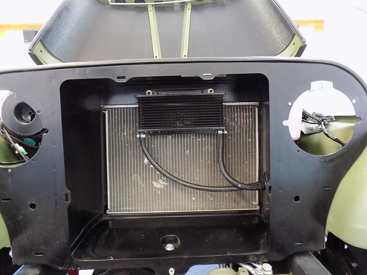

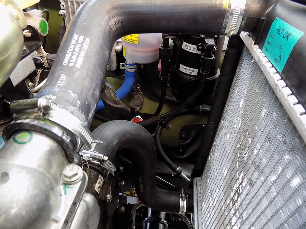

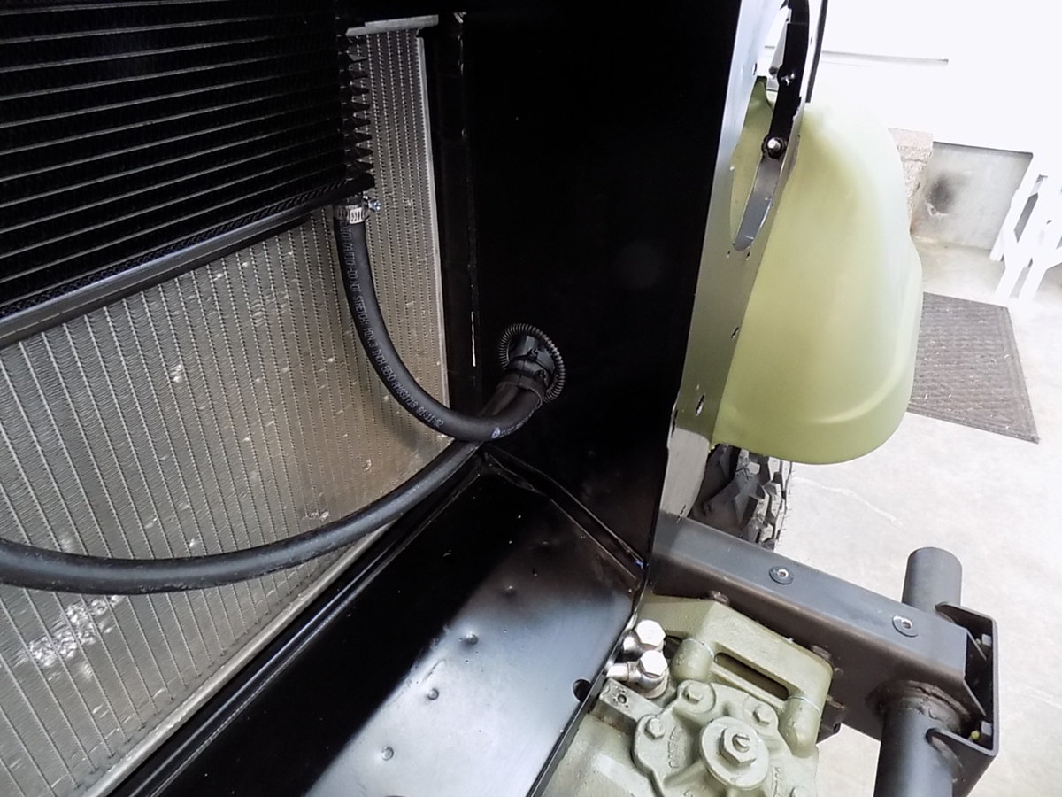

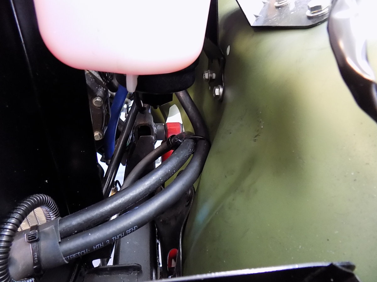

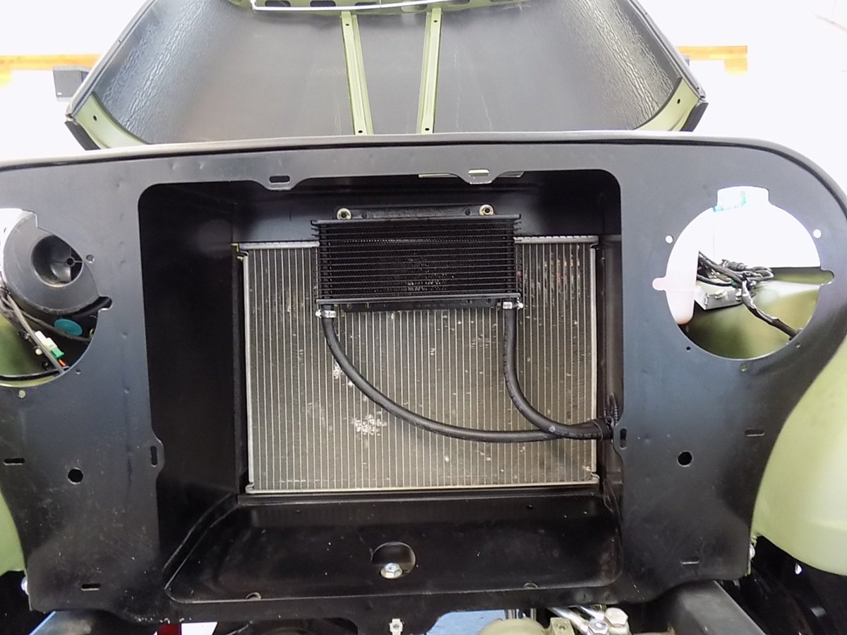

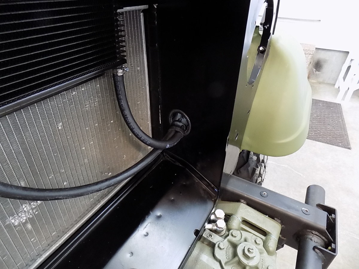

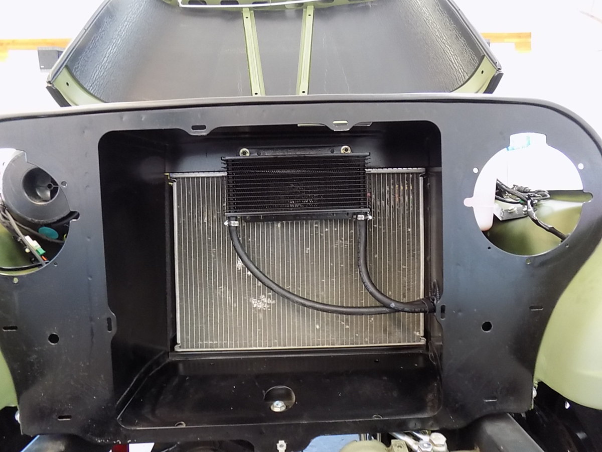

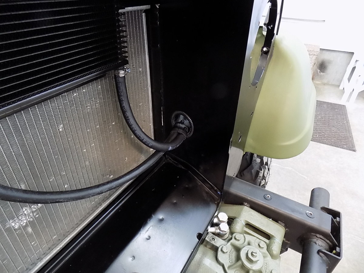

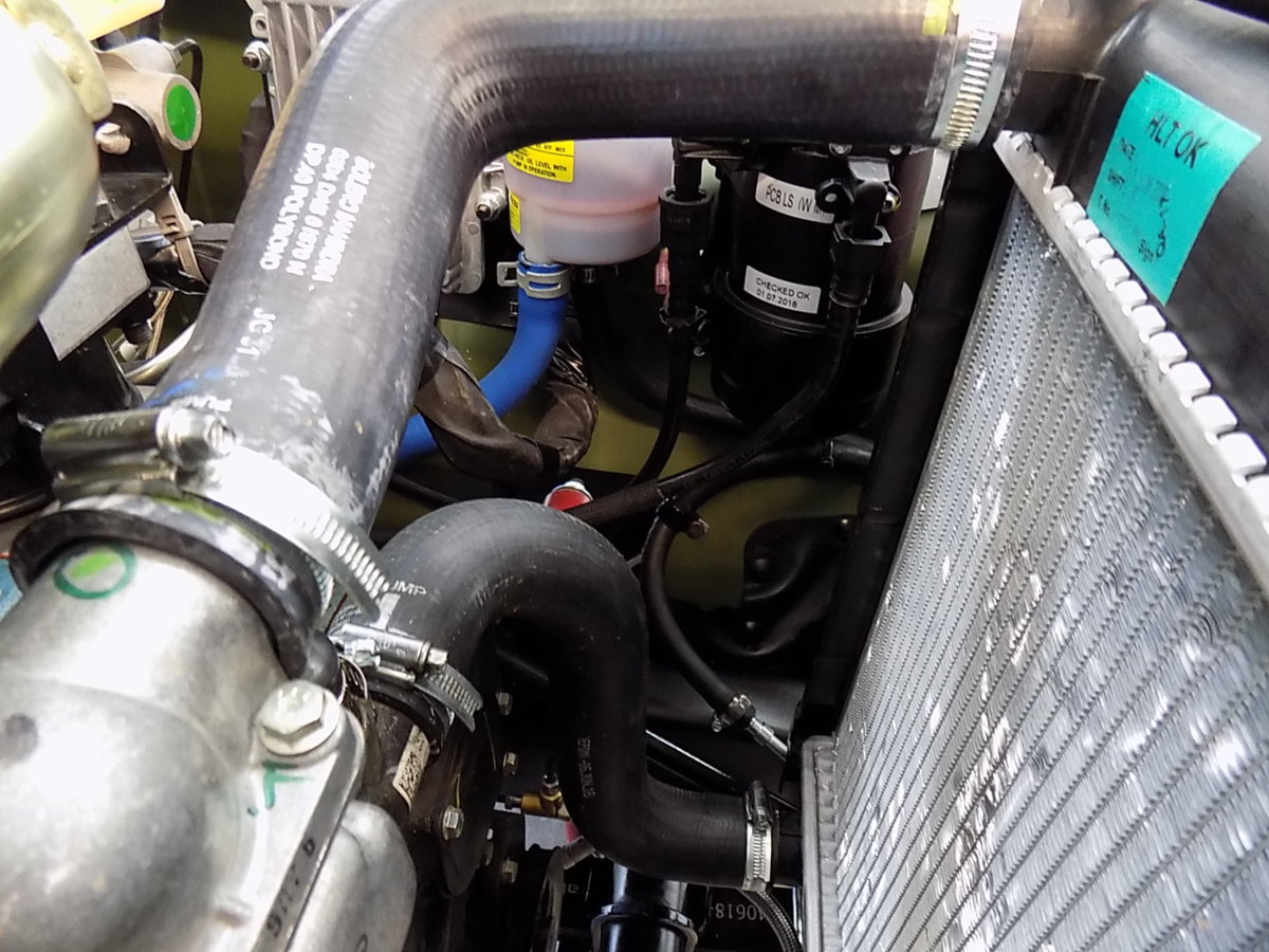

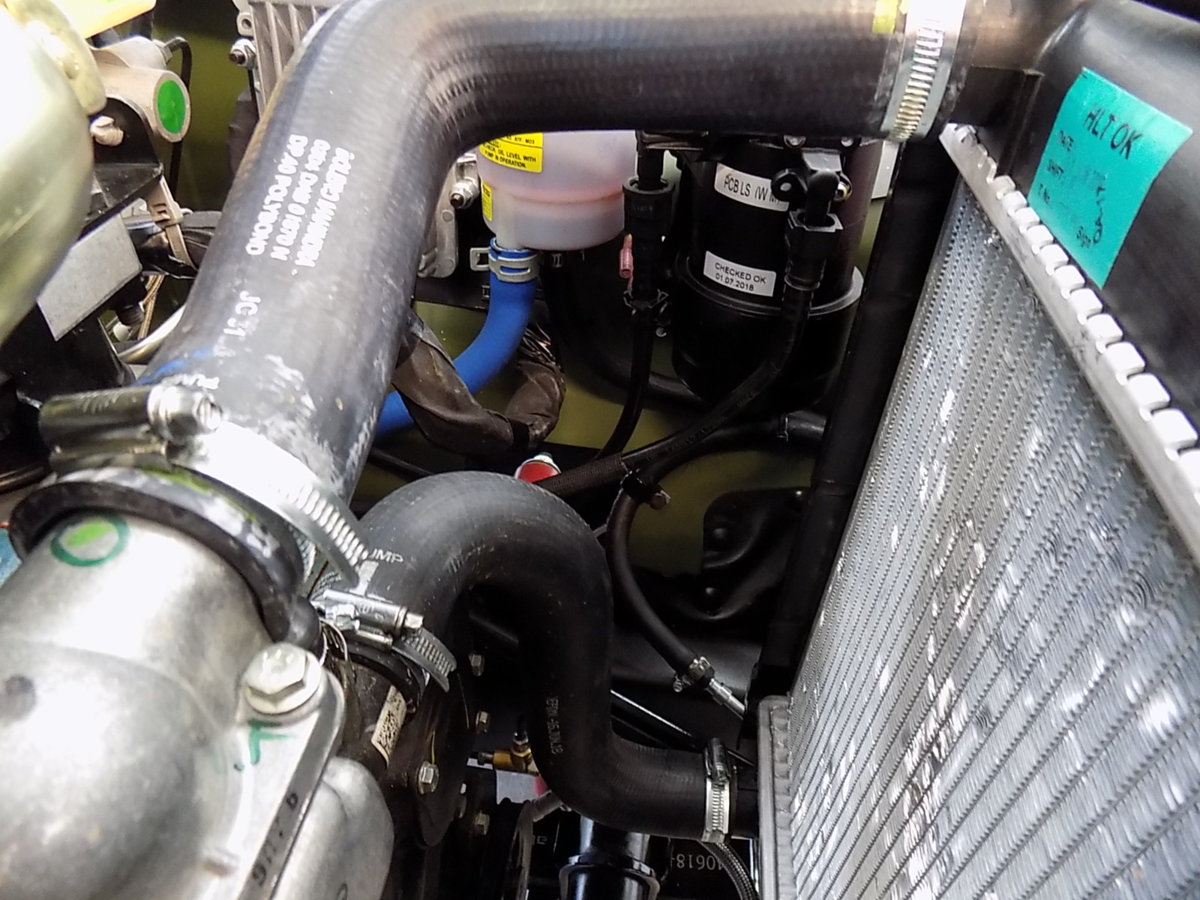

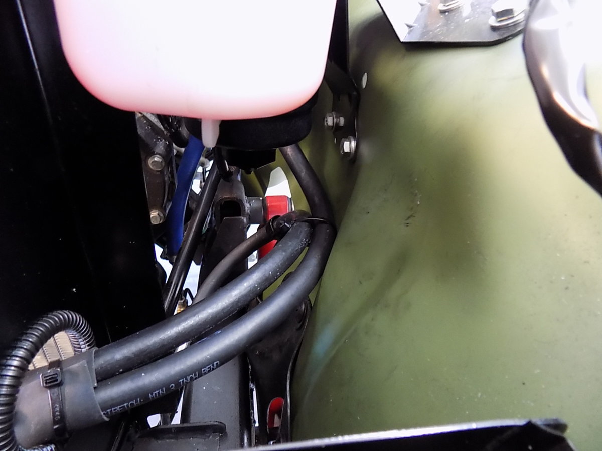

The size is a little overkill but the price was right. Simply tap the low-pressure return line and route it to the cooler location and the second line back to the reservoir. There is a piece of plastic material between the cooler and radiator mount. The grille only takes about ten minutes to remove.
