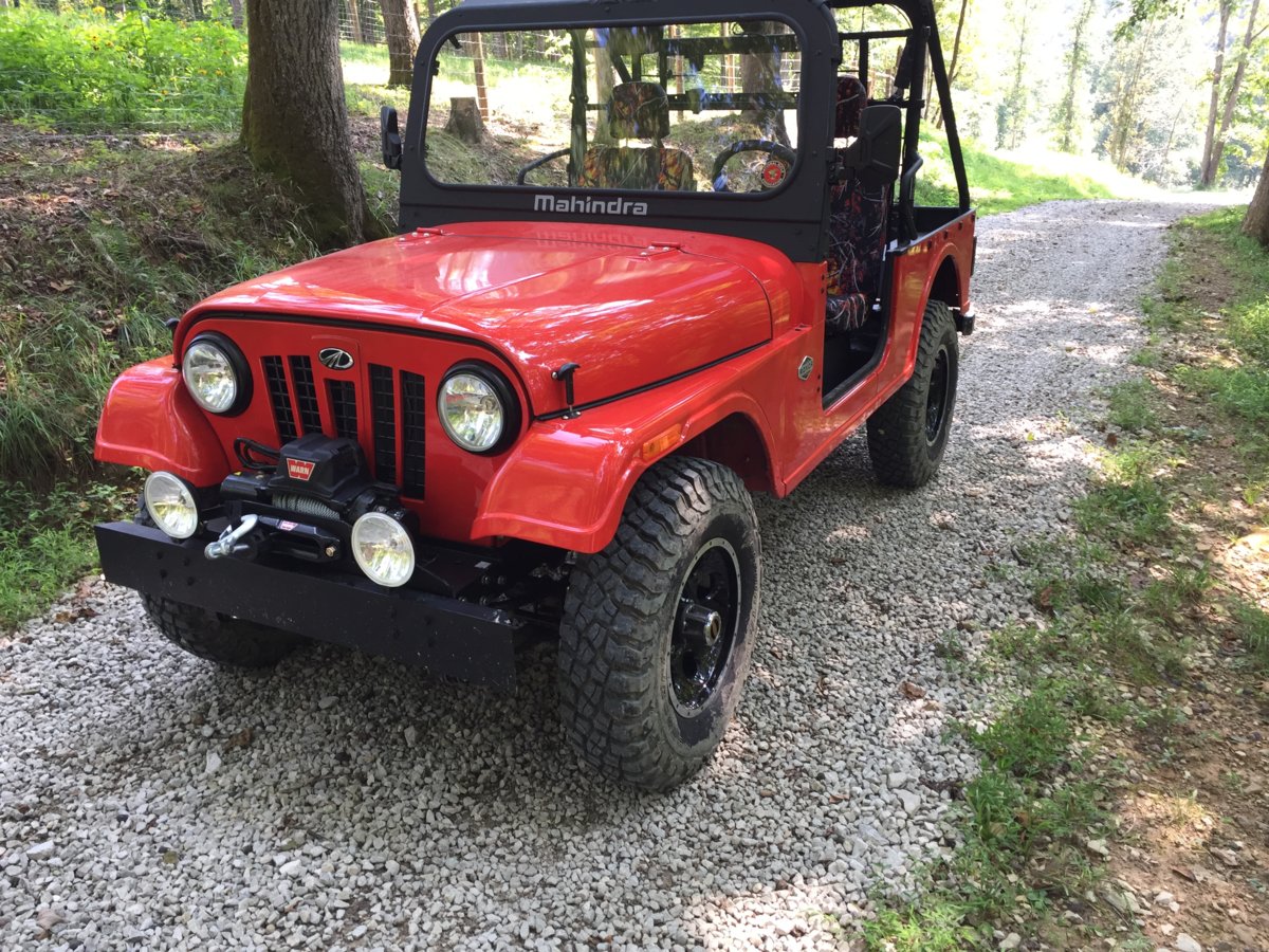

On Rocky, First I had a 42 Inch Stubby Bumper Fabricated from 5 Inch C-Channel.
I next added Cecco Racing's Front Shackle Mounts, which come with 8 new Bumper Bolts.
The Bow Shackle's were 7/8" from Harbor Freight. The same ones I used on the Cecco Farm Bumper on the rear.
Next up was a Roxor Winch Plate from Diesel Freak. I believe it is a Rough Country.
For a Winch I purchased a ZXR 12,000 pound Bad Lands Winch from Harbor Freight on sale. It comes with all the required Wiring, Bolts, and the Cut off Switch. I need to come up with a Tupper Ware (Water Proof) Box to store the Control Switch in.
ROLLER FAIRLEAD and the WINCH PLATE
I did end up having the front VERTICAL PIECE of the winch plate cut off (Roller Fairlead Mount) with a Plasma Cutter, and welded back onto the front of the Heavy Duty Bumper, so that the Roller Fairlead could be mounted. The roller fairlead has to be in front of the Bumper, as it sticks down past the top of the bumper. At this time I am not sure if this was a design problem with the winch plate, or an Installation problem with me not getting the plate installed forward far enough for the Roller Fairlead to hang over the Front of the Bumper. Note: The Steering Box Hole leads me to believe this might be a Winch Plate design problem. Re-locating the Fairlead Mount to the front of the Bumper worked out fine for me.
If doing this over I would "LOOK AT ADDING" a 1/4" or Thicker Spacer Plate on top of the frame horn's to bring the frame horn mounting surface up even with, or above the top of the Heavy Duty Bumper. Then the Winch Plate could be mounted forward far enough to mount the Roller Fairlead as it came. A FLY in this plan might be the Hole for the Steering Box in the Winch Plate, unless the spacer added clearance for it. Another issue might be the Bolt Holes to mount the Winch Plate. This would need to be re-evaluated with all new un-altered parts to see what would work.
NOTE: I ended up having a 19mm Box End Wrench cut in half, and another box end wrench had the ends cut off to add in the middle of the 19mm Box End Wrench to make it longer to reach up into the inside of the frame horn to hold the Nuts with Shoulders while installing the Winch Plate Bolts. I also had them heat the Box End of the wrench and take most of the angle out of it to better hold the Nuts.
I also added Harbor Freight Hooks to the top of the Frame Horns which also had nuts on the inside of the Frame Horns that needed held.
The end product I am totally happy with, it just took a little fabricating.
