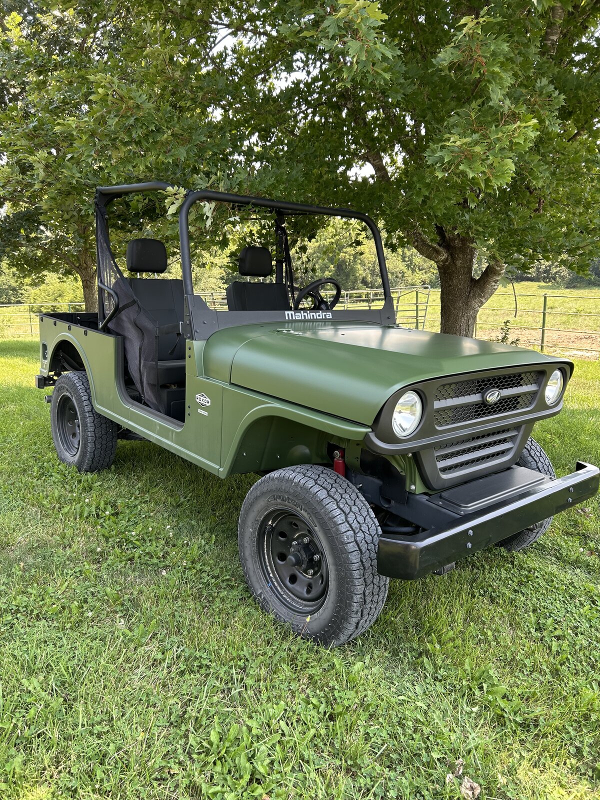

New Roxor owner here, I got this 2024 Saturday. I’ve ordered a windshield/top from 3 Star. Fabricating a rear receiver hitch this week.

I’m planning on putting 235/85/16 tires on and side facing seats of some kind, post some pics of your seats!

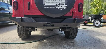

I ordered an EAG rear TJ bumper and made an adaptor plate to mount it. I picked up 16 threaded holes from the rear frame on to a U angle iron 3/16. Then I welded two 1/4" thick plates to bolt the EAG bumper to. I didn't want to spend a whole day fabricating a bumper, mainly because if I did it, it would look like axx. It took me longer to drill 16 holes in the angle iron than it did for the rest of the project. I think I have posted a pic of it here, somewhere.

That’s a good looking bumper! Mine will be a little simpler, I’ll post a pic when it’s finished!

Read the posts here about the problems using a receiver that doesn't extend out to the outer frame. The smaller mounts have bent frames.
I saw that as well. I actually though about picking up a few holes on the frame itself. Others have done this by dropping the tank to modify their frame.
If I need that kind of pulling power, I have other tools. Just 16 bolts will do for me.

Nice Canvas Ted!
