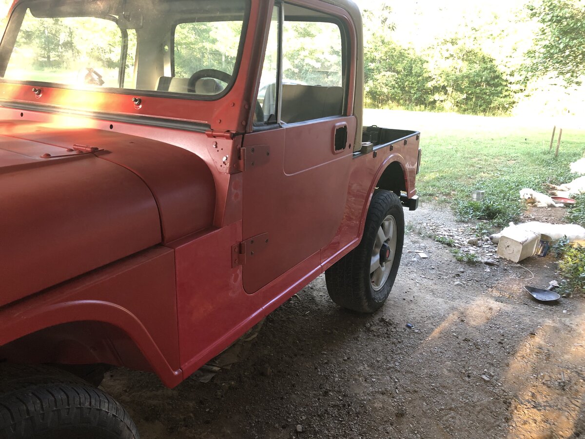

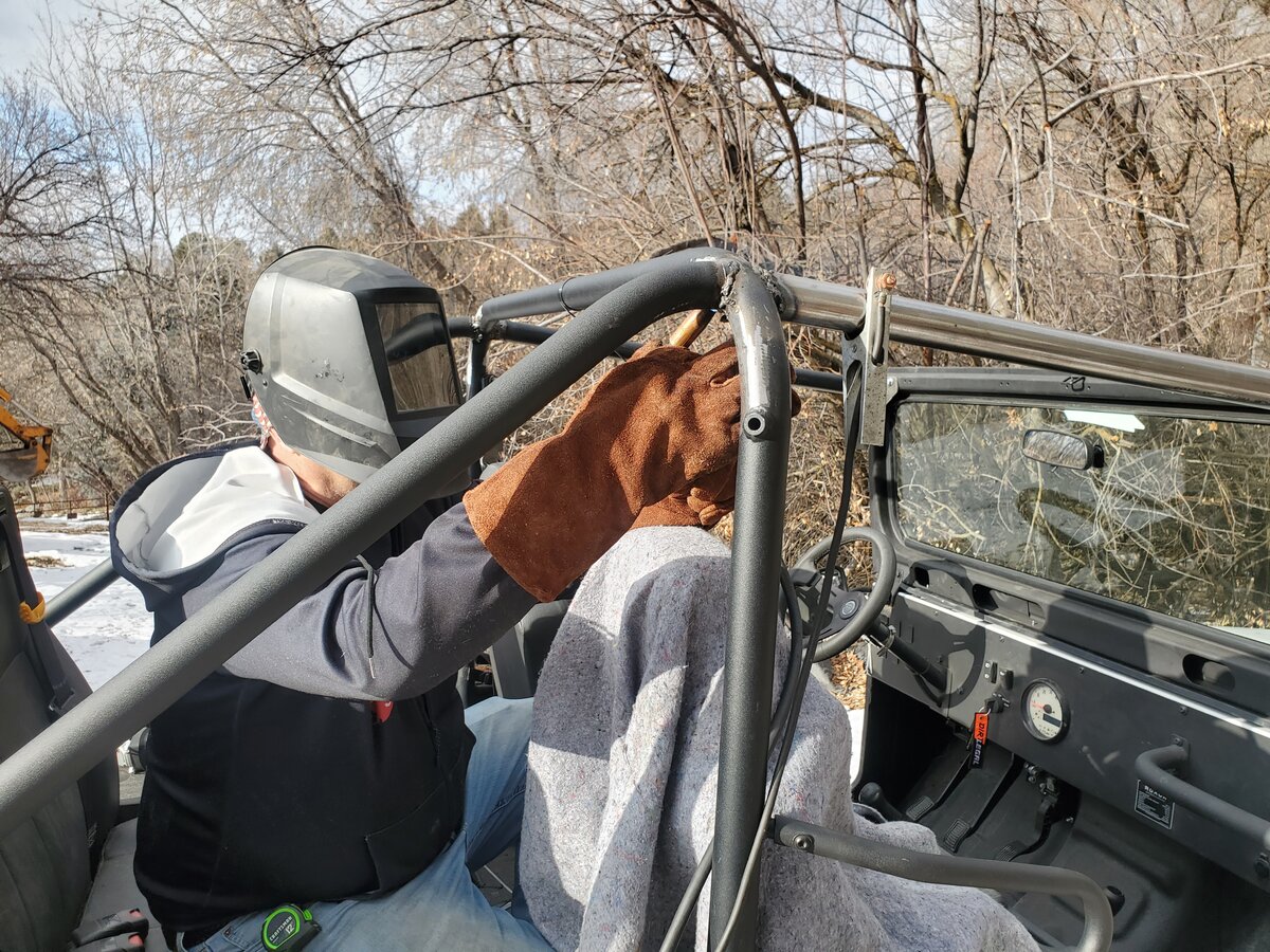

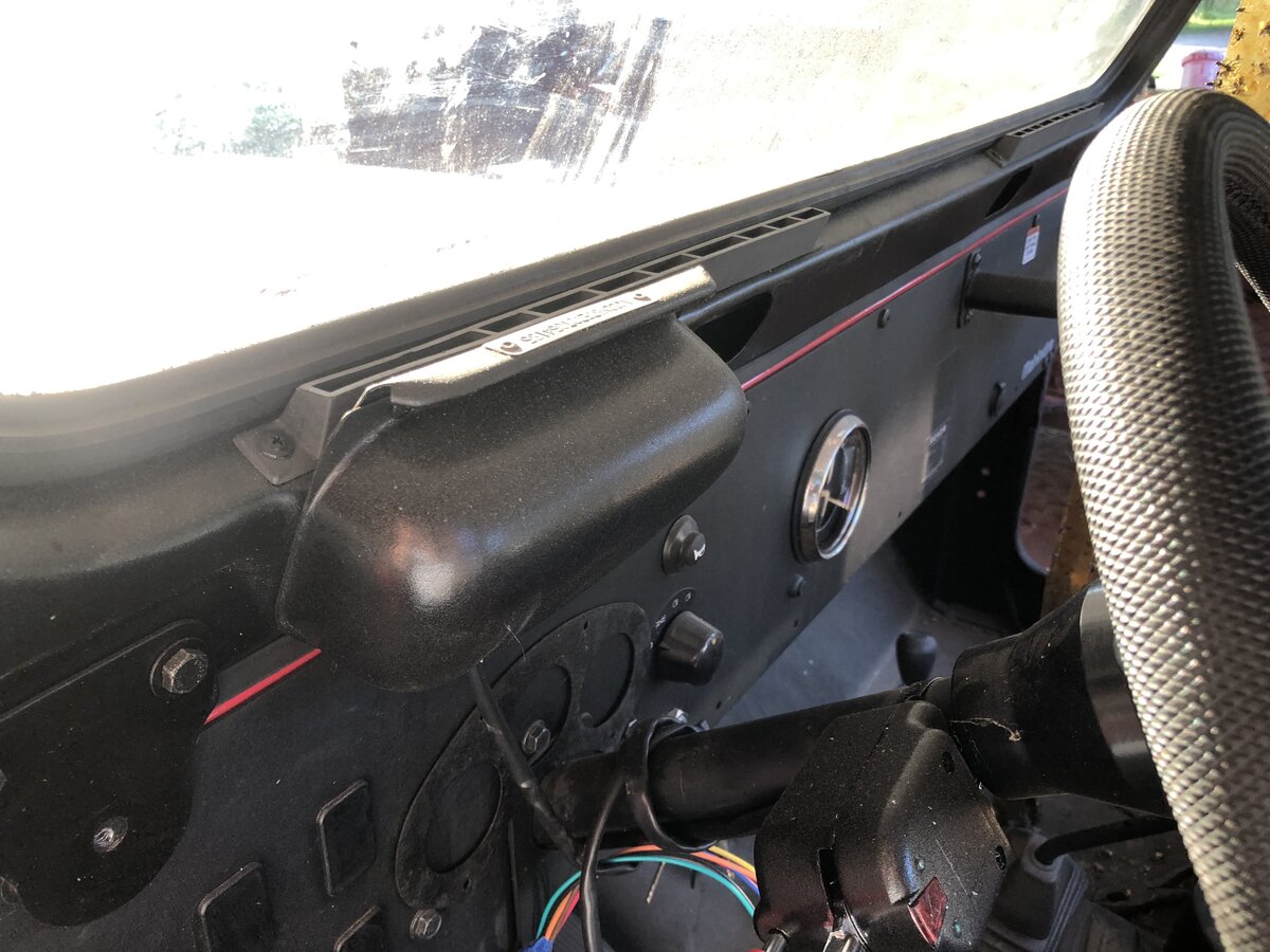

I bought my windshield Frame for $80 remanufactured. It came primer gray. Glass was about 100. Installed myself. Hinges got off Amazon for under 100. Slight mods to get holes to line up but nothing major. Re welded roll cage to bolt upto the frame. I did the RC level kit that comes with extended shackles.

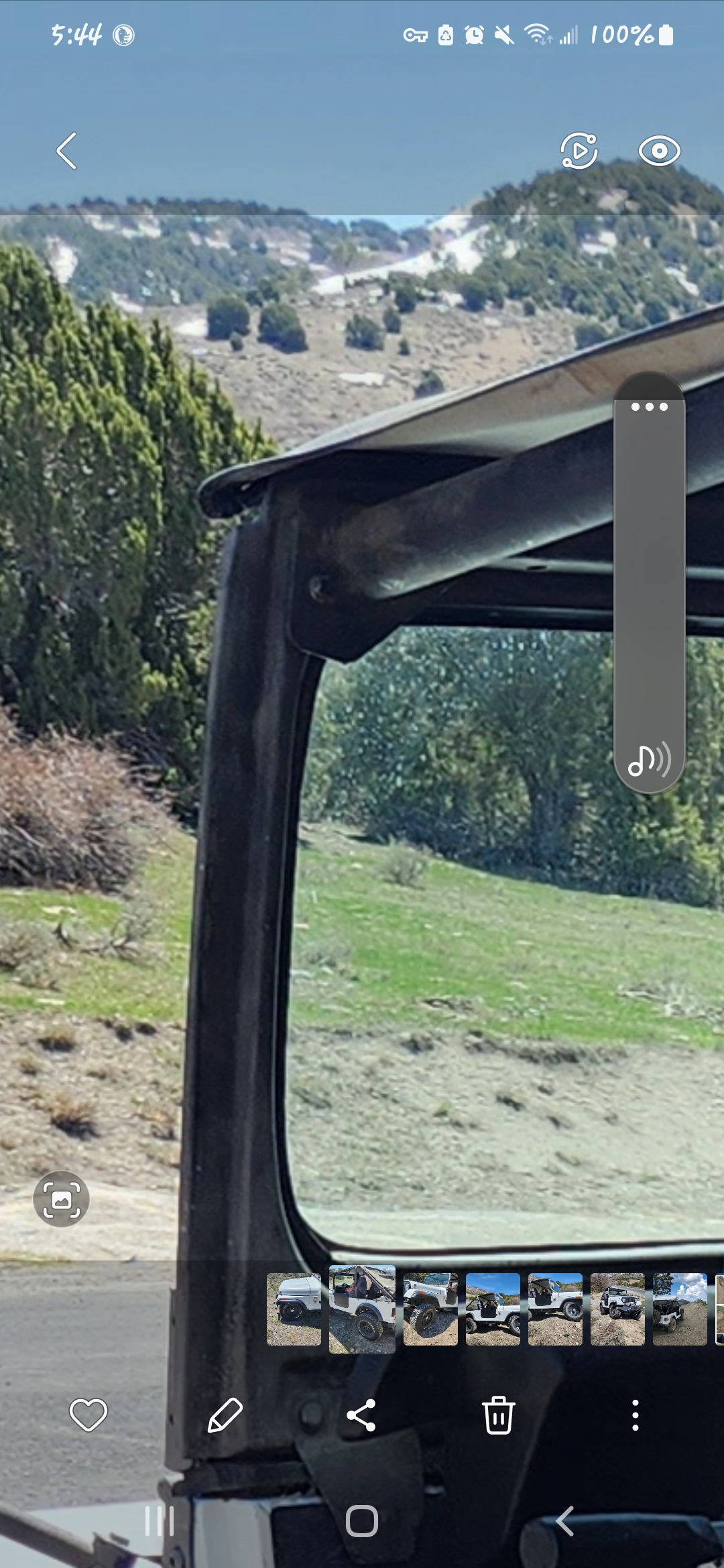

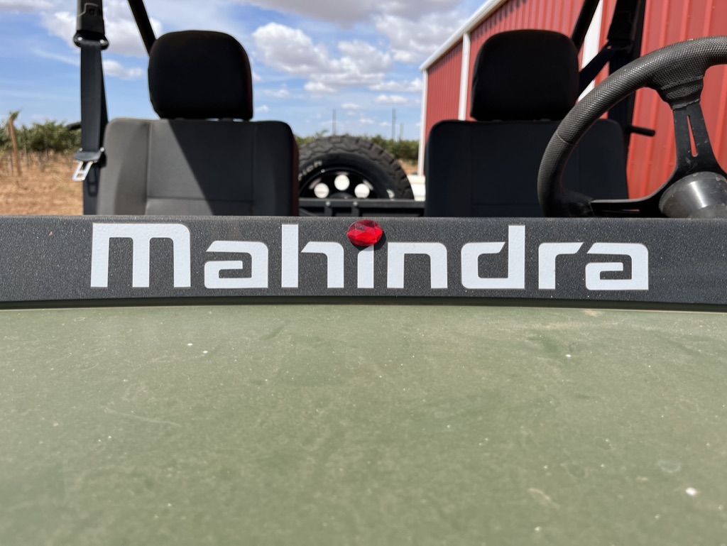

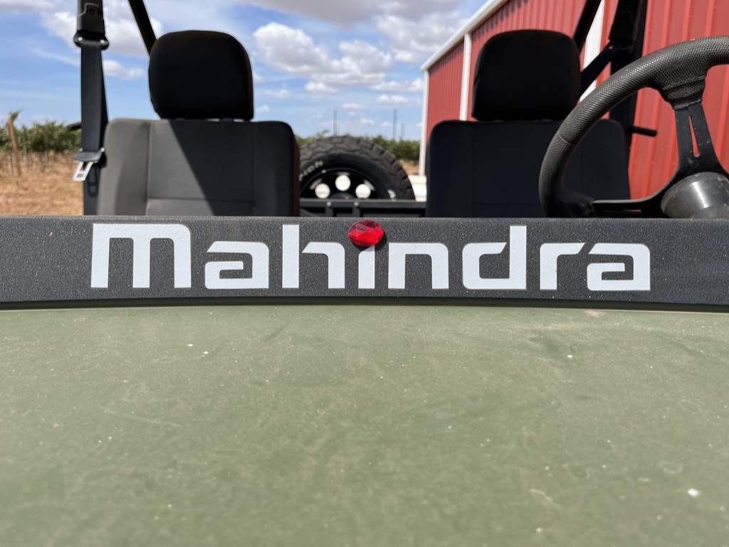

My first mod...recognizing the origin of our Roxors I hope in a humorous way, no disrespect intended for folks from India but kicking sand in the eyes of Jeepsters.
822
My first mod...recognizing the origin of our Roxors I hope in a humorous way, no disrespect intended for folks from India but kicking sand in the eyes of Jeepsters.View attachment 12687
So inorder to add the CJ windshield that little mod will be removed to add the windshield. I had to zoom in

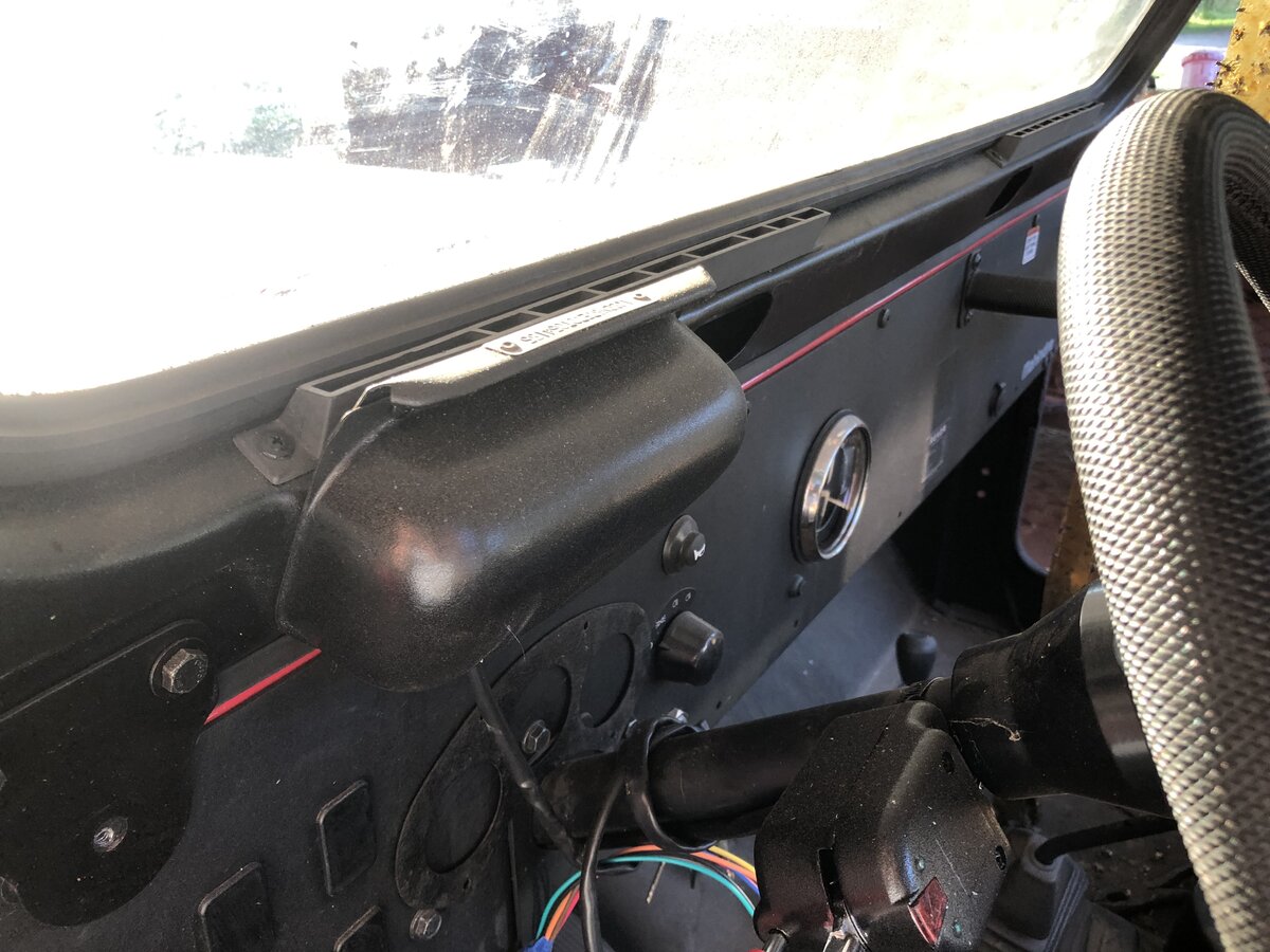

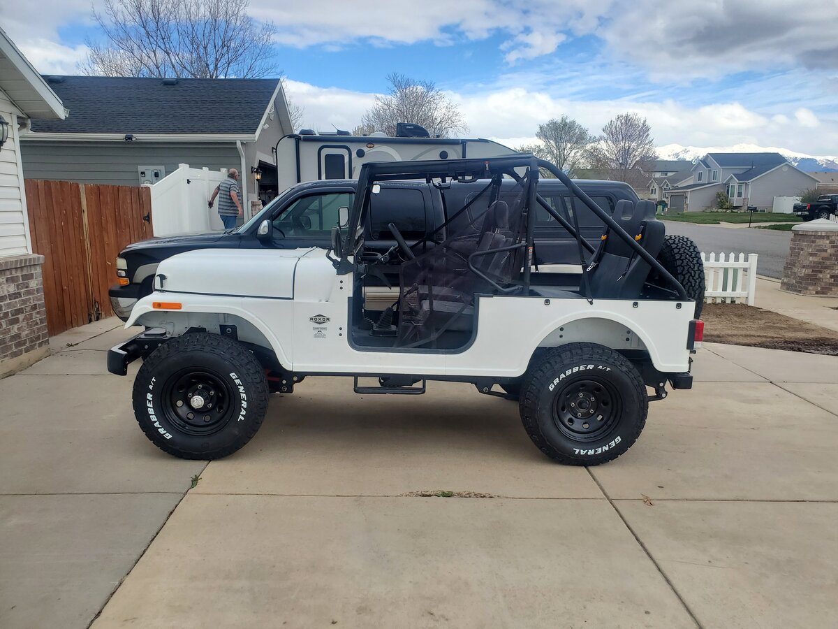

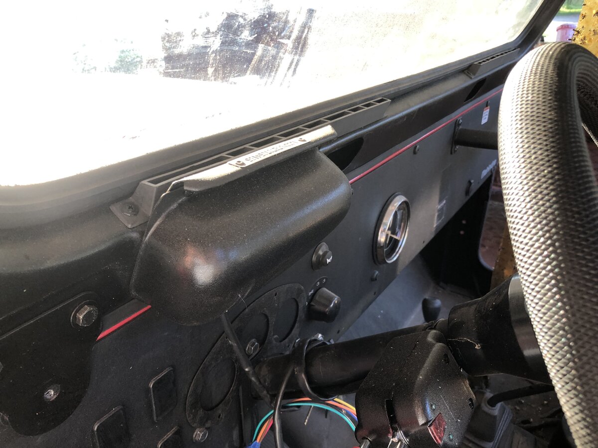

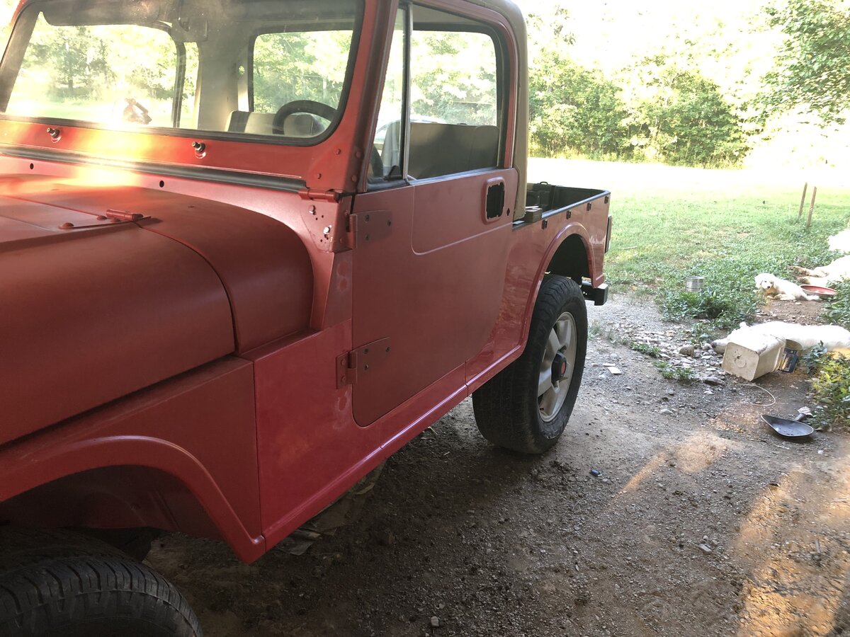

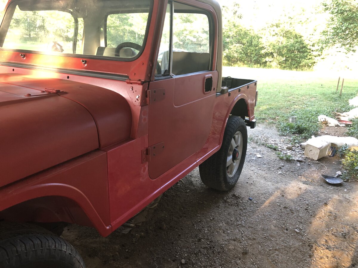

I think the cj windshield is the best thing. They are not flimsy or thin like the aftermarket stuff. Also they have the wiper system contained in the frame. Also have the defrost vents in the frame ( if you have a heater). Also jeep doors and half-doors will mate right up. To me, and again it’s just my opinion, jeep stuff has a cleaner look and is more functional than the aftermarket stuff. although the “thar” stuff fits and looks ok, it is much more expensive than the jeep route
8B51FD19-3C4B-43CC-B384-6E1166CFE378.jpeg 2532813F-C11A-418C-97CA-EC5A012F2AC7.jpeg
822
View attachment 12689 View attachment 12690
Also cheaper to get parts. When I got my 2020 I knew before I took ownership that I would be going the CJ route. Installed the bikini top channel on windshield. Bikini top only $70. Roxor assesories are pricey
