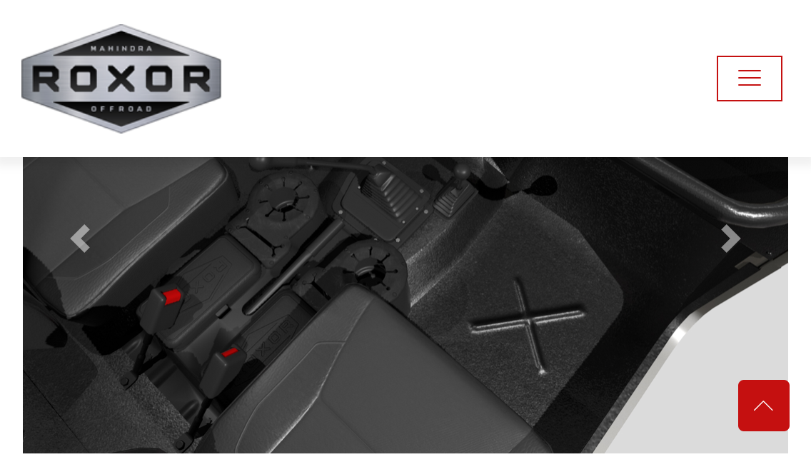

If anyone doesn’t know they have released an upgraded center console for the manual transmission version.

It's in a dealer release, it's hasn't been released to the public yet or added to the accessory page yet. I'm sure it will soon.
It has been on and off on the accessories page under interior. Not sure why they keep taking it off then putting it back on.

Where are you seeing that? I couldn't find it under the Roxor Offroad accessories page Accessories | ROXOR Off Road|ROXOR Offroad, and I'm sure it's cheap enough to tempt most of us early owners to buy one.
It was under interior in the accessory page, I have noticed they have put it on and taken it off a few times in the last few days. For what it is I don’t think it’s to cheap $151 but maybe they’ll give the early owners a trade-in allowance on our old worthless ones, lol.
Probably working out the kinks. I've seen that happen before. It's back up now I see.

I was sitting in an A/T at the dealer and really like this console. I was bummed when my manual was delivered and it didn't have it. I will be ordering this factory one as it's available.
