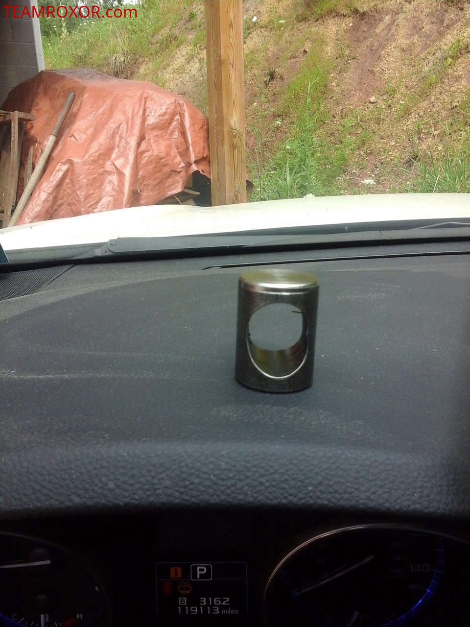

When you take it back to them, show this picture and explain that it is Installed in the spartan rear locker on step 23 and 24 but is not in the directions correctly as it also shows one for the front locker which is not required only the rear

When take it back to then, show this picture and explain that it is Installed in the spartan rear locker on step 23 and 24 but is not in the directions correctly as it also shows one for the front locker which is not required only the rear

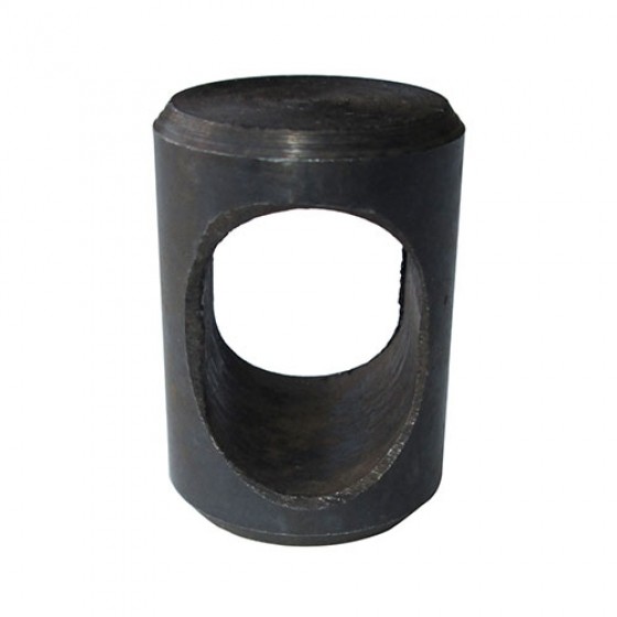

If they do not have the spacer anymore i.e. threw it away with your spider gears you can order one from Kaiser Willys website for $13
Is there a part number or anything for that spacer? My brother just bought a roxor from the bank and we think it's missing the spacer. Thanks
