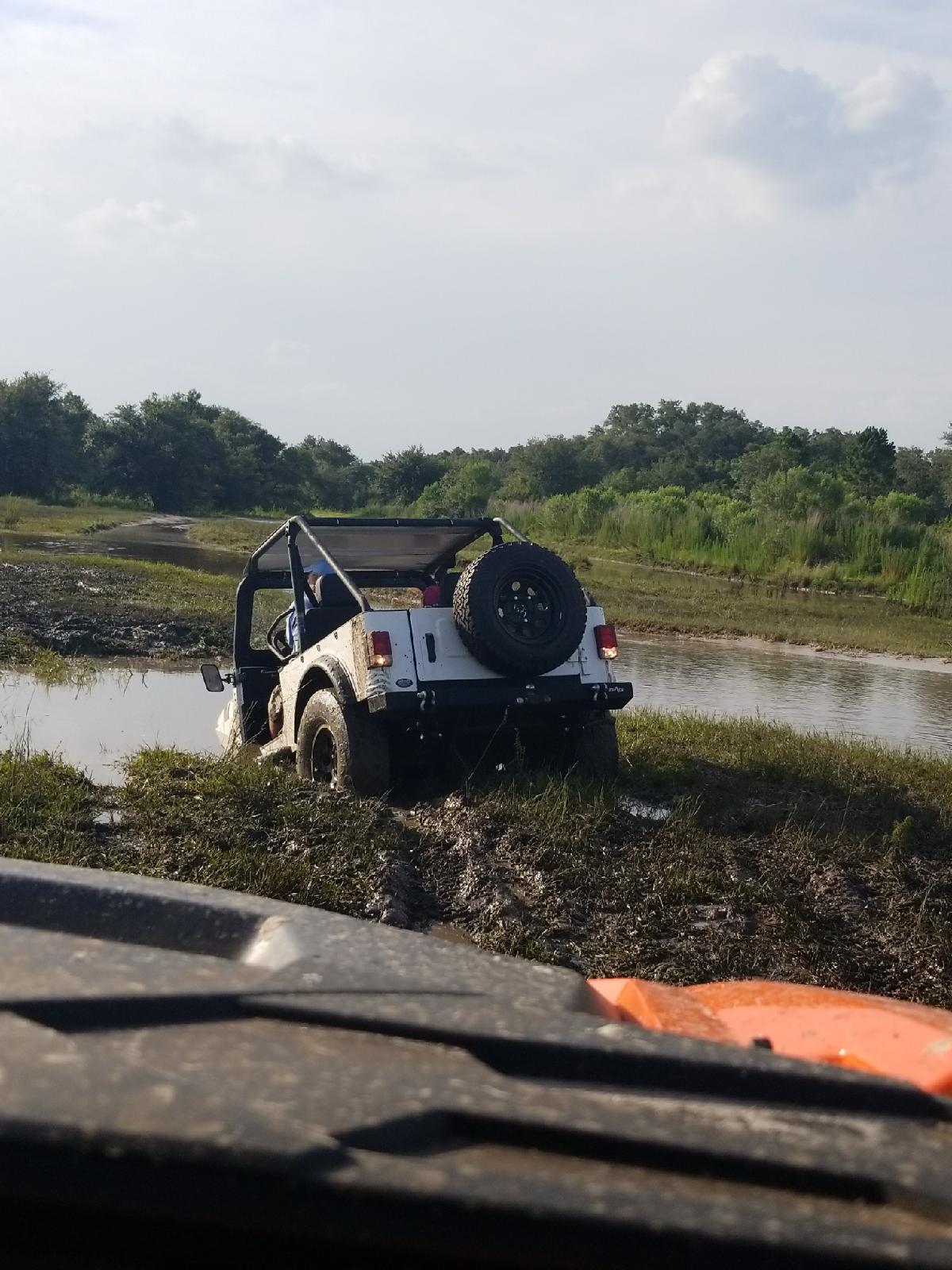

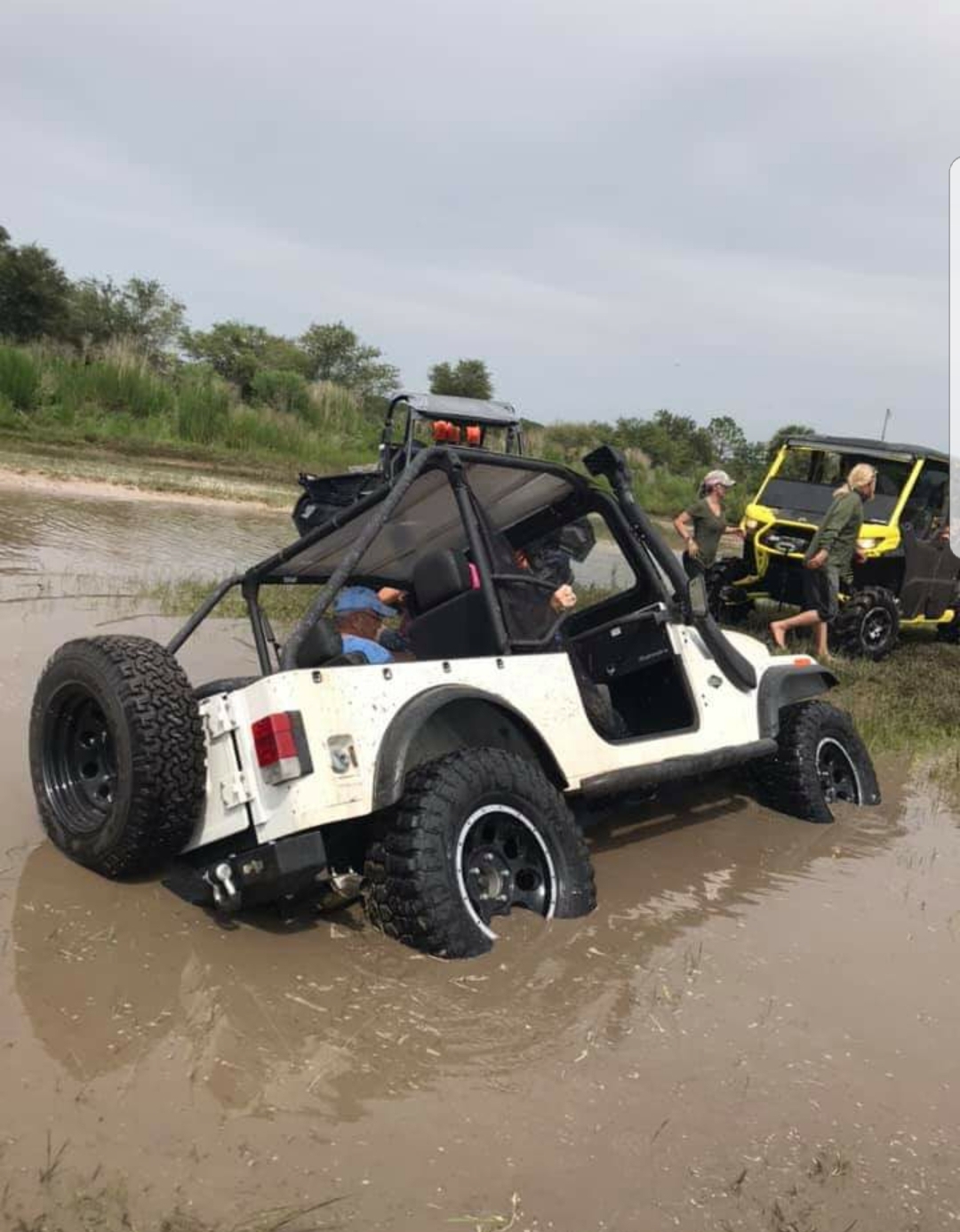

Installed the snorkel and just in time heard there was rain & found the right side of old Bomb hole, and I swear I found the entire hole on way back entire front in hole thanks snorkel

(Amazon) Spec-D tuning SNK-WRGN Spec-D Air Snorkel System & Has a EAN # 0841808136702
You have to drill 3 1/2" hole about 4" below battery tray, this comes with paper template for holes but unidrill and large washer for 2 bolts to hold snorkel on to fender, I cut the stock intake about the same size as Hose that comes with snorkel added black duct tape around the plastic as seal for oval stock intake & clamped it down, haven't had a chance to find actual 90 degree for intake hose yet,
