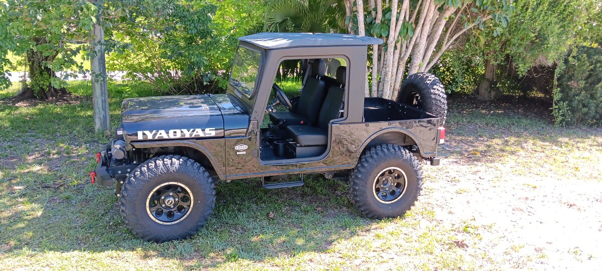

Ckreklau,
I have a 2022 with the 2.5L and 5.38. I wanted to get out cheap, so I put the 1.5-inch shackle lift, 2-inch wheel spacers, and 35x10x16 Pro Crawler tires. I also put 3-inch extension (spacers) between the front bumper and the frame. I run @ 2400 rpm at 55-60 mph.

Hey CK,
I agree with txroadkill, (nice name by the way). anyway, like I said in my previous post, I went with taller tires with no equipment tear down. I do believe the total cost was around $2000.00. I paid $1500.00 for 5 tires, an extra rim, bumper spacers (called steel blocks), 2-inch wheel spacers, and the shackle lift kit.
If I do weird angles like diagonally through a deep ditch my tires will scrub the rear fender well lips. I just need a higher lift.

The 35 x 10 x 16 Pro Crawler tires.
