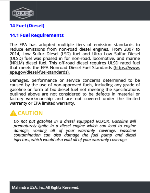

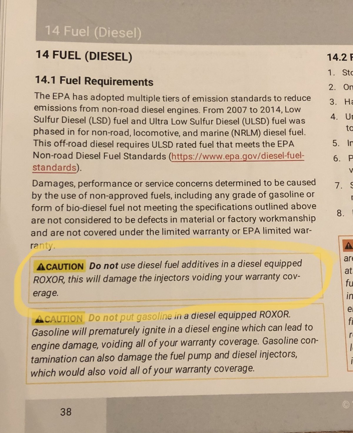

Just FYI. From the manual.

Very interesting jeepish....thank you ..
I may not understand their reasoning...but I certainly understand their instruction !
I’d like a little elaboration also. I’ve always used additives in my diesel trucks. But when I got the Roxor I stumbled across that while looking through the manual. Just thought it was worth noting on this thread.

Very strange? It's a Bosch common-rail fuel system. Why would a quality additive harm a thing?
