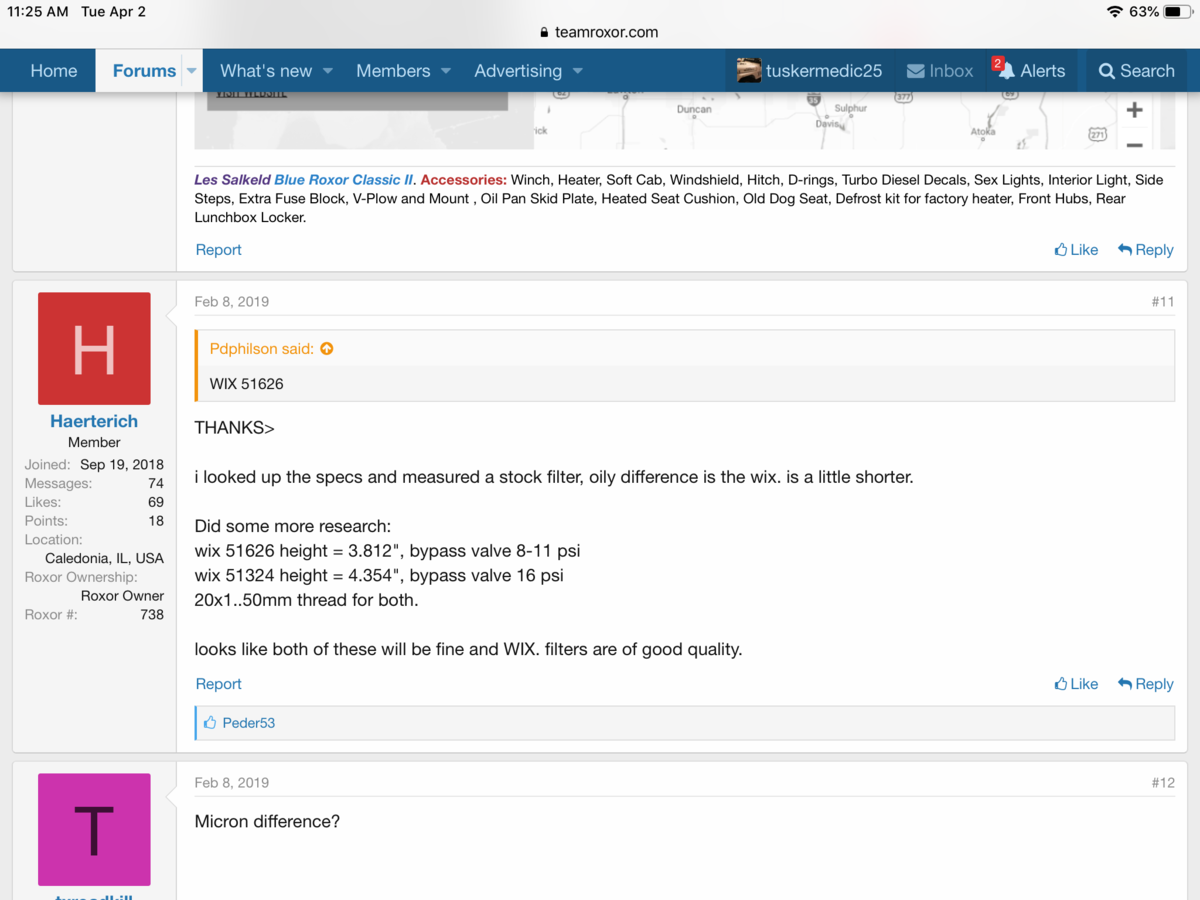

Would you guys happen to have a crossover number of the oil filter to perhaps a napa, fram, or baldwin brand filter?
tuskermedic25
Nov 3, 2018
148
Port St. Lucie, FL, USA
0703
WIX 51626 looks like has had some success.
Thanks tuskermedic25! So many little things to learn about on these and the parts stores are no help yet. Ill post up some crosover numbers for other filter brands once i hit up the parts store for filters. I personally like baldwin filters for their quality and they arnt that much more than other brands.
