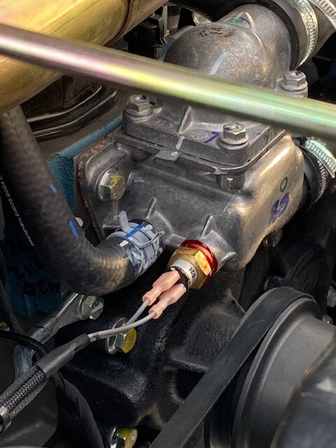

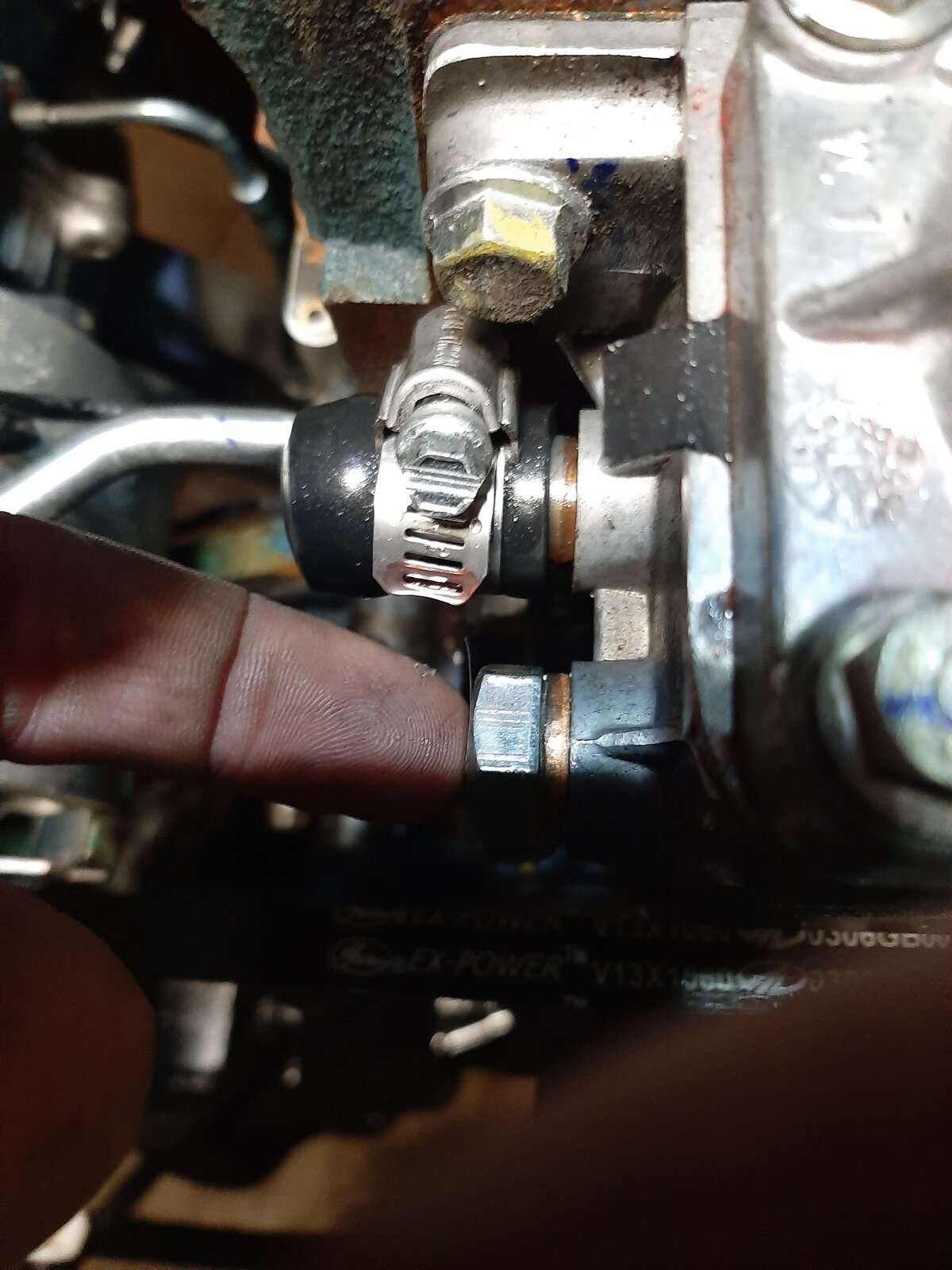

That plug I'm touching in the picture is actually in the thermostat housing, I thought it was the water pump or something. Doesn't look like a thermostat housing to me, not does it look like a water pump...
Anyway, Wade at diesel freak uses that plug for the thermoswitch, and in a way I can't yet comprehend screws the shroud into what appears to be the radiator...
Wade is working on an install vendor. Their manufacturer didn't give instructions either. If he gives me permission I'll share his photos.

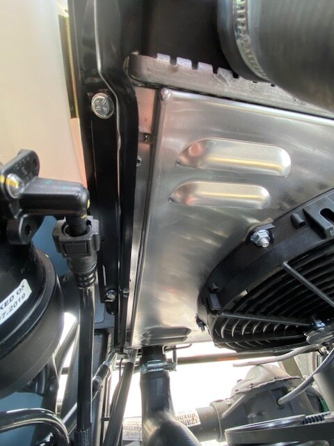

He did state that they pull the radiator to install the shroud.

That may be so, but I don't believe it'll be a huge issue on a diesel. Especially one so small. In theory you could get a switch that activated at a lower temperature for the same effect. Also I'm pretty sure this fan is beyond overkill.

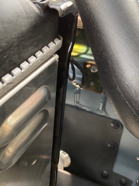

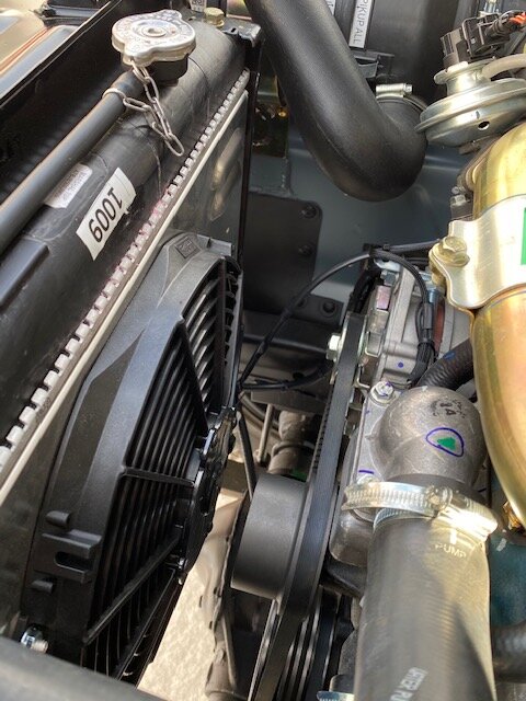

They've been doing it this way for a few years without issue, so I think this is going to be a great solution. Maybe (doubt) I'll find a way to install without pulling the rad. Possibly a pneumatic drill would provide enough clearance? (Super doubt)
Obviously there is enough material on the outside of the rad that you can drill into without spilling any water. This is good information to have. It also looks like they used the two notches on either side of the fan shroud (4 total) for screw placement, so lining it up should be no trouble at all.
