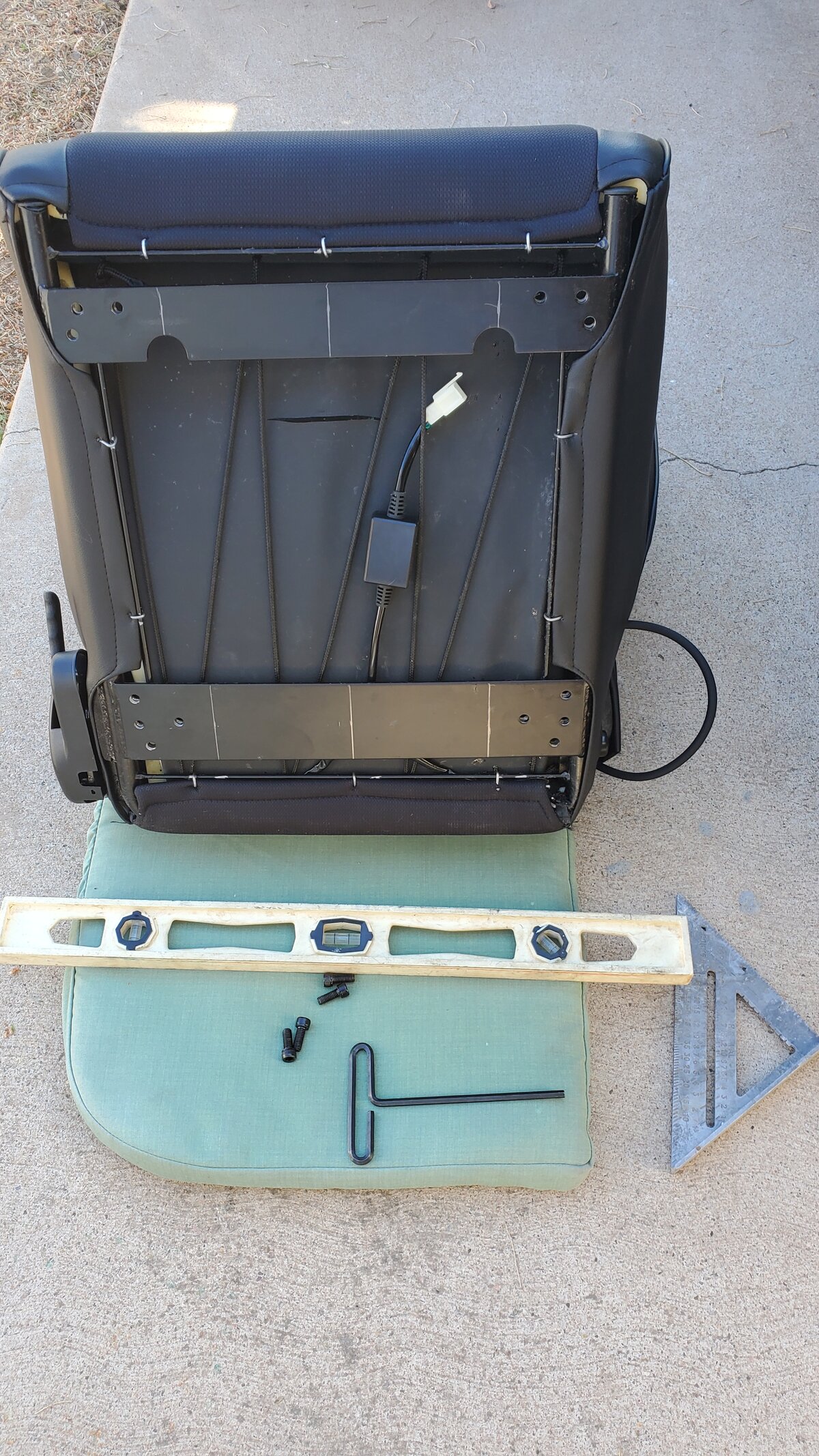

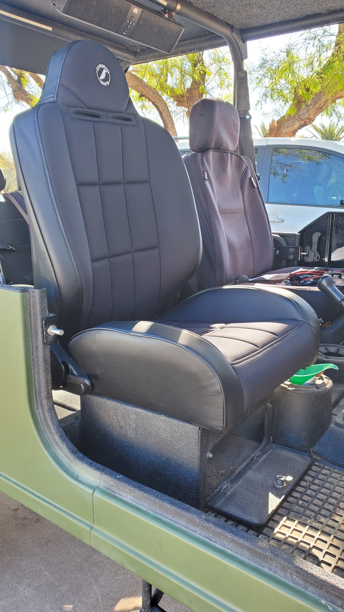

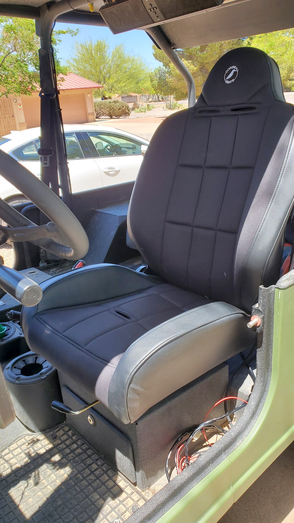

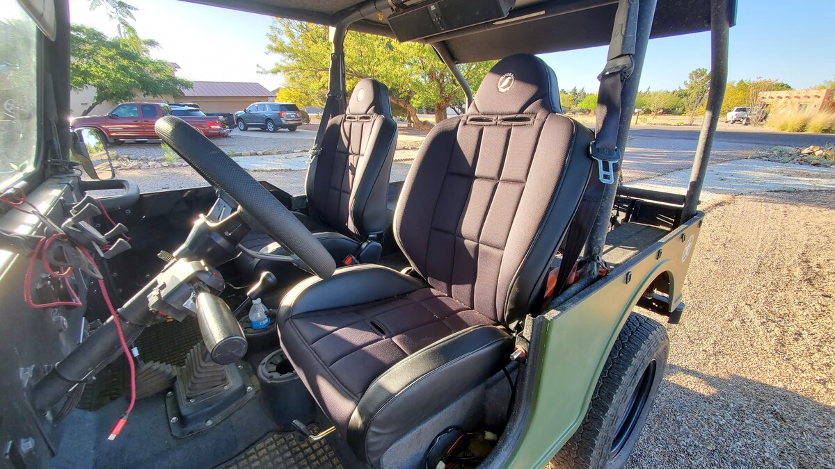

Here are some photos. I just measured from a center point in the seat frames and I did notice my passenger seat sits closer to the door than my driver's seat. So make sure to triple check placement before drilling.

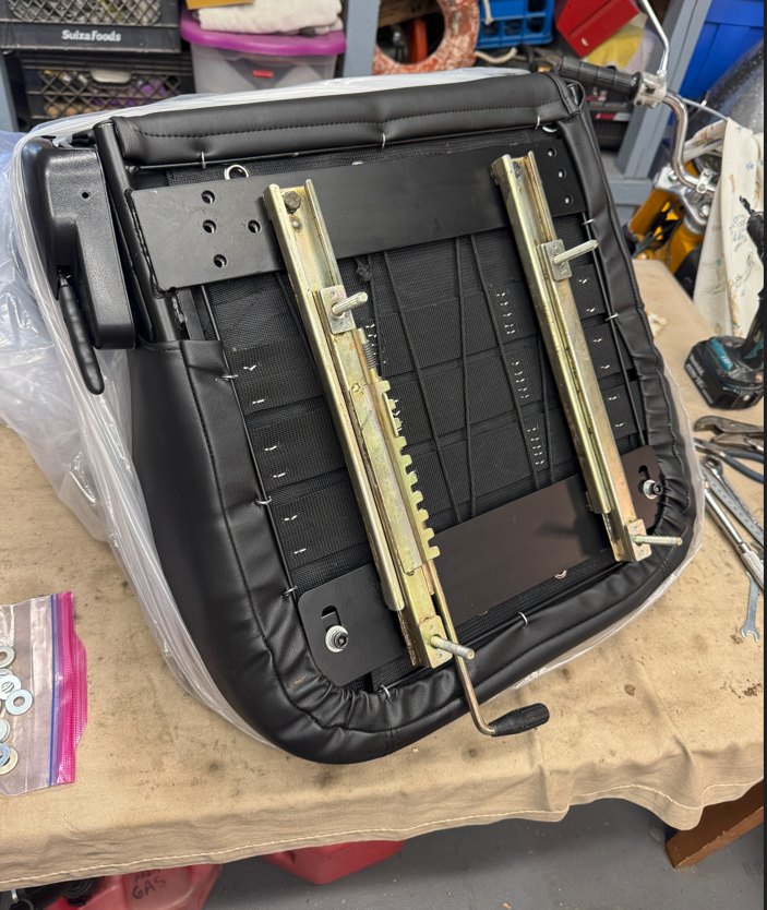

@DesertRox, I know this thread is a couple years old but I'm tackling this exact same job with Corbeau seats. I bought the bracket adapters from Diesel Freaks but the holes were in the wrong place and not threaded. Thinking of just drilling my own holes where I need them but what did you do about threading them in? Did you just place a nut on the backside against the seat foam? Any pointers you may have their is appreciated.
Rolandwanders
46
Phoenix, AZ, USA
1502
I was thinking the same thing because I can't weld on here without burning the seats. And I went and bought the suspension seats which means there is more padding behind the brackets where I need I get the nuts behind. Thanks for confirming!
